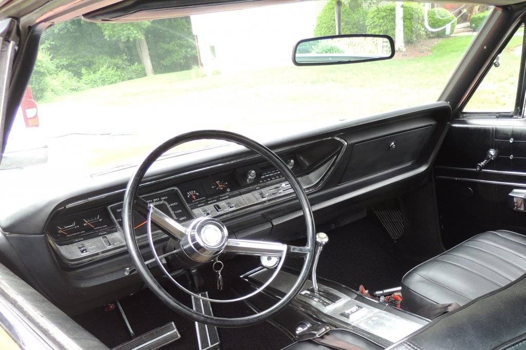

A 65-66 Chrysler has idiot lights for *everything* except gas and ammeter!
I think that was a start of 'dumbing things down' by Chrysler to meet a perceived clientele that didn't care about mechanical stuff.
I see what I have to assume is a voltmeter in the dash and power window switches moved to the console like a 300 F, G etc.
That is absolutely true!
I installed the voltmeter before the Hemi swap - I had 120 amp Honda alternator (fits fine with stock brackets by the way) and took voltmeter internals and put in place of amp gauge. Now I have a 150 amp hemi unit.
For power windows I came up with my own conversion (it used to be manual) and the console seemed like a good place to put switches on.
There is one more mod - Sony head unit built into factory radio. All buttons work but have different functions now. Aux in and USB plugs are in the glove box.
The glove box is made out of aluminum and vinyl lined.
