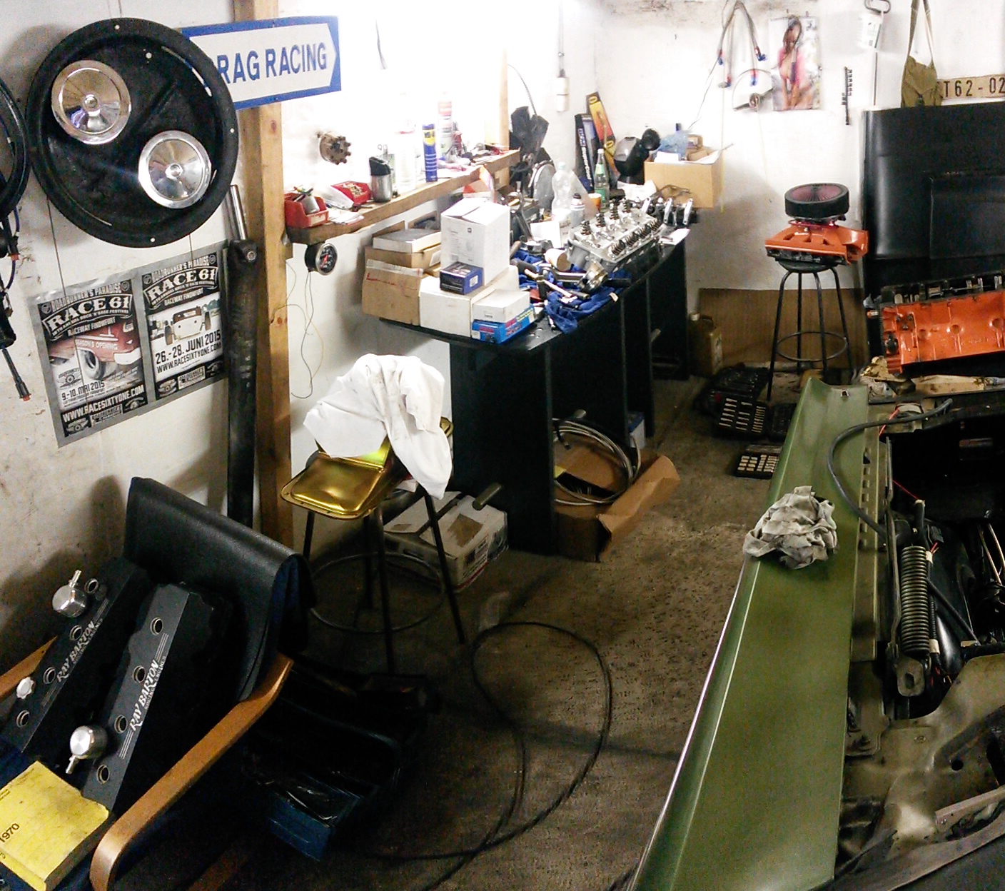

I put some pics below.
I improved my transmisson. Its still a manual reverse pattern, but it was totally refurbished with all A and A racing parts. Hopefully it will handel the horses.

Its not a shop, just a kind of hometown garage :)
nothing serious.

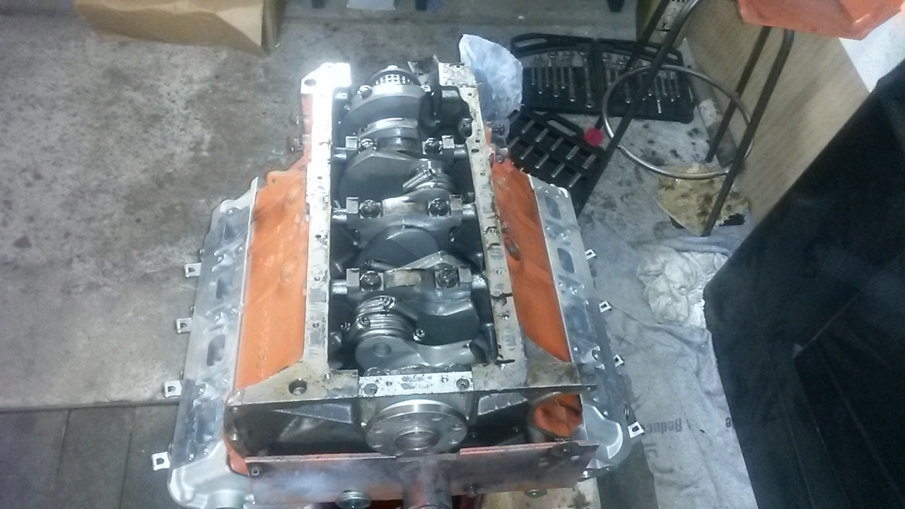

Hi guys,

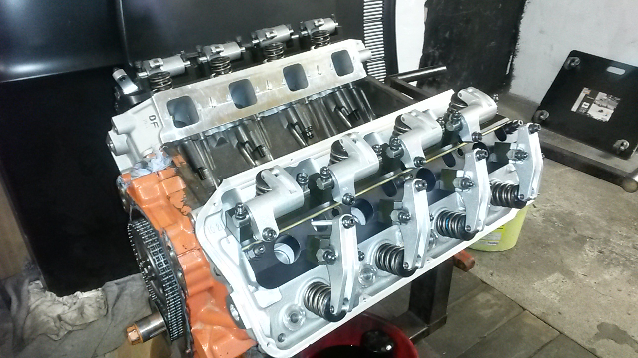

here are some updates. I had to change everything. Now I have all the parts. I am still remachining some things (rocker baseplates..)

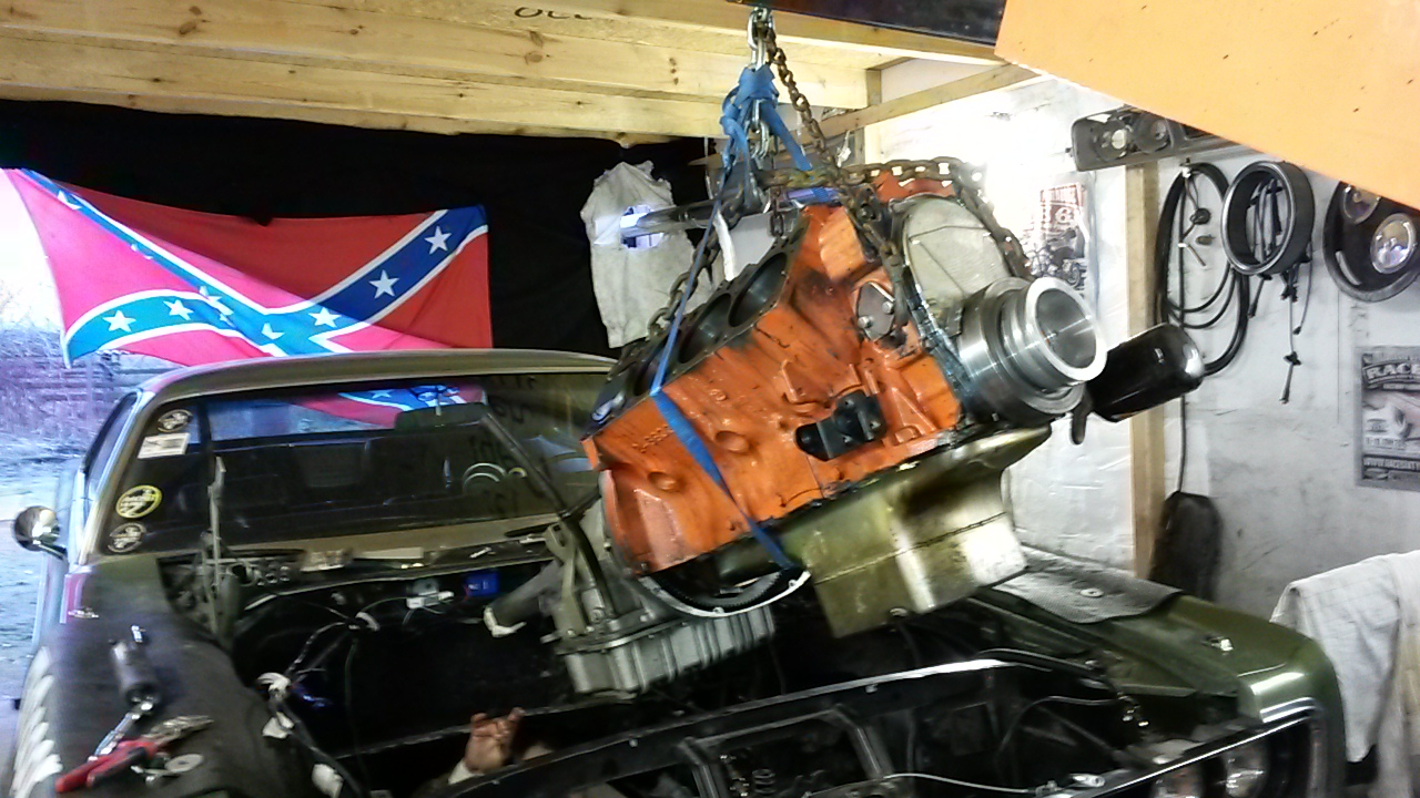

I am now starting to work on the engine. My old pistons didnt fit the new heads/valves. So I unfortunatly had to order new pistons. After that, I decided that the 440 source crank and rods maybe are not good enough for the new performance. So I need to order new and better parts.
So bla bla. It became a Indy Maxx Aluminum hemi block, ray barton did the machining and made a short block out of it. The rest I am doing by myself. But stil have some problems.

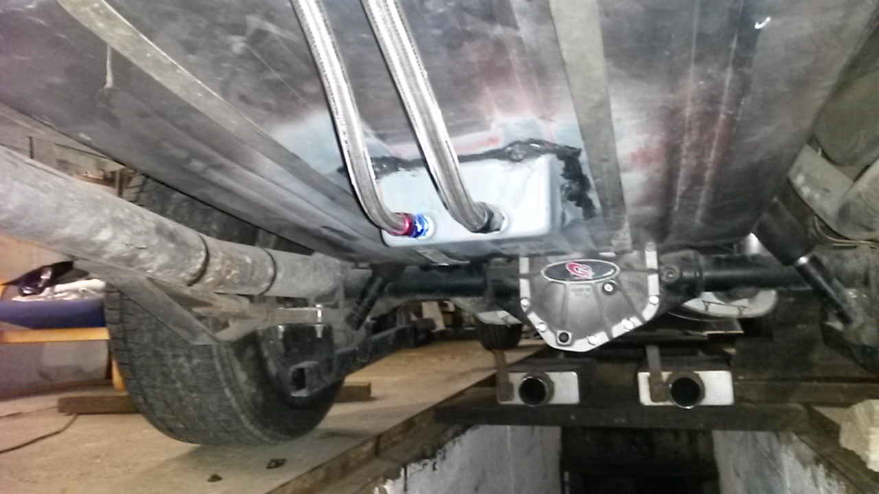

In addition to that, the Polara gets the calvert racing suspension kit, a FFI front swaybar and a painless wiring harness. So thats whats new for now :)

.....Machining the rocker base plates...... Oh my heart goes out to this guy Michael. We just finished and dyno'd a 572 pump gas Hemi, World Products block, Stage V cylinder heads with the Ray Barton rockers. They are pretty and there is a huge amount of work involved in getting them up and running along with the rest of the Hemi. And working out the problems from Germany! I wish you all the best of luck Michael.
