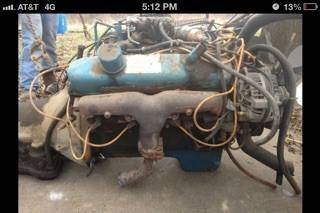

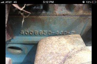

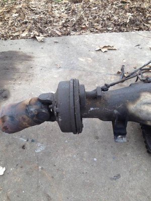

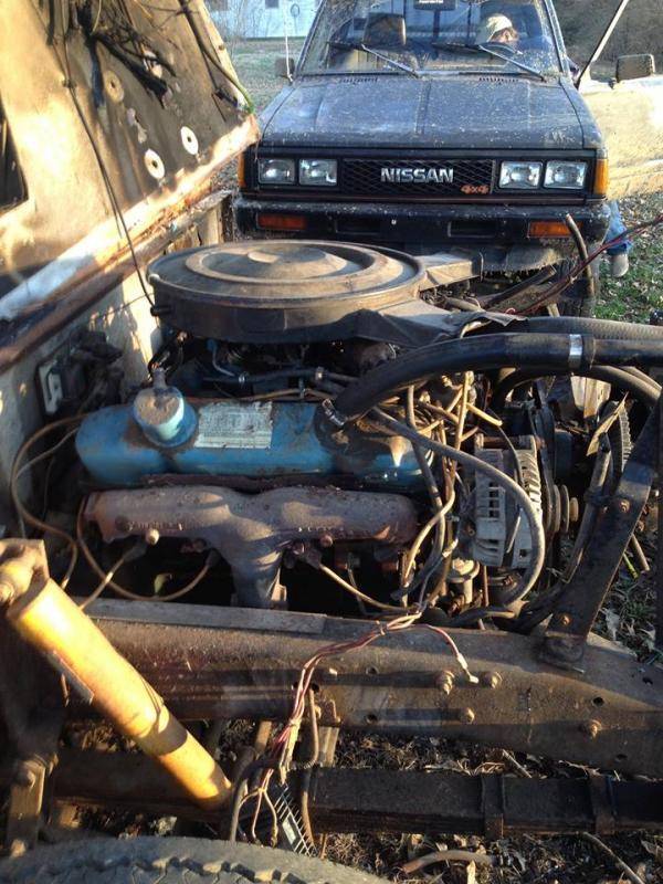

I just messaged him and got these pictures. I havent seen the engine yet so this is the first time Ive seen it as well. definatly dont think the trans will work especialy with the trans brake lol.
my question now is what all do i need to mount this engine with a 727 and would a k member swap help more then drill and tapping the bosses to mount conversion bracket. ive seen kits that would work if the car started out with a B/RB but none about swapping from a poly to a 440. I just need to know if this is gonna be more then what its worth.
