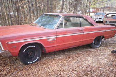

dose anyone know these tire sizes and if they will fit a 4 door 4735363973_c3e982f44e_z.jpgfgvxfgnf.jpg
