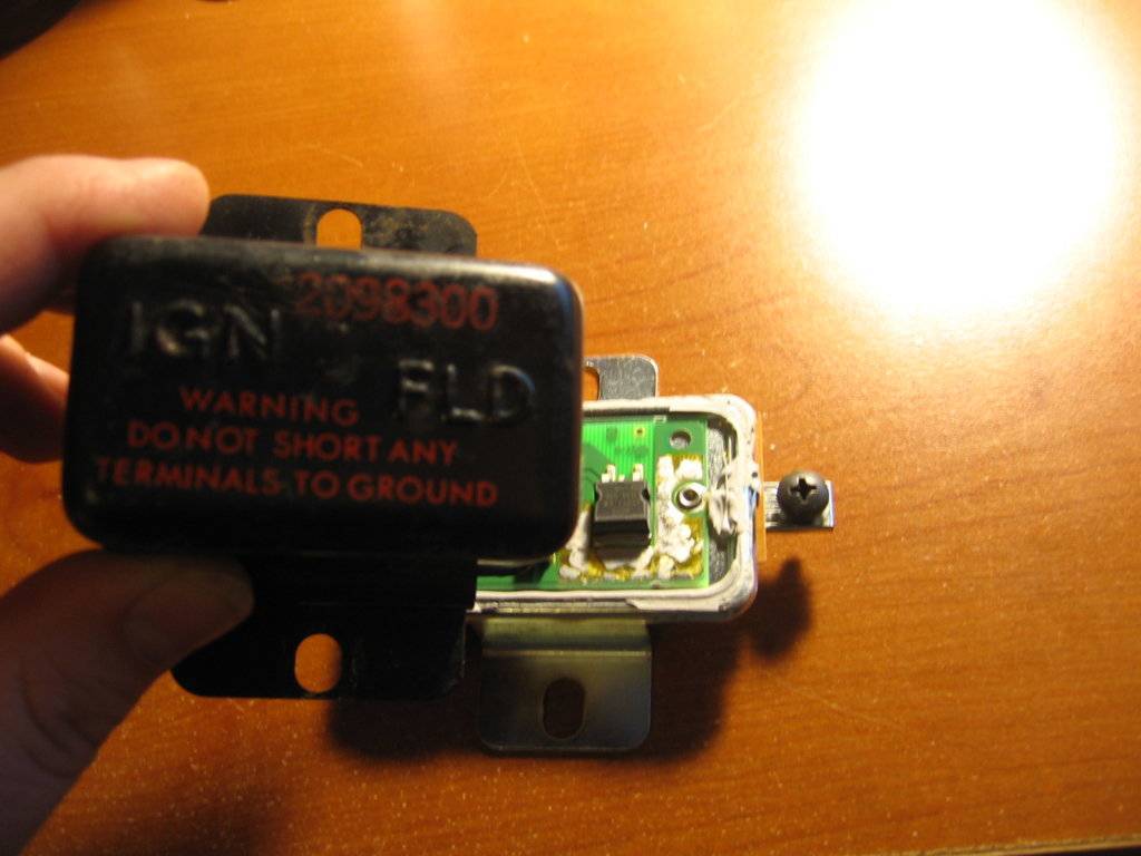

I like my Powermaster 7018 well enough and consider it a fair buy. Mind you, I'm running a single field wire to it, so it still doesn't kick out the 95 amp current until the motor revs over ~750 rpm. You might bump your idle up a little to keep all your load WELL charged, even should you resort to the dual field wire electronic regulator. (Note: I use an electronic regulator in place of the old thermo-electric regulator, from Mr. FuryGT. He sells a good product. I'm considering whether or not to go to a dual field setup for the same issue plaguing you.)
