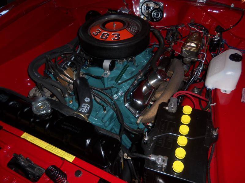

Don't get me wrong- the Monaco won't have aftermarket junk- valve covers, chrome air cleaner, flex fans, racing seats, hood scoops, etc.- heck no! Here's a pic of my 68 Cuda, bone stock appearing, but 425+HP with solid internals. Of course the Monaco might need a little more due to the 4000# barge weight :thumbsup:
beautiful cuda have anymore pictures? My dads friend is restoring a 69 cuda with a 383 4 speed.

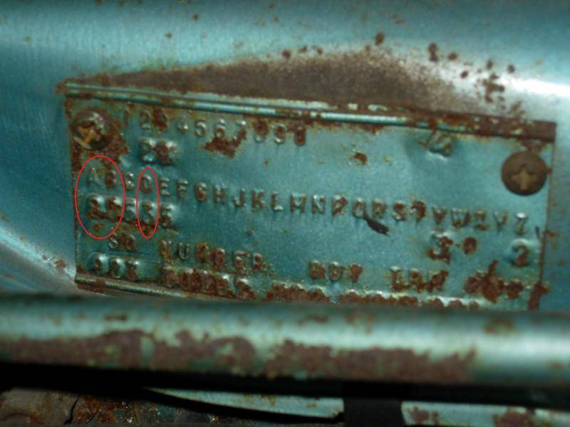

Here is a pic of my Polara data plate. Positions circled.
As stated earlier, under the AB 80=426, 70=413(340HP), 71=413(360HP), 62=383
under D 3=4spd, 5=auto, 2=3spd HD, 1=3spd

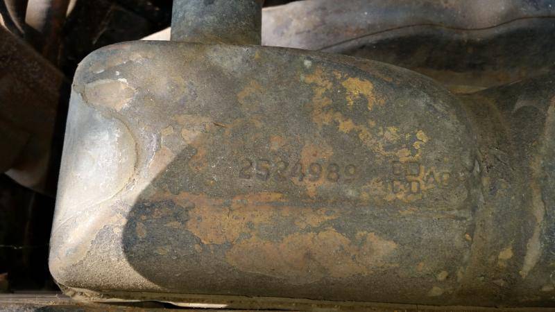

Radiator #2524989 should also have the 2 piece metal rad shroud.

If the car was built in Delaware (4th digit of VIN=6, Newark) the data plate will be on the lower cowl driver side, if built in Detroit (4th digit of VIN=3, Detroit) it should be on the driver fender wheelhouse. This is an observation I have made over many years of looking at these cars, no documentation that this is correct.
what does this all mean? Nothing, numbers can be transposed or totally incorrect, remember humans built these cars and stamping was done by hand. No bar codes or computers to verify(not that these things make it any better). Also casting dates can be anywhere from a day to quite a few months earlier than the date code on the pad.
