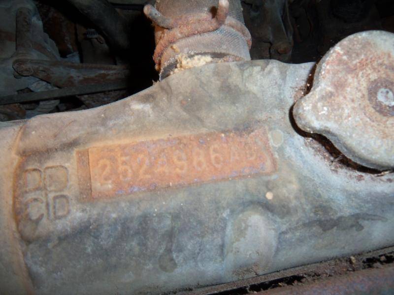

according to http://www.mymopar.com/radiatorspecs.htm the
2524986 radiator is for a 65 C-body with 413/426 and manual transmission. the plot thickens.

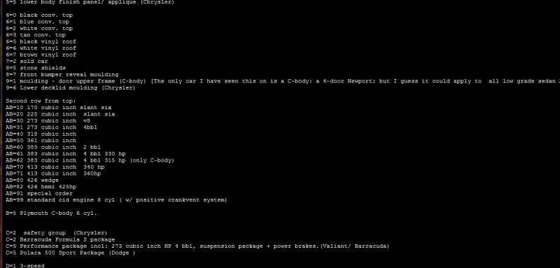

Very odd then with the 99 engine code if it's the 426W car.

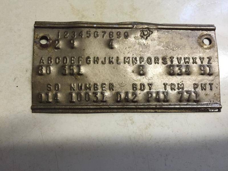

Then it would code for a 426 SW (code 80) and not standard (code 99 383-4bb) engine.
The SO number would not match the body and, probably, not the paint and trim codes.

Which would be a common radiator for, most, '65 300s or a New Yorker. (read: replacement) There's no proof, so far, it's the original radiator.

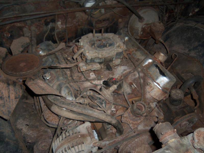

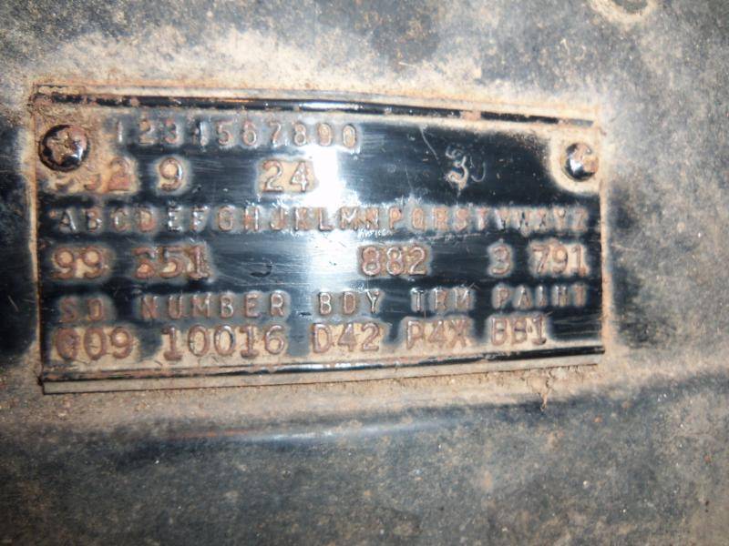

highly unlikely the radiator was replaced from another manual trans 300/ NY. No need for language brother- just looking for some help & guidance while we wait. Here are the pics of the rad, engine and tag. Didn't take any of the car- as the place was dark.
Q- did the 413's have a dual point dist.? This supposed 426 engine has one.100_1625.jpg100_1627.jpg100_1628.jpg
Here is a pic of my data plate. Shows the "80" under AB. as you already saw from the breakdown on my other Monaco with the 383, "99" (which is "62") is under AB.
The common radiator for most Chryslers would be the 2524989 413/426 Automatic.
Look for the ID pad.
On "RB" engines the cubic inch displacement is stamped on a pad located at the front of the block. "B" engines have a similar pad located on the right side of the block near the base of the distributor.
The 426W should have the pad in the same place as a 440. If the pad is in the same place as the 383 in your Barracuda it's a 383. When you find it it will have the displacement stamped into it. Plus some other info.

thanks Kelly- I'm familiar with the pads. There is no 426 on the pad unless its hiding. I scraped it off pretty well only to find a H and P kind of separated, then below in bottom left corner 12 then 2. I thought for sure it would show 426. I'll have to bring some emery paper when I go back, along with a better camera, alot of $$$, and a tow dolly.:eek:ccasion14: Cheers!
