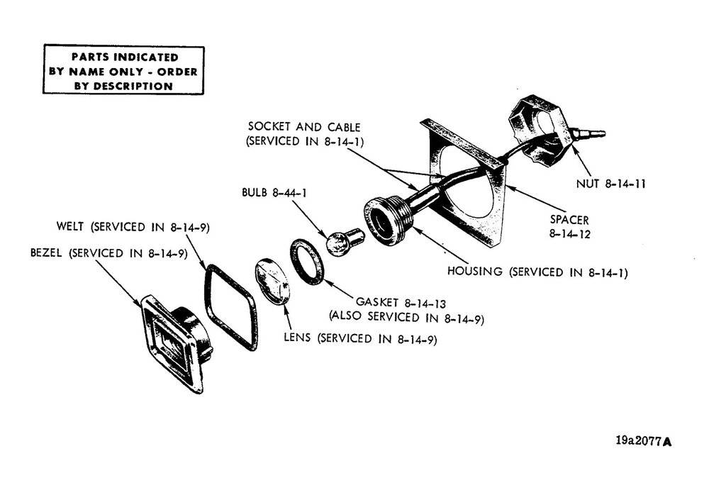

I do have the Service Manual and it does not show how to change any bulbs (would that be the owners' manual?).
That picture must be from the factory parts book.
Note that the bulb housing has two sets of threads. One to screw into the bezel, and the other for the retaining nut. So, as noted, it unscrews from the bezel to access the bulb.
