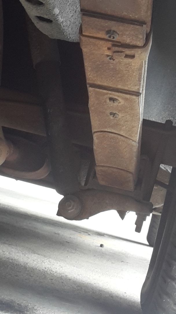

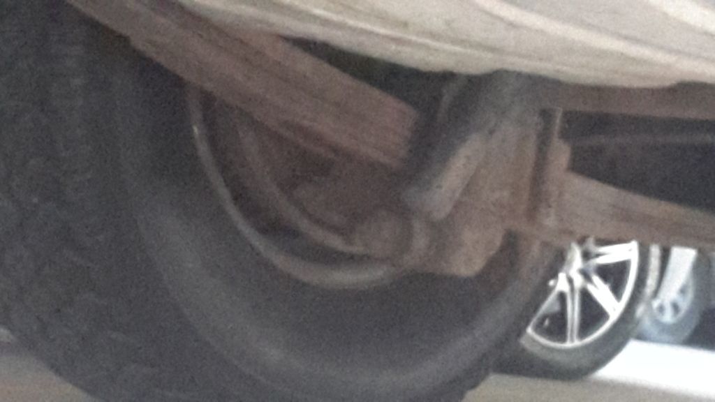

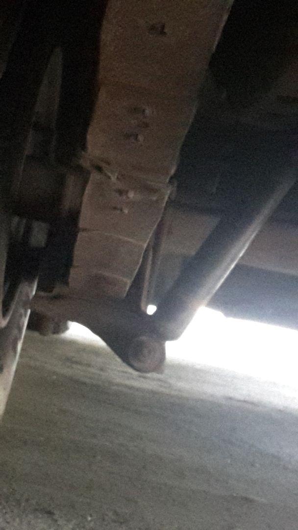

mmmm 7 leafs..... they just wont have sagged like everyone who has only 4 lol
Maybe the previous owner added three extra leafs? How many leafs does this cars had from factory?

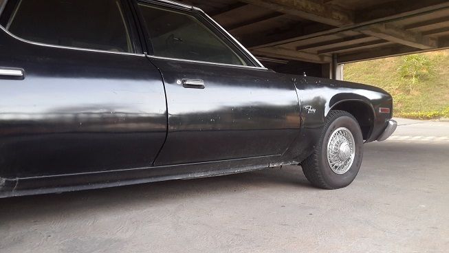

Here's the pic:
http://i1067.photobucket.com/albums/u434/josehf34/20150108_171443_zpsqy8vl4dz.jpg
OK... something is amiss here, the front wheels don't look centered in the wheel arch, unless it's just the angle of the pic for starters. It looks like the center of the wheels seem to be back too far. It also seems like the wheels or the tires are the wrong sizes.Changing the ride height is not as simple as just lowering or raising the front end by cranking the torsion bars up or down because that affects the alignment and therefore the drivability of the car. The car can become twitchy if not done properly without other alignment adjustments. It's my opinion that if you had the proper size tires, and or wheels it might be ok.
That photo was taken before tires change (same size 235/75R15, just a new set) and front-end rebuild, this weekend will take a new picture and post it

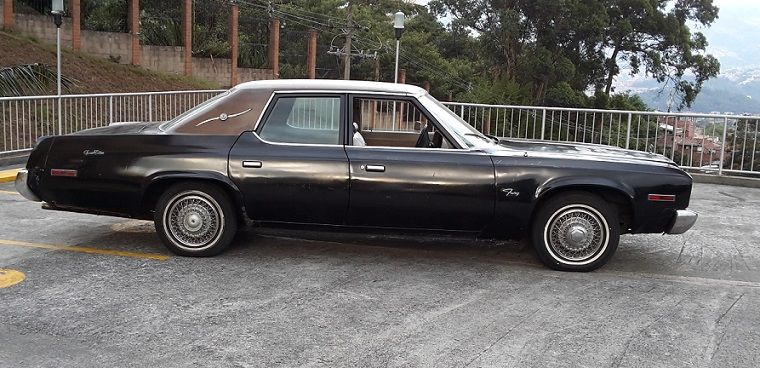

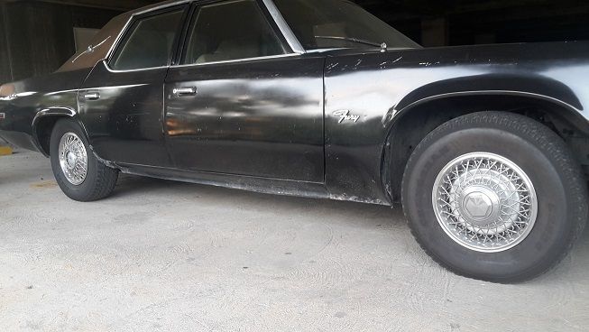

Still waiting for a flat on side view....
See below.
Why are we making this so hard, Jose¿
