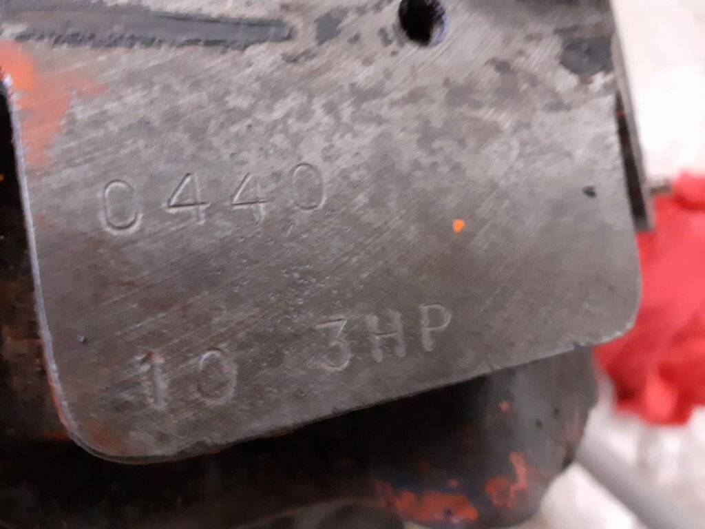

As for the "HP2" blocks, when we were discussing this in one of our old North Loop Dodge Performance team member discussions, there was allegedly something magic about them. But, as mentioned, it was more what was INSIDE them than the block itself. It was mentioned that most of the HP engines were built in the second shift, hence the "HP2" stamp on many . . . IF that was indeed accurate.
There is also some alleged magic in the "hourglass" water passage holes in the deck of the 440 MHC blocks. As if those engines need more coolant flow than a normal passenger car/light truck engine might? BUT when the head gasket is laid onto the deck, that "hourglass" is covered over by a coolant flow restrictor that has only ONE smaller hole in it, as a normal B/RB engine would have.
End result, the "hourglass" was a visual cue for the assembly line people to know what was going into the particular machined block. Similar to the "HP" stamp.
