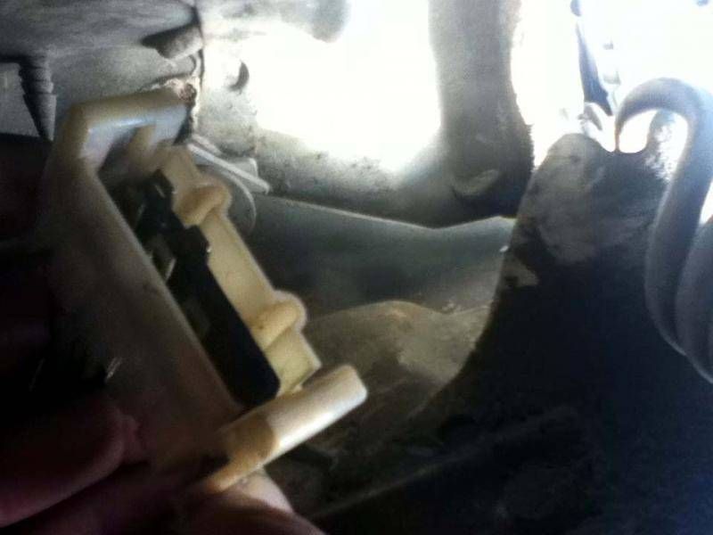

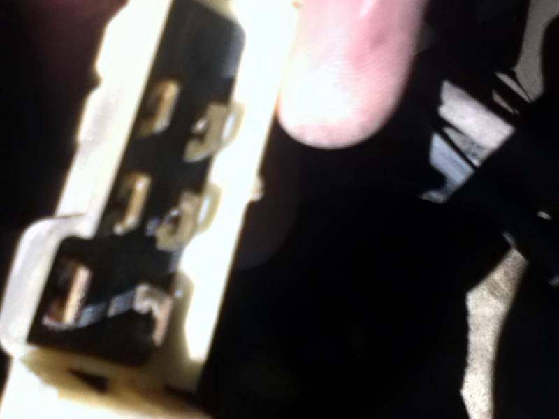

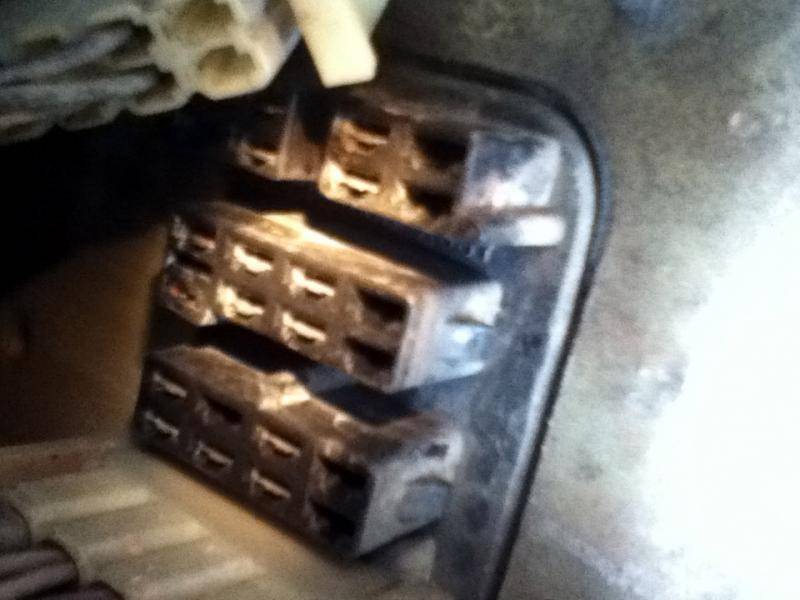

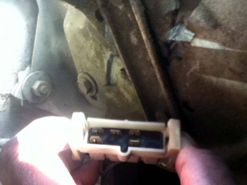

Yeah, the motor shut off and then I notices a few whiffs of white smoke come from one of the vents....although I can't be 100% certain I'm thinking it was the fuse/wire sheathing/plastic connectors melting. I didn't notice anything abnormal when I looked under and through the dashboard, but I think I'll get up under there again with a good flash light to be sure..........more to come.
