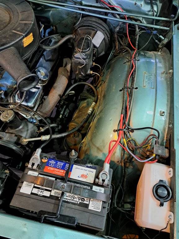

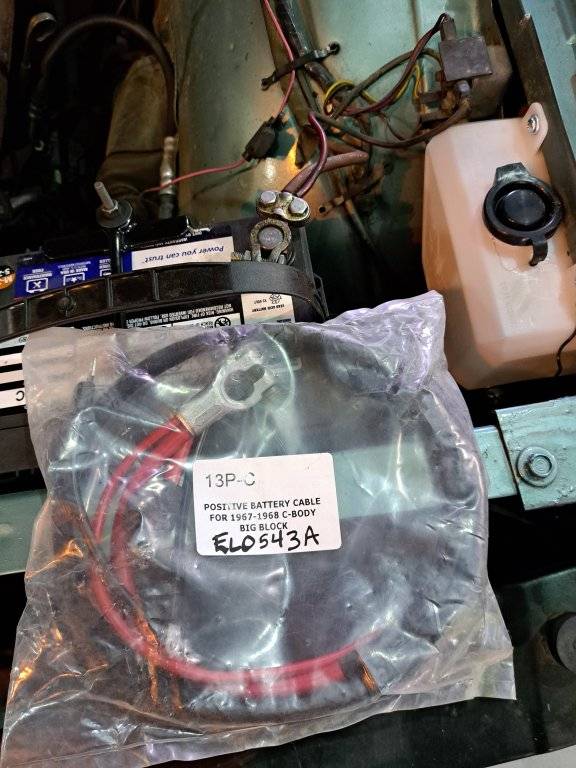

Does anyone out there have a factory or reproduction positive battery cable for a '67 or '68 Newport? If so, can I impose upon you to measure it's length, and the length of the leads coming off of the cable? Also, a picture of it stretched out, please? I want to get one custom made out of 1/0 welding cable, and the repro cable I already have is kind busy running the car. I'm doing a Mercedes electric fan install this winter and I want to beef up the charging capacity to keep up with it.

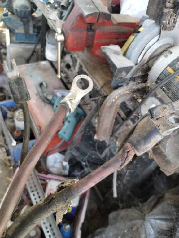

The conductor length of the #4 AWG hot cable from battery to starter lug runs 49" even. The #12 AWG solenoid wire still cloth taped to that runs 1/2" longer, and has its original factory
terminals on both ends. The same cable for our old 1966 comes to just 42", but clearly was pruned by myself and the former owner. I take it you have a high ampacity alternator to push all the extra current you plan on? I run a modest 225 W fan motor as a pusher, but reckon you're going for full up electric engine cooling with this rig. Good on you!
