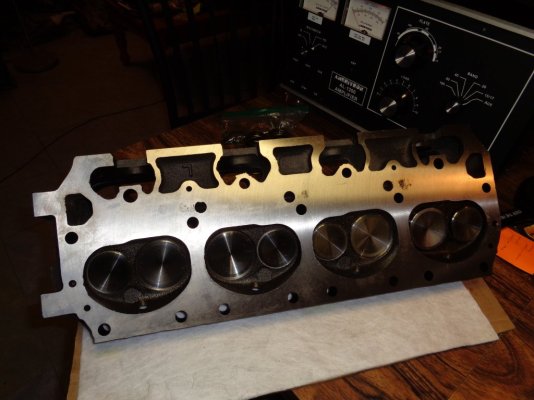

if it dont self destruct I'm goodEverything always looks so neat when clean and new! I hope everything lives up to your desires!
