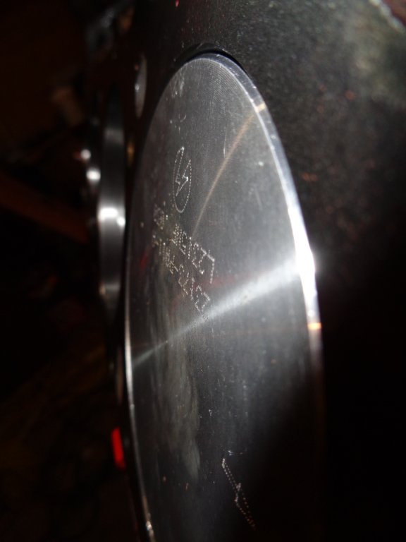

1.920 comp h
deck is 9.972
was 9.986
says 0 deck would be 9.965

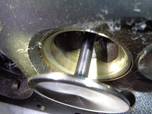

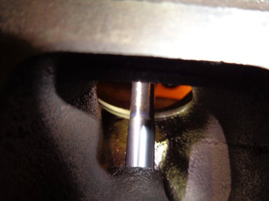

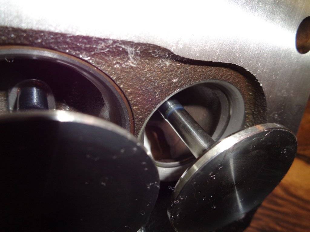

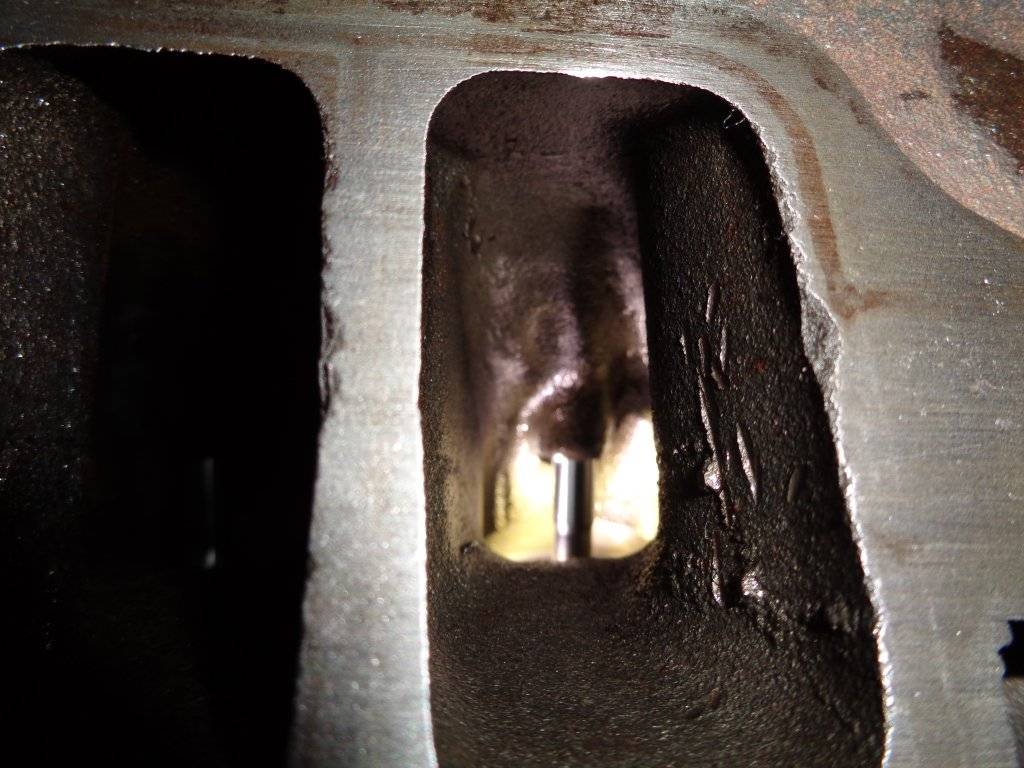

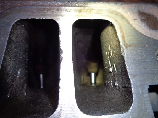

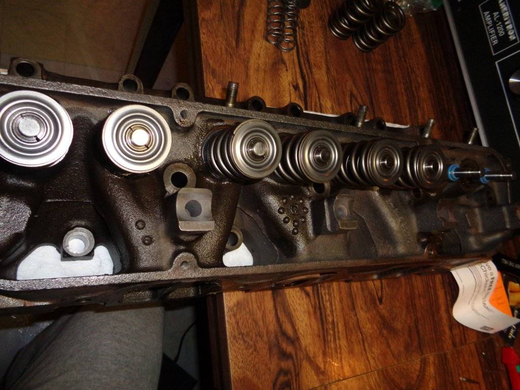

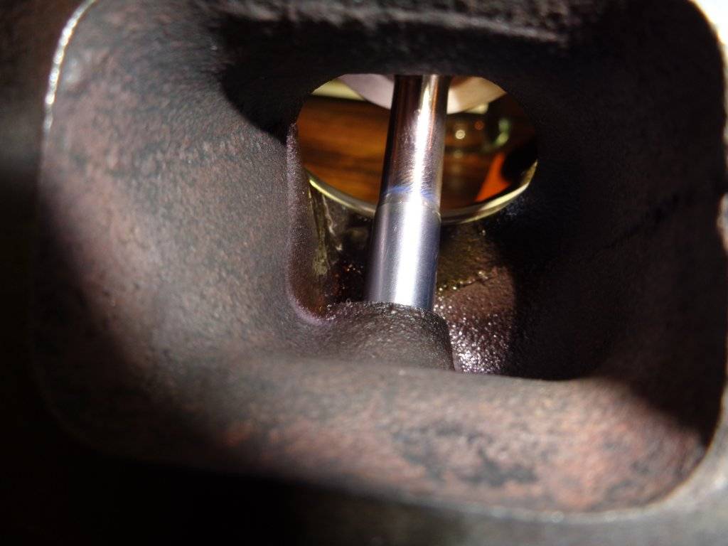

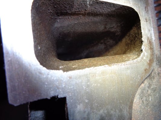

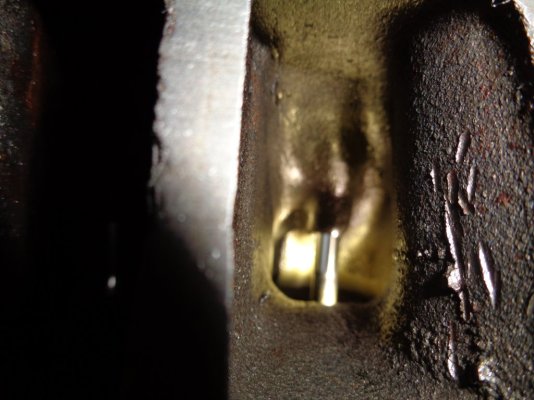

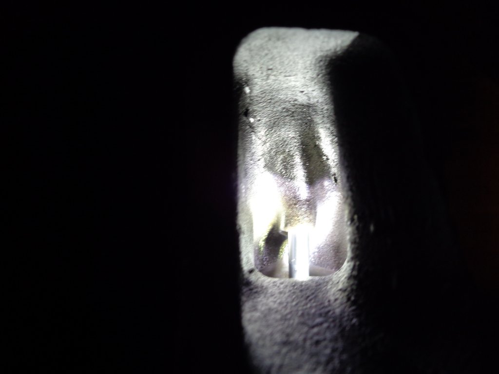

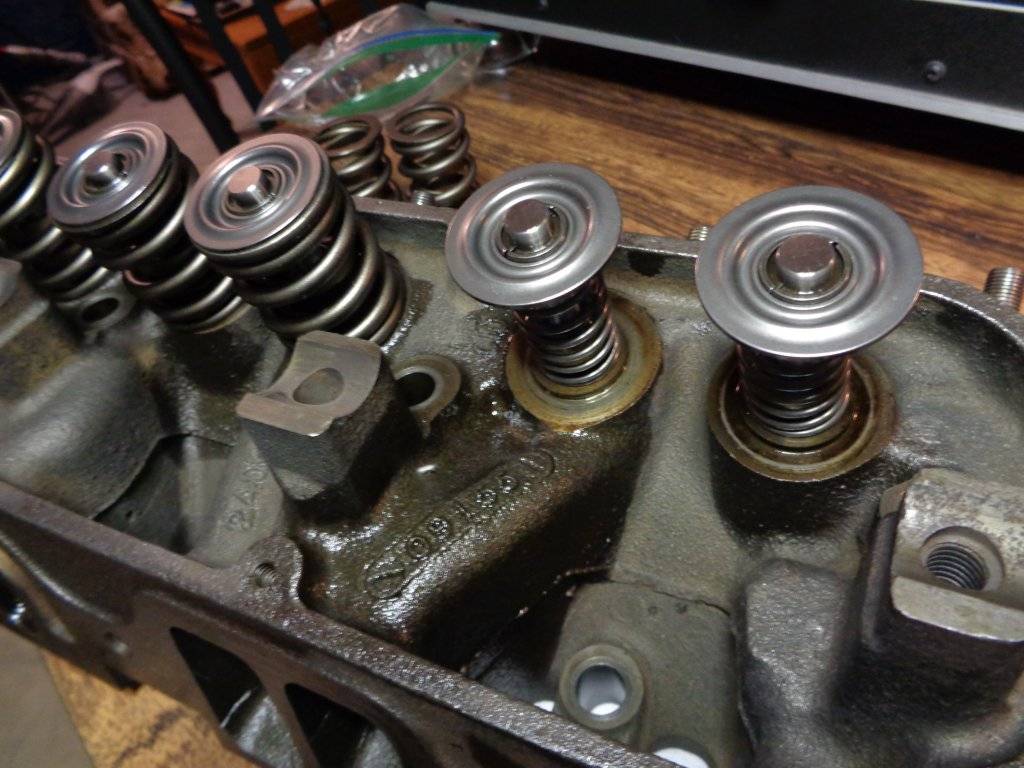

I got my heads back. I gave him my intake and a fiber gasket and asked him to port match them and spend some time with them...I have questions.
He did the k-line inserts.
Anyone care to give a prognosis? And why is there a big gap on the new seats?
He said he would do the heads for $1500 all in parts included. I bought the hardware and told him to take the money that I paid for the hardware and put some time on the heads port matching and take your time. I'm skeptical...
