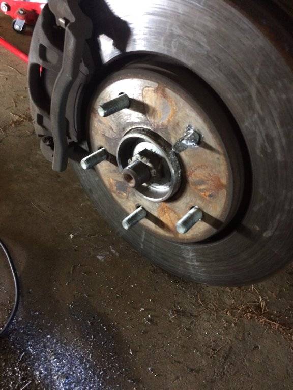

just can't use an acorn nut to pull the stud in. use a plain nut upside down, flat side vs. tapered against the washer.
This guy's working on a different year, but should be pretty much the same thing. Expect to tear up the nut you use to draw the stud in with.I would need to get a whole new hub/bearing assembly in order to replace the studs - correct?
Yes Sir! It's listed in Snapon's Supplemental catalog. I have both the small one for cars and the big one for heavy trucks on my truck this very moment.Lisle?!?!?![]()
