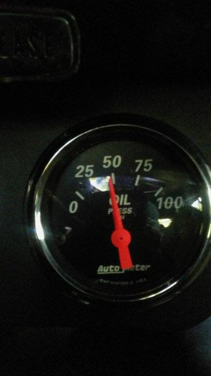

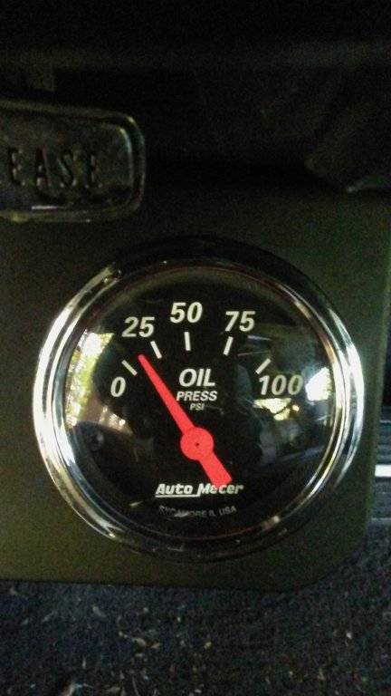

i should not have installed these two gauges

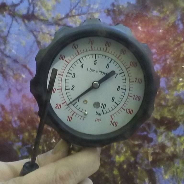

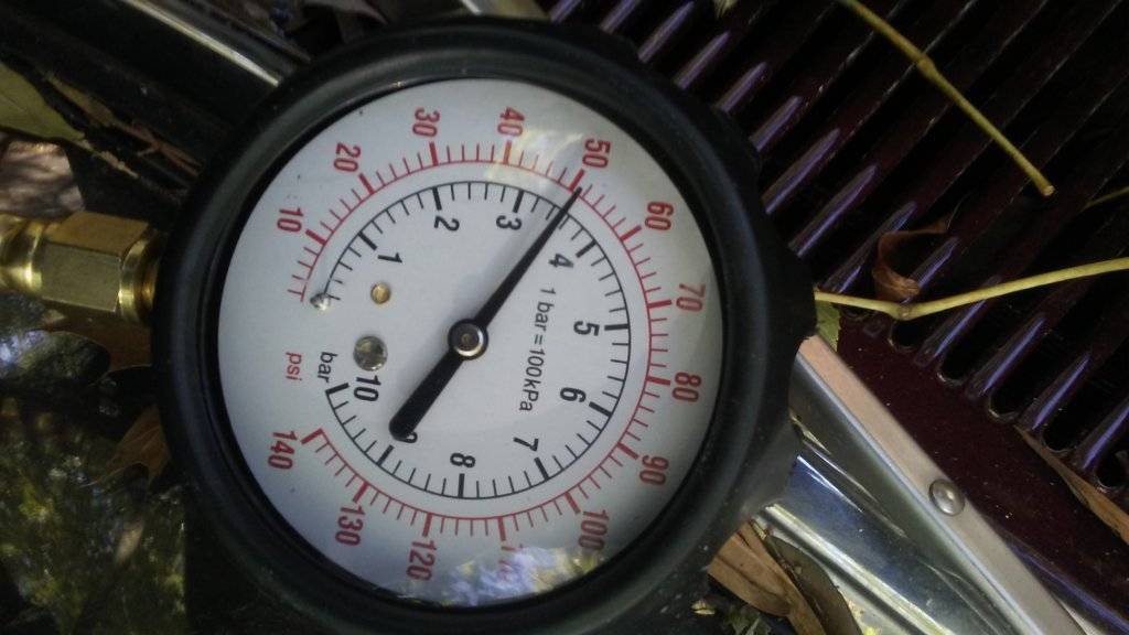

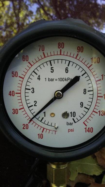

My suggestion of using a cheap mechanical gauge to verify your oil pressure is based on the word "cheap" followed by "easy". It would be fairly easy to hook up in your garage and is a great diagnostic piece to have in your toolbox for the future. Buying another electrical gauge and sender doesn't fit my version of "cheap", so I didn't suggest it.

For all the discussion of how accurate aftermarket gauges are/aren't, go to ground zero. Get a thermal/infrared - point/click tool from Amazon and check it against your gauges, check in various locations on the block, heads, water housing. I've found my Autometer temp gauge to be fairly representative of the state of my engine temperature, within 5° when doing this.
If you are genuinely running this hot, that will surely be dropping your OP too. The OP is the more dire issue, but the temperature might be the cause.
