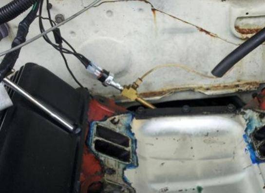

Call it Poki, Pookey, Gorilla Snot, or any thing else that works for yeah. I've found that the cute little squeeze tubes of the Black Crap that Mother Mopar sells at their partz counter iz hard to beat, temprature proof, and pretty leak proof if you apply it right, My .02s
I love this idea saylor! ...I'm gonna do that if I can find the lower tube and a 'T' block
heh I dunno if you are serious or not :)
the purists here bagged on me pretty good for that one. that's my oil pressure kill switch for my electric fuel pump.
needs a piece of wire loom on it to clean the look up, but ya - $10 at lowes for the tube and the T both. Brass is expensive right now...
there is a post from me somewhere about adding the FP and switch and relay. But that goes into the oil senso hole, then the clear tube goes to my cheap under dash sun oil pressure gauge, and the silver and black thing with the wires is the kill switch.

I was serious. I figured I would like to have not only the mechanical oil preasure guage but the 'dummy' oil preasure light in the dash as well.
Additionally I didnt know you were also using that sensor as a fuel cut-off switch as well... very cool and innovative as well. Thank you
that would work, for sure. unless you can find the 'other' port mentioned above ^^ - I haven't gone looking for it it's too damn hot here to work on cars right now.
that switch is from napa, I cant find the link, but its about $14 bucks and has 3 prongs - S, I, P. Starter, Ignition, Pump. When you turn the key S and P close so it pumps when you are cranking. When oil pressure exists (the motor is running) I and P close. If you loose oil pressure, S and P close, but your key is not in S position, so the pump shuts off. I also have it running thru a relay so I can draw power direct from BATT. Then thru an inline 5A fuse to the pump. I thought I wrote it all up here somewhere in the forum but cannot find it right now.
if you wanted to be really cool, you could also wire in a rollover & shock switch, so if you flipped or got hit real hard it would stop the pump also. I heard the ford switch is easy to wire in, like out of a taurus or something, it was interior-trunk mounted I think.
