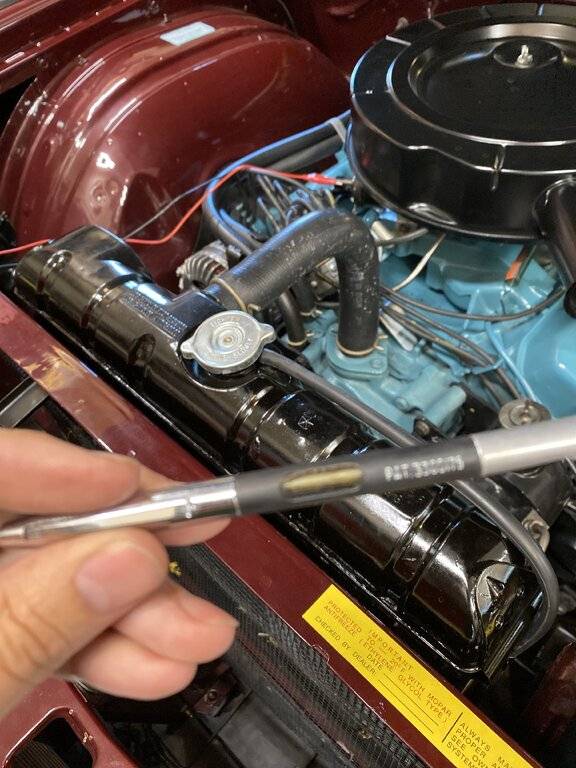

Coil and SP wires are fairly new. I used my handy dandy champion firing indicator pen and have good spark through the coil wire and to the plugs. You can see the flash going intermittent when it starts missing. Otherwise the coil wire when running properly is almost a steady light.
