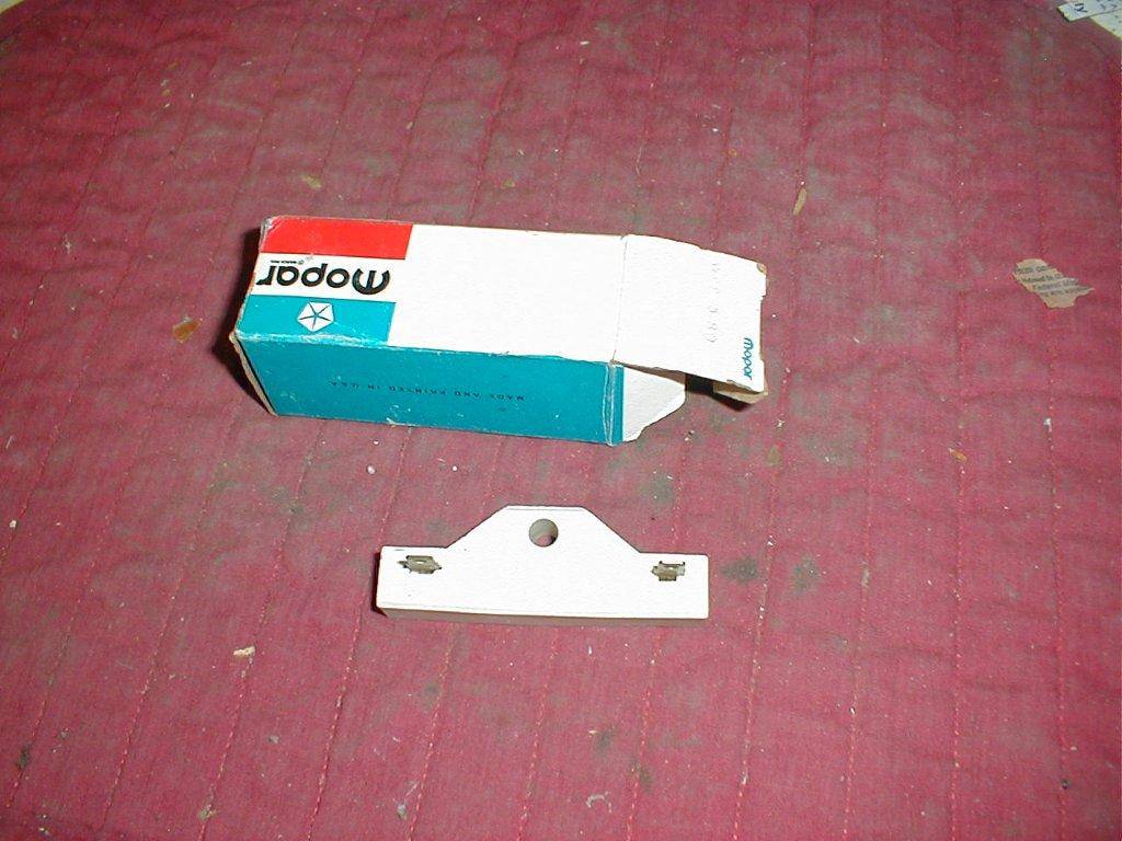

So does anyone have a picture of the NOS one from ‘68 era? P/N 2095501. Google show’s many different pictures.
Were they all ceramic? Or were they ceramic with the metal retainer?
Original ballast had a Metal strap wrapped around to mount. Two holes, there is a bump out on the firewall that goes in the other hole so they are level when tightened.
The all ceramic came out later on like mid 70’s.
Shoot me a pm as a reminder have a box full. 72 up were definitely all ceramic because they went to electronic with the dual ballast. Thinking 68/69 was the change over?

Correct ballast resistor for standard to electronic conversion
I remember all my 1968 Furys had this style from owning Furys from 1970 to 1986/7

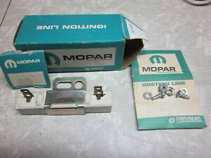

I don't ever recall seeing the chinesium gold type plating on the bracket back then.
This type back then was considered a 'Aftermarket' variety although doing this latest picture search I see many reference for 'Jeep'.
Hope this helps.
