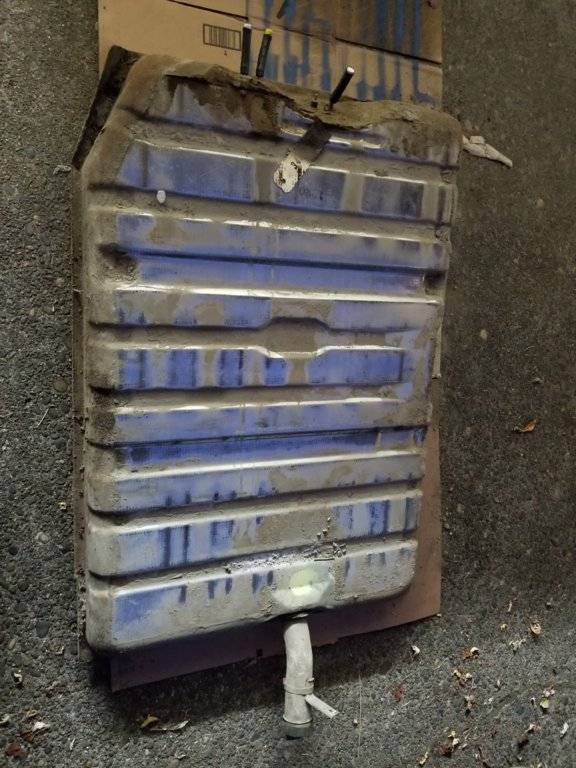

Tank removed. That was "fun." It looks awesome. The top is nice and shiny. It looks like brand new steel. There is a tag on top that I think has the part number on it. There is also a single spot of exterior paint on it. I'll pull the sending unit this weekend.

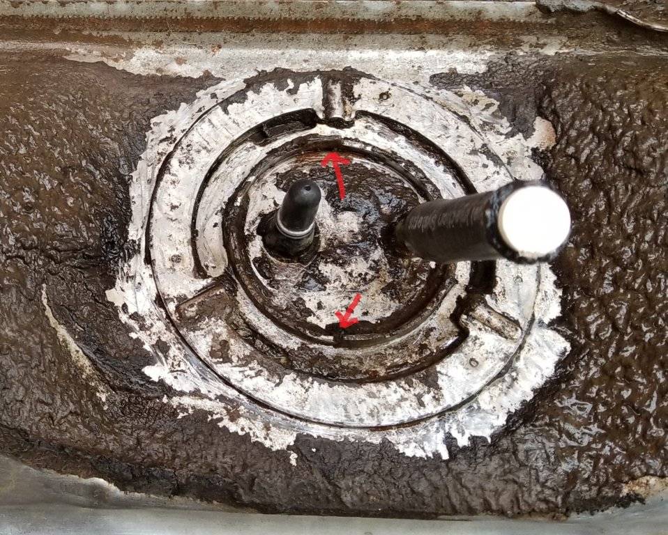

Saylor - I found your old thread and will try that PVC pipe idea. I pasted a link below for convenience. Do the notches go on the tabs on the inner ring? See pic below with arrows pointing to tabs. The PVC tool has four notches so it seems like that must be it, but I don't see how that inner ring will come out with that larger outer ring in place.

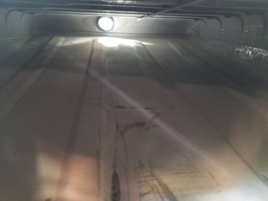

The inside of the tank looks good viewing from the filler side. I don't see any rust or debris or sludge, just a whitish, powdery coating everywhere.

The four notches go over the four tabs. You might have to take a brass drift and tap the lock ring to break it loose. The gaps in the center lock ring is where it will be disengaged and can be pulled off. That is some of the ugliest undercoating I have ever seen.

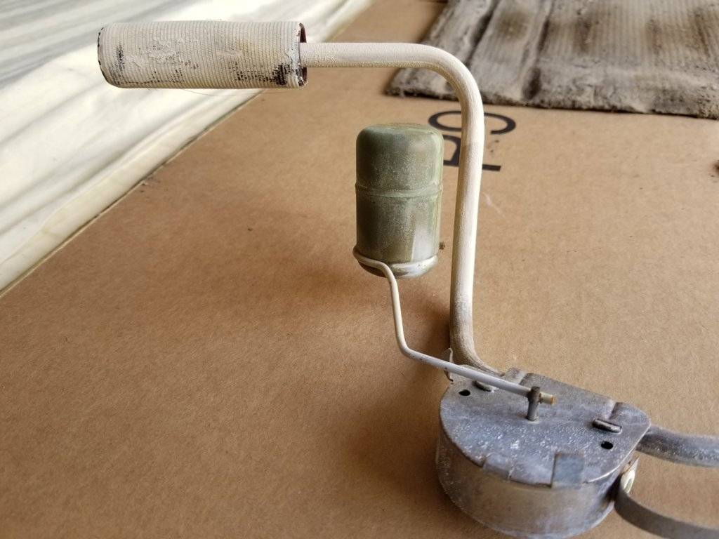

Got it out. It looks pretty good except for the white powdery coating all over the sock. I think that must have been the problem. The inside of the tank looks pretty good too. I'm not sure I need to anything to it. My neighbor thinks the white coating is lead.

The white coating is the remains of the coating inside the tank to prevent corrosion. It breaks down over time. Have the tank professionally clean and install a new sock. Check the fuel sender w/ a DVOM meter that has grafting capability while its out. Saves you time if its bad. Change your fuel filter too if not done already.
