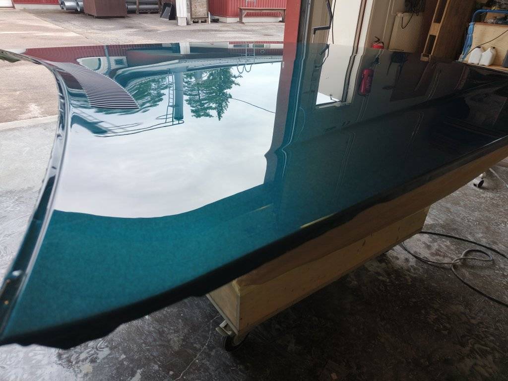

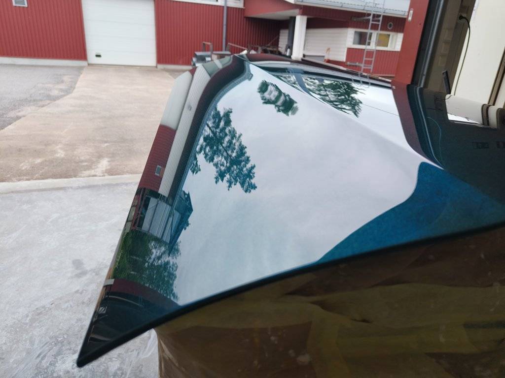

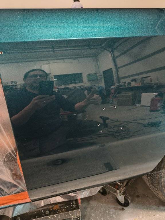

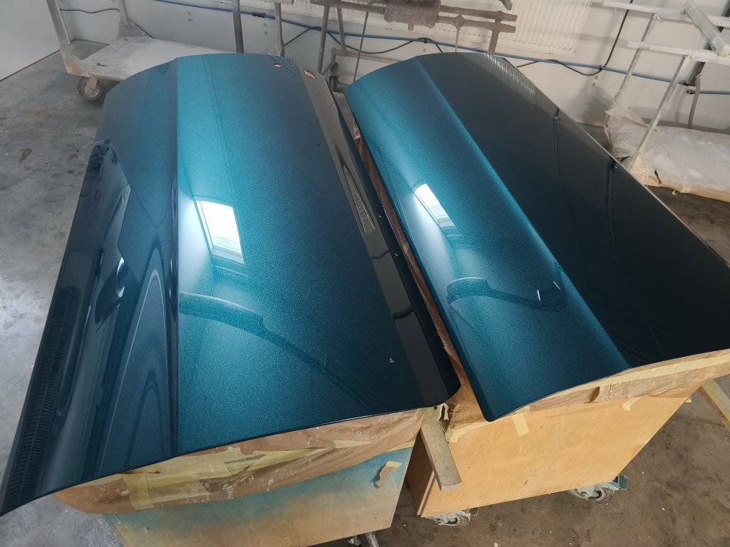

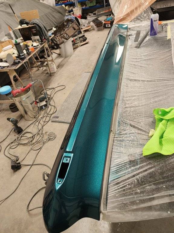

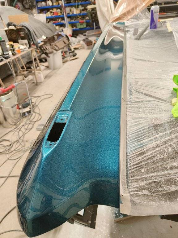

Fantastic!Let the fun begin ... sanding (for a change..) and buffing . Sanding down to #2000 (1000-1500-2000) and then buffing.
Front fender done for example, still hologram remover need to do but looks quite ok already.
Regards, Mika

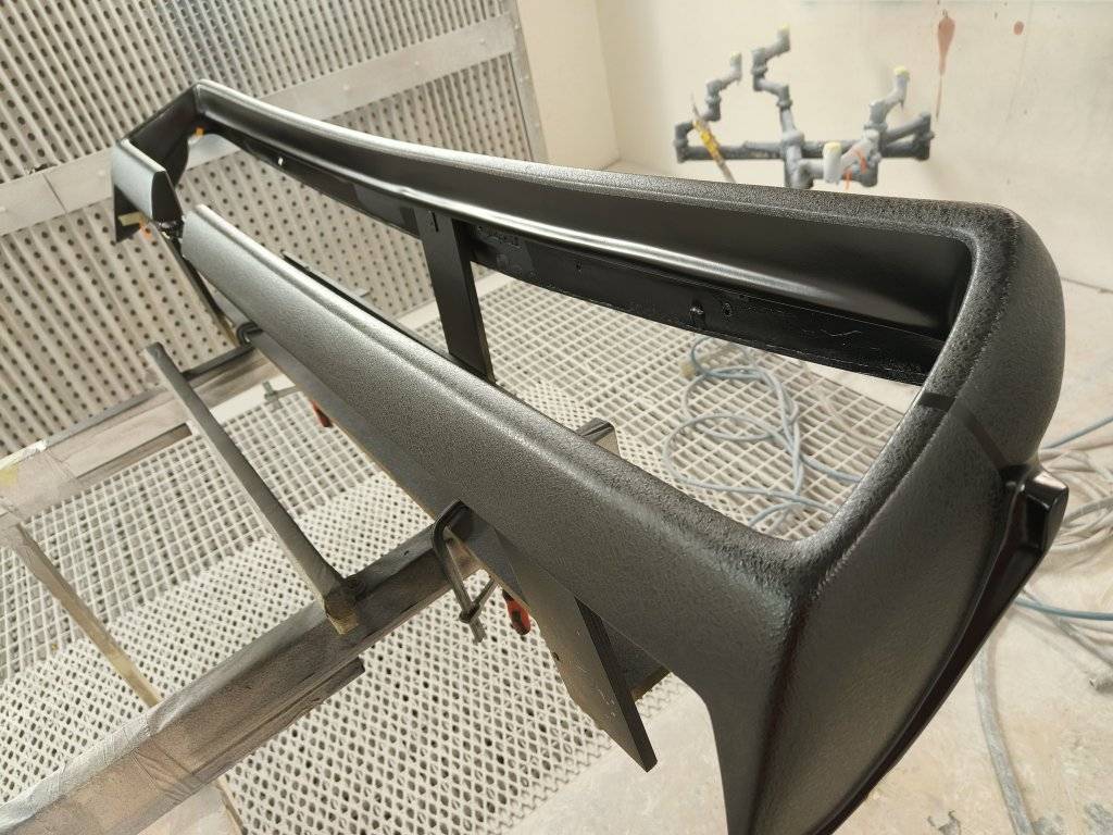

The dash looks great and the car looks exceptional!

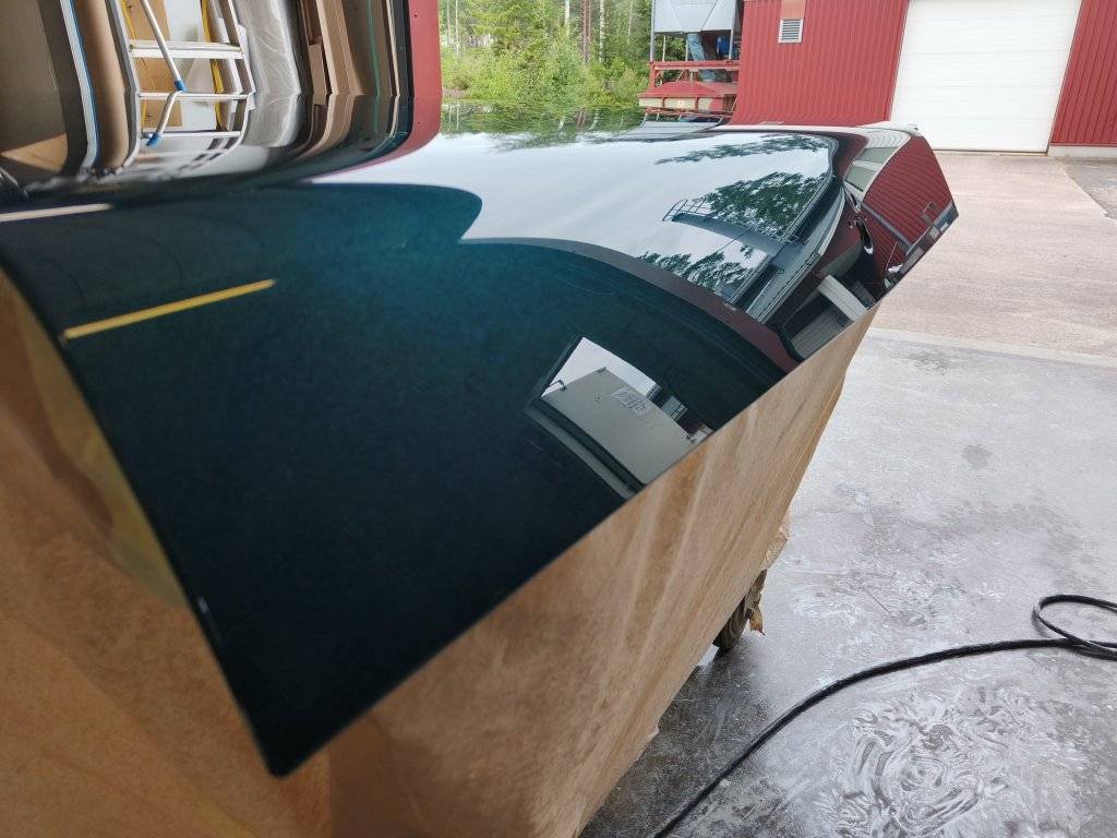

Sanding is soo much work and kind of nerv wrecking, at least for me, because of the fear to sand through the clearcoat and start all over...Let the fun begin ... sanding (for a change..) and buffing . Sanding down to #2000 (1000-1500-2000) and then buffing.

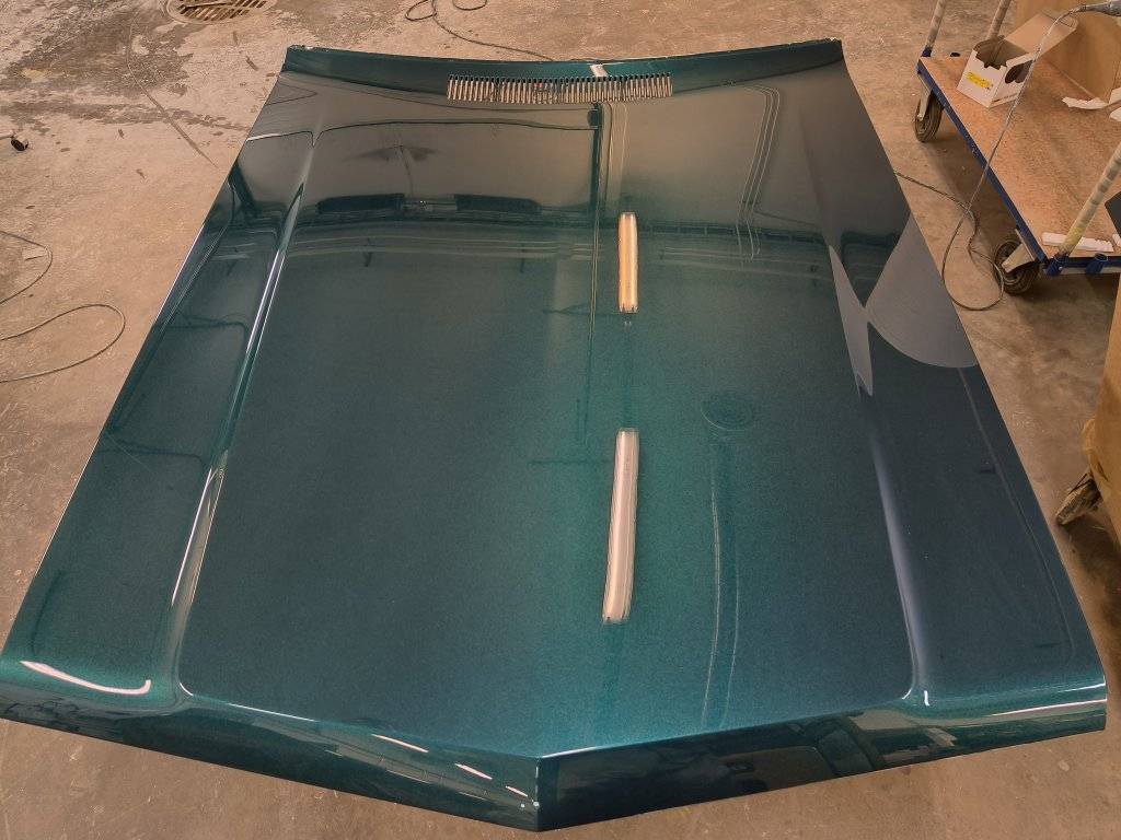

finally all parts are sanded and polished. Not so bad..
