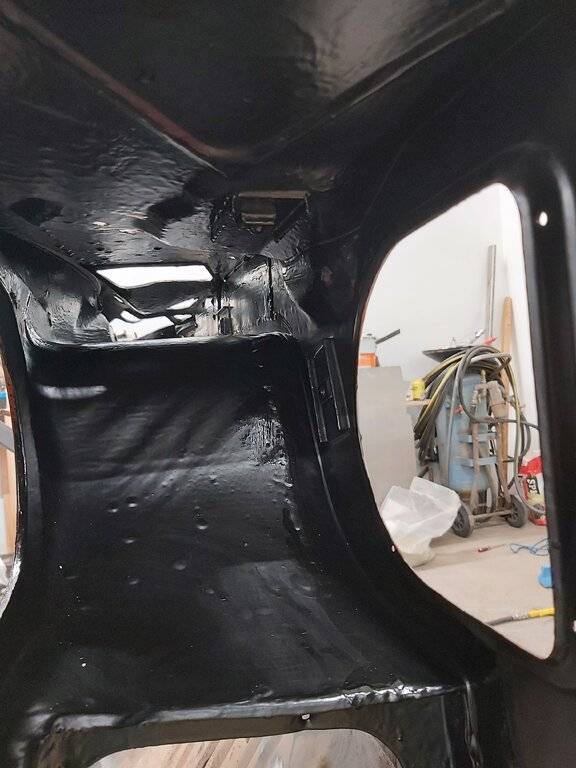

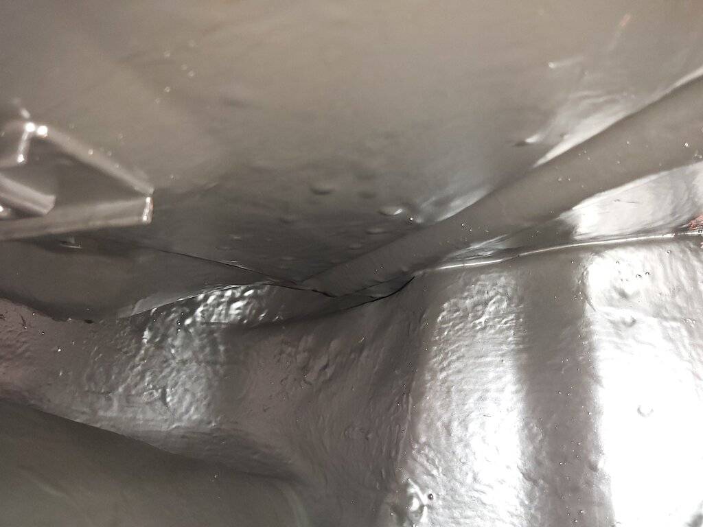

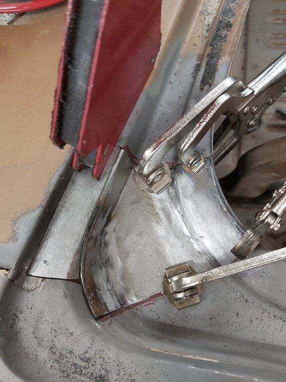

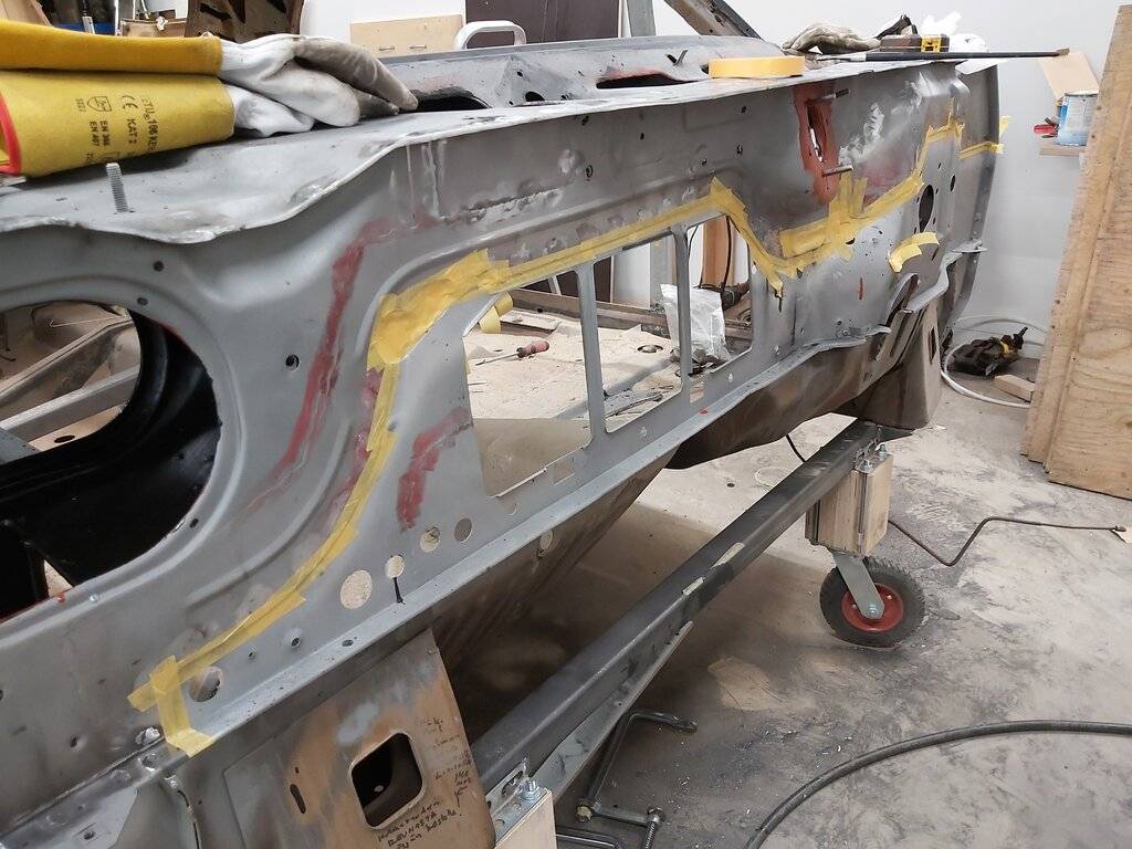

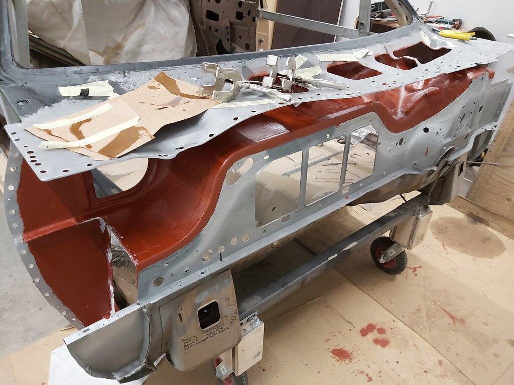

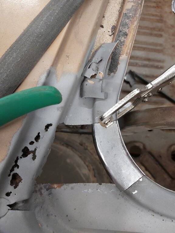

Some new progress. Firewall FINALLY back in place ! Inside surfaces painted two coats of epoxy, and PU topcoat. All the hard to reach corners I sprayed with cavity wax spray gun (..yes, epoxy and Pu..), it dosen't look like so nice but more important is good layers of paint. After welding back together all seams taped and then more PU paint ( that also have rust inhibitors) from inside to fill all caps. Afterwards finalizing with pu sealer. I think this will last at least next 50 years..I hope!
Outside looks messy but sandblasting for a last time will clean that before epoxy.

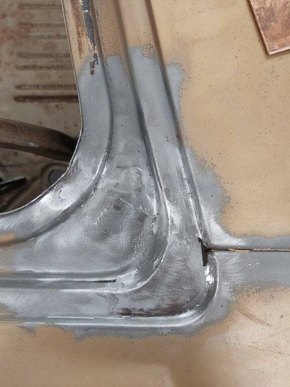

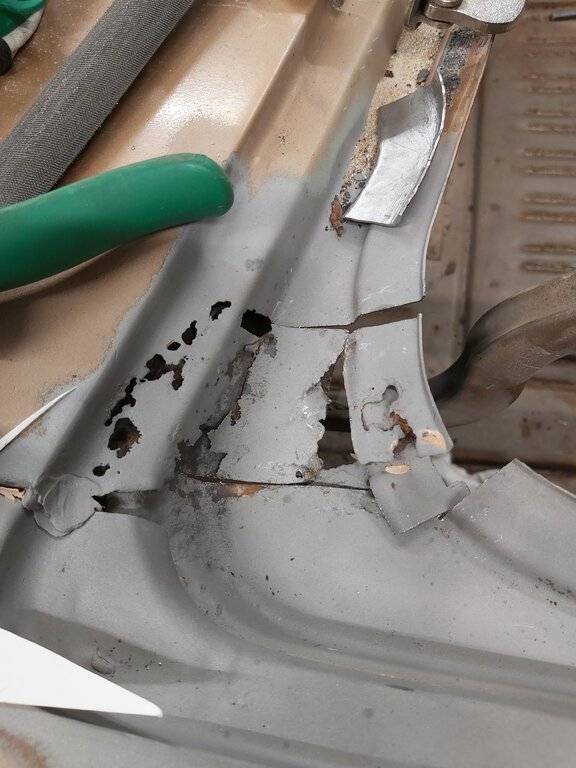

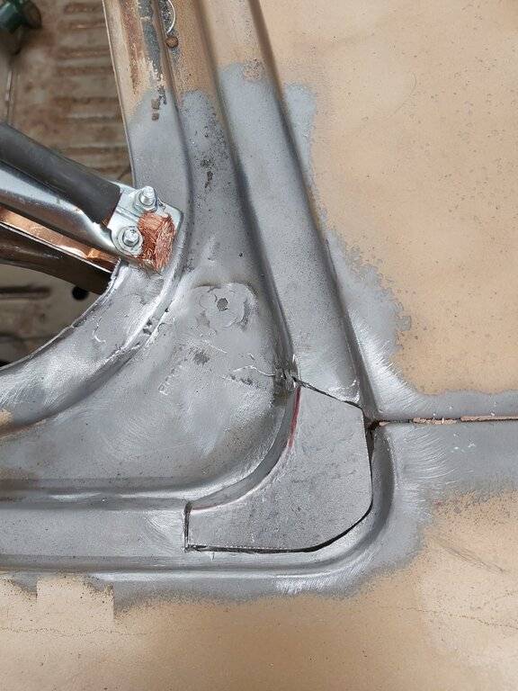

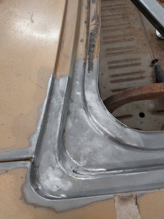

Also rear weatherstrip canal corners done.
