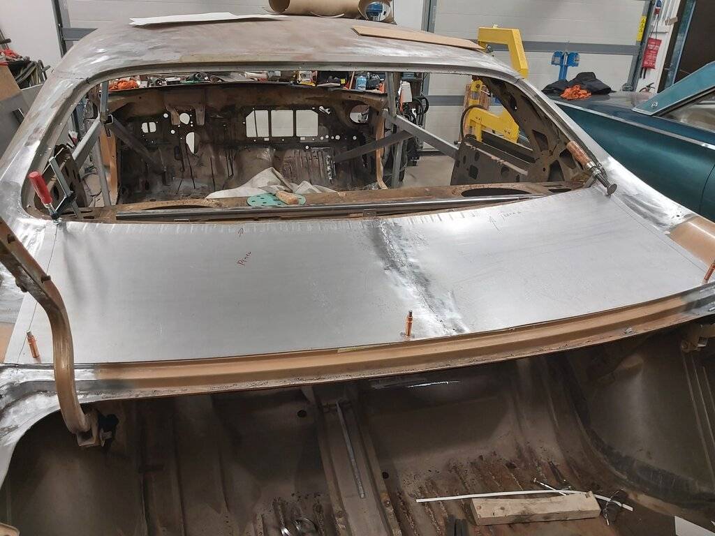

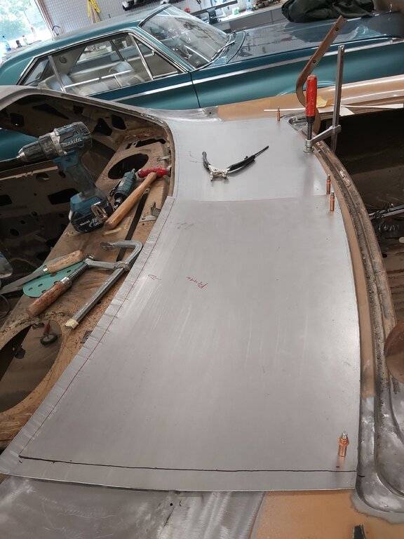

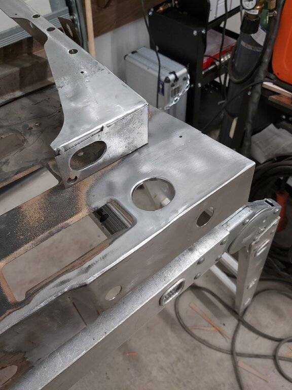

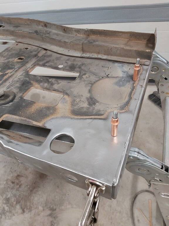

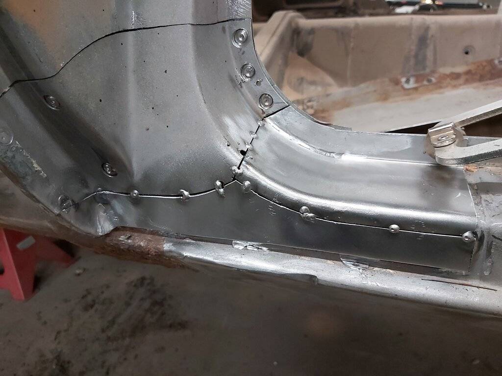

Dutchman panel waiting for shrinking disc tool , there is some heat distortion in tig welded seam and I'd like to test that disc tool here ( already ordered from Wolfes metal fabrications). Also front radiator frame corner done. Regards
Mika
Mika
View attachment 392933View attachment 392934 View attachment 392935 View attachment 392936View attachment 392937View attachment 392938 View attachment 392940 View attachment 392941
For someone who says he’s NOT a metal man!! I think you’re BULLSHITTEN us....:stop: your work is looking sweet.

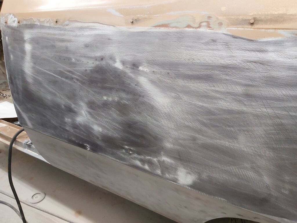

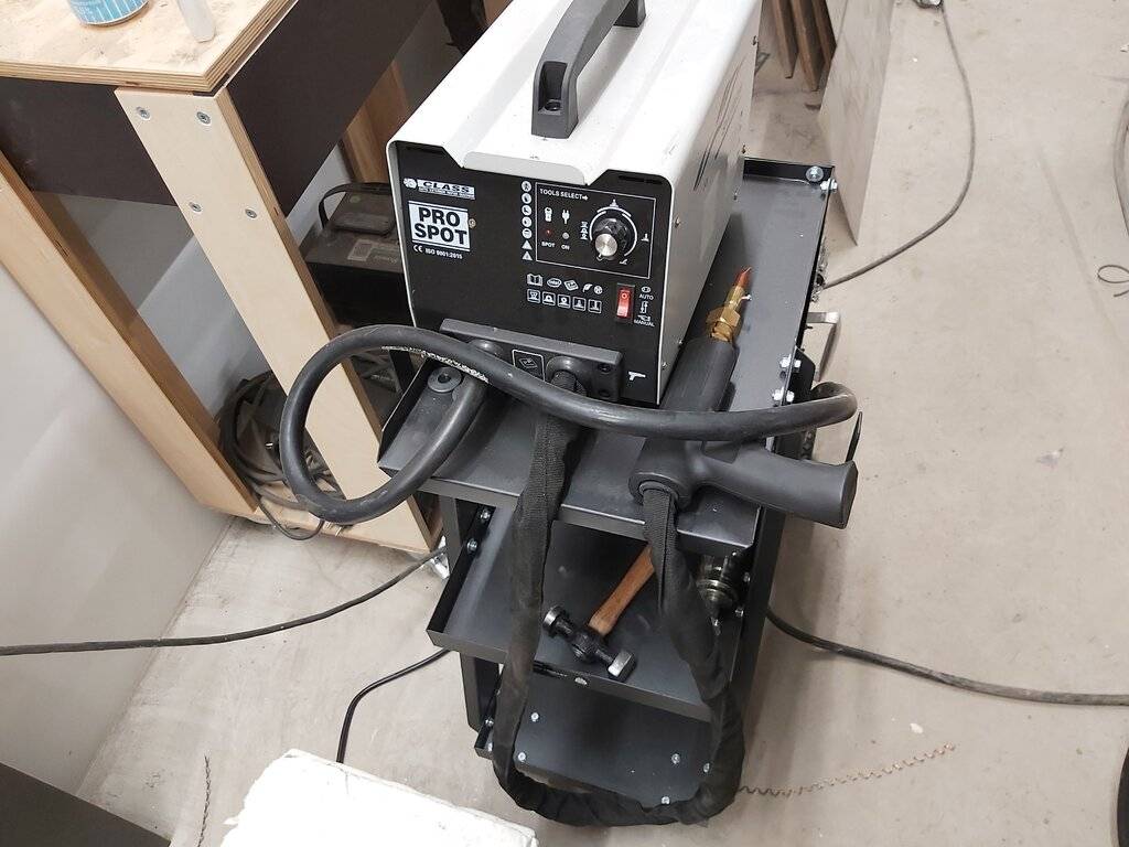

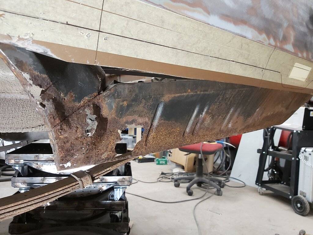

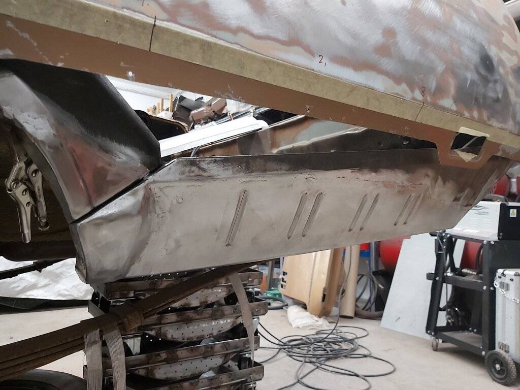

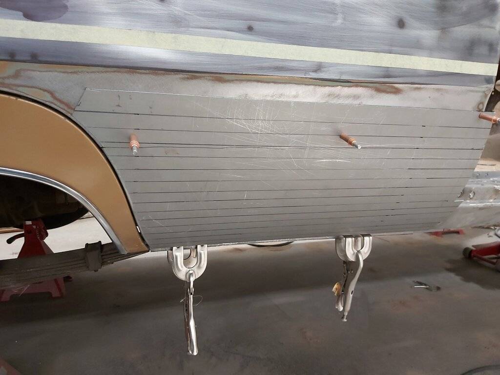

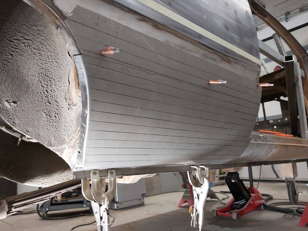

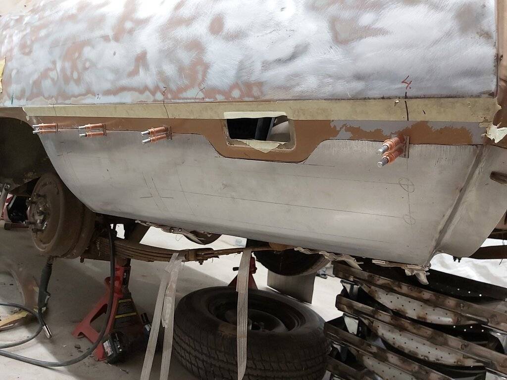

Small steps here, now working on passengers side quarter panel and at the same time drivers side too. Drivers side need some body work before rust repair. There was old repair and it was done mainly with bondo. I bought spot welder for this job ( cheap Chinese model, this time there was no change to buy 1500 euro pro tool..) and it seems working ok. Both sides still under construction..
I tested alcohol based wood stain for showing high and low areas on that damage, works ok!

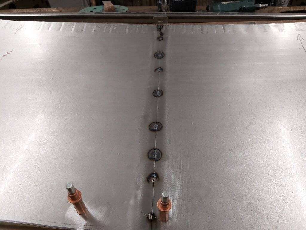

@live4theking
It's pulling hammer for pulling dents out. First you spot weld that "snake" wire in place and then you can stick that fork on that and use hammer.
You can spot weld different tools and use different hooks on that hammer. Hope you can follow my explanation :)!
@live4theking
You can spot weld different tools and use different hooks on that hammer. Hope you can follow my explanation :)!View attachment 396146
Makes perfect sense. I had never seen that set up before. Thanks for the explanation.

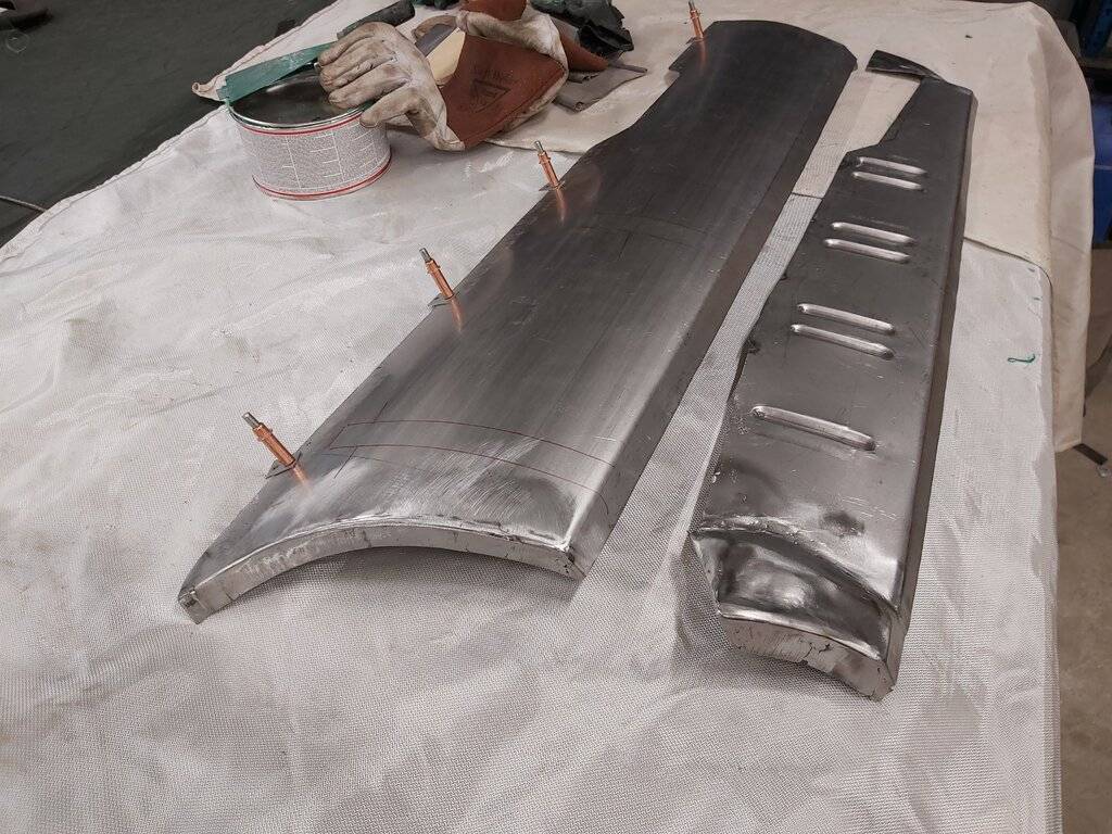

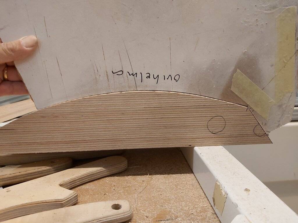

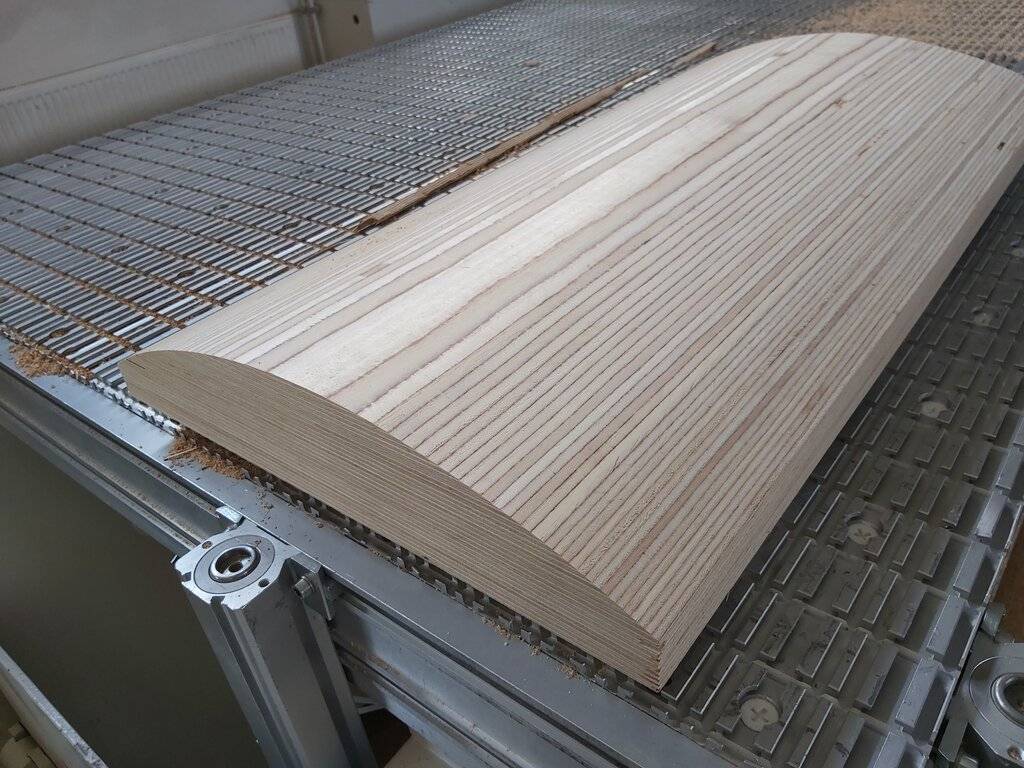

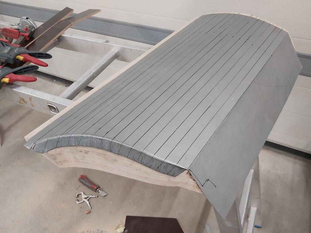

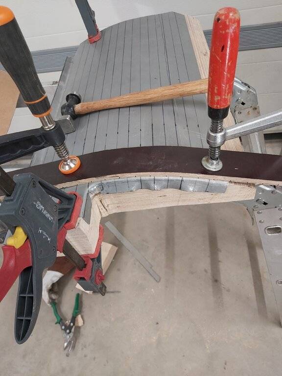

What do you need when you start working on lower quarter panel? Ofcourse heavy duty CNC router, block of plywood and some sheet metal! Okay, you can do this many ways but for me this is easiest way. First I did model out of MDF and then some 3d modeling and programming. After that routing with CNC and now I had surface model for the panel. This model helps me to do all the edges not for surface curvature, that is made with English wheel. When you do this kind of panel with curvature only one direction you need to cover upper wheel with wide rubber band, then it will stretch only one direction....to be continued...
Regards
Mika
Regards
Mika View attachment 398751 View attachment 398752 View attachment 398753 View attachment 398755 View attachment 398756 View attachment 398757 View attachment 398758 View attachment 398759
Awesome! Thank you for sharing, we all are envious and are looking forward to seeing your continued progress and craftsmanship!

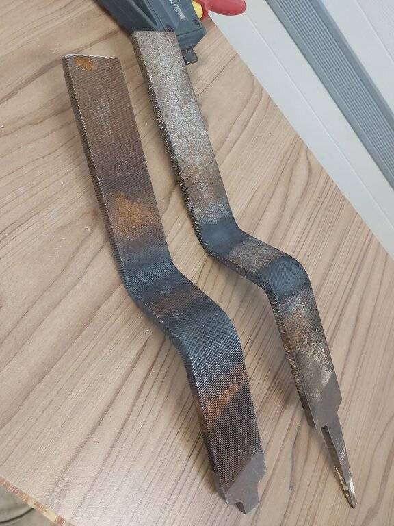

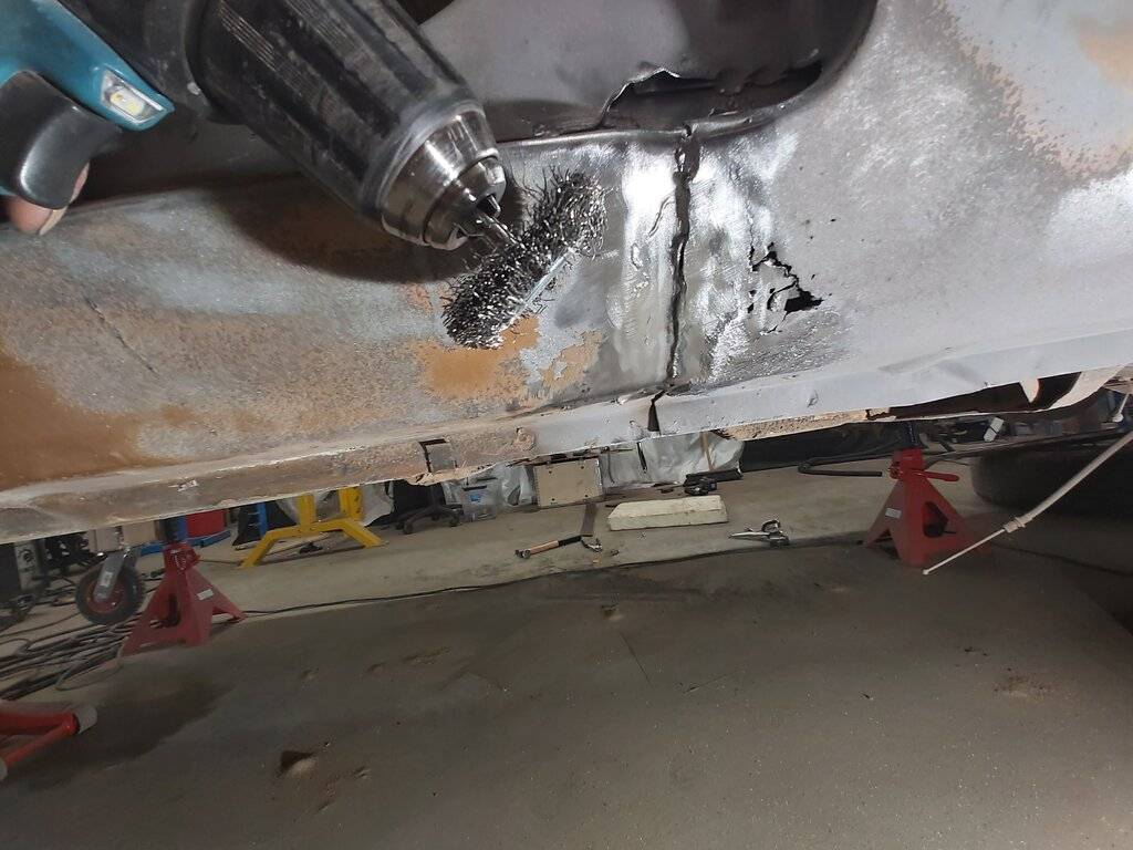

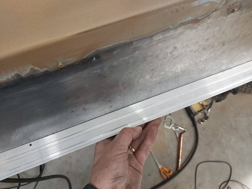

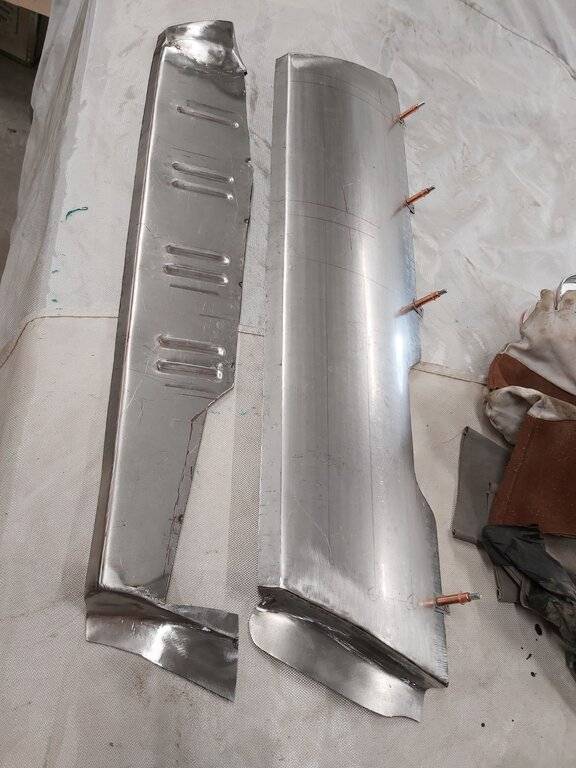

Recent progress...old dent from driver side repaired. Dent was about 4-5 mm ( 3/16") deep but now it's straight enough. I used to have old files and my friend helped me and bend them and now I have very nice straightening tool, works very well!
Right side quarter panel ready for welding and driver side I'm still working. Original panels used to have one water outlet but I think two is better than one! Btw..short "haired " wire brush is good lead remover...
Regards
Mika View attachment 402027 View attachment 402027

Thanks a lot! Like I said: for me this is easiest way to do this and yes, it's not a fastest way to do this but it's also replace some tools/machines which I don't have.

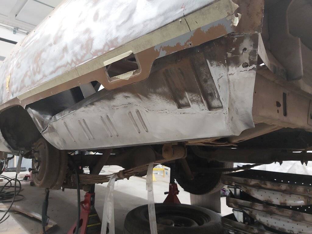

Btw...driver side waiting for welding and rear quarter panel started...
