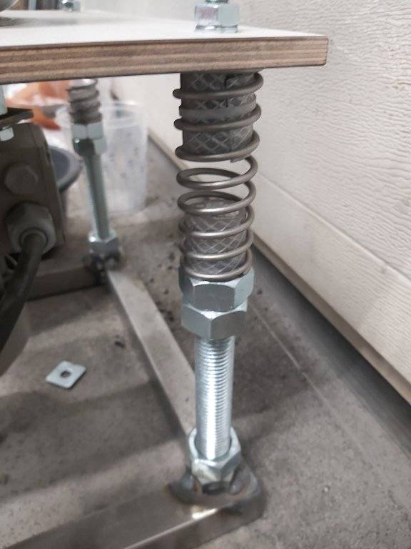

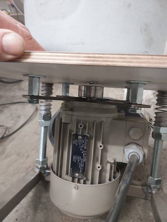

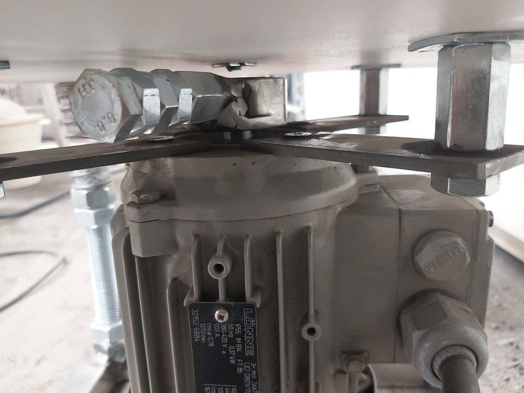

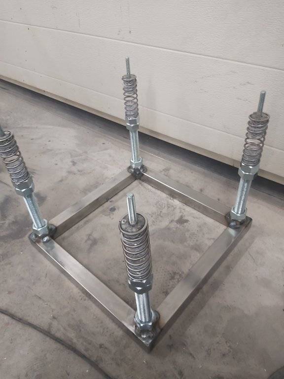

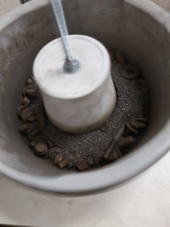

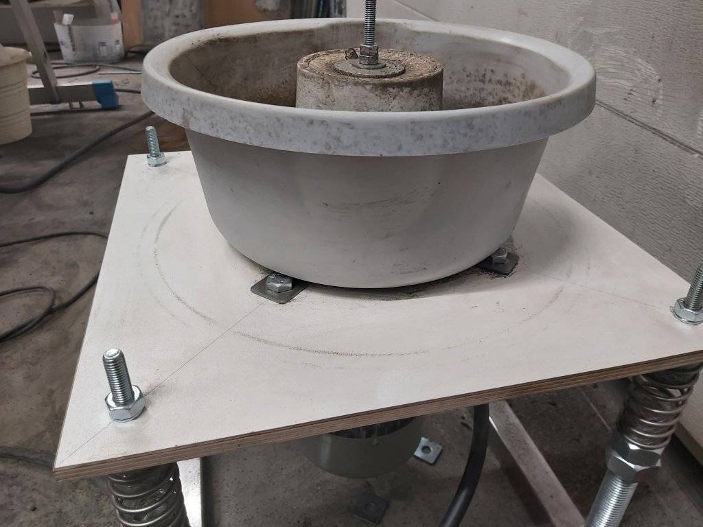

Your tumbler looks amazing! Could you show more details, please? Thanks. Lindsay

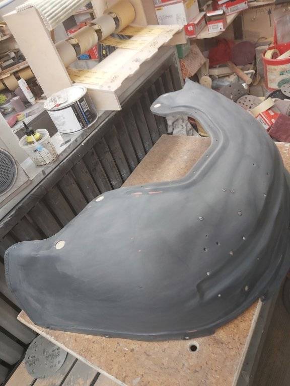

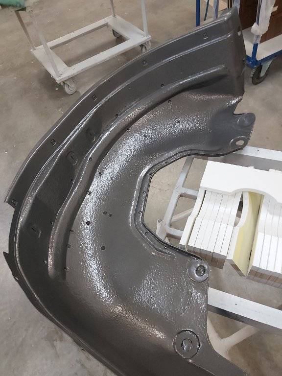

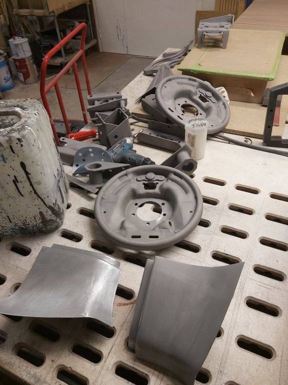

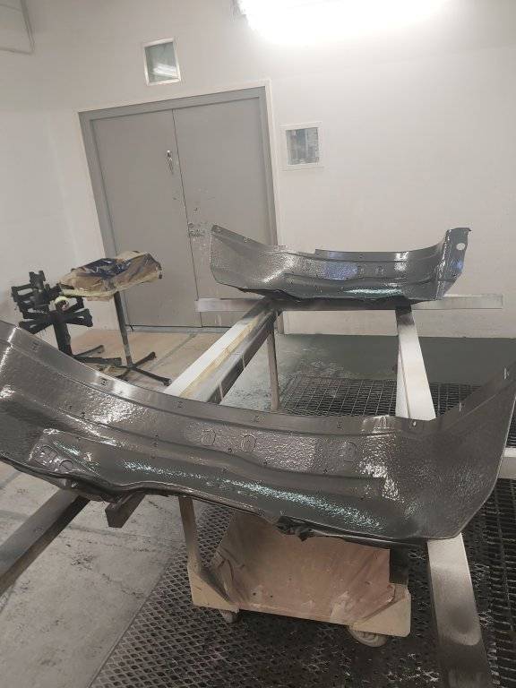

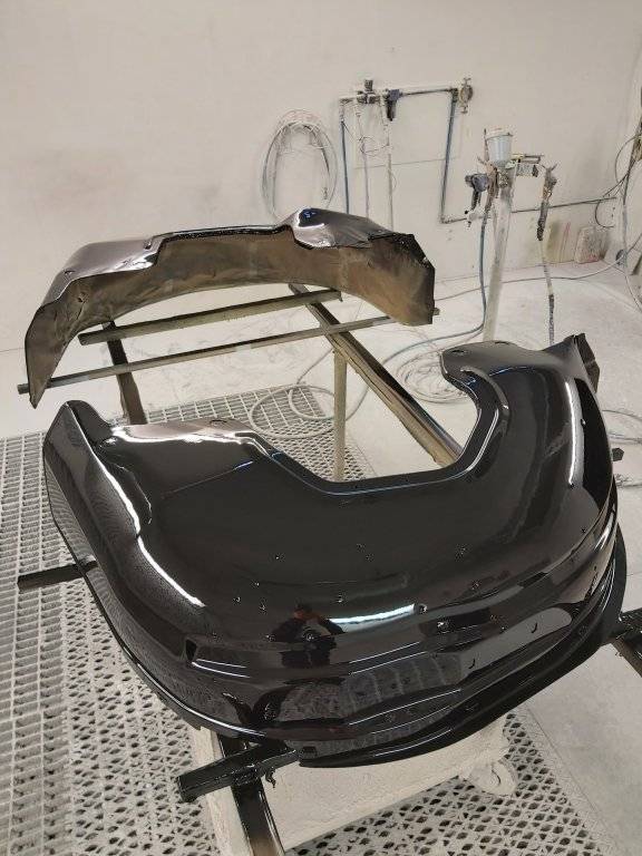

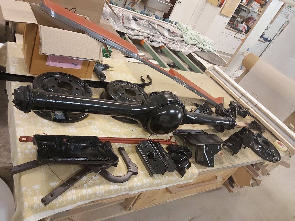

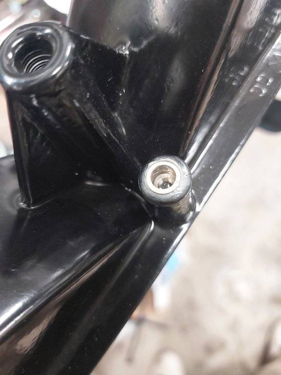

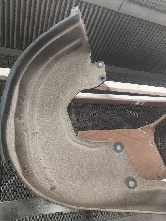

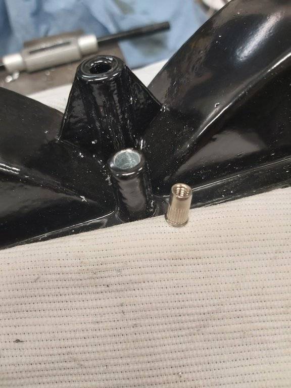

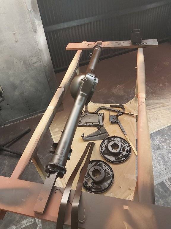

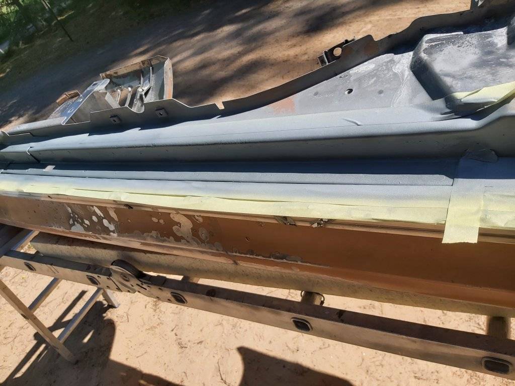

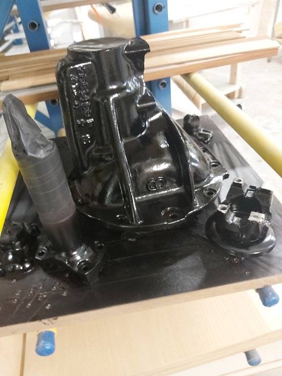

I hate you… lolAn other set of parts painted. Front inner fenders sprayed with 2 coats of epoxy and then outside with Noxudol and then semi gloss Pu. Other parts same but obviously without Noxudol..

She is gonna be a Stunner for sure when you’re finished… No my metal man my ***. Lol. Can’t wait!!
