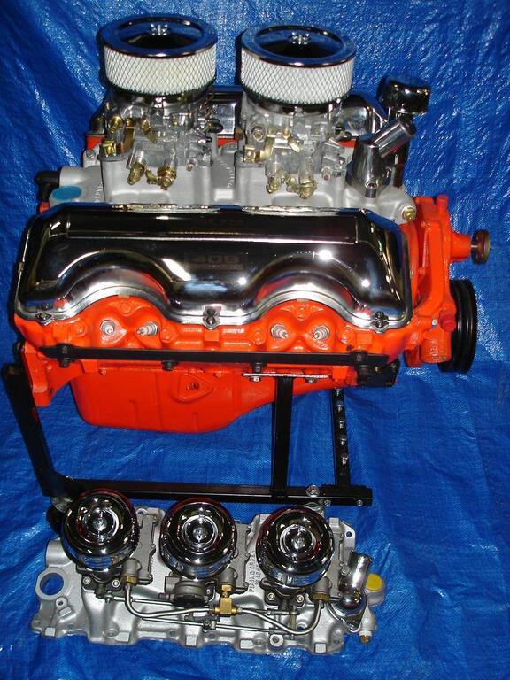

Build a huge inch 440. One of those stroked 500 inch plus strokers that makes gobs of torque. Fit it with a early 60's cross ram with the AFB carbs that sit over the fenderwells for visual effect or a six pack. There... I just saved you $20-40k and gave you a faster car that will roast the tires at will.

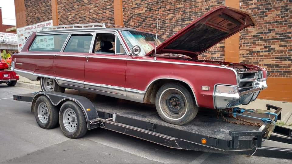

This is a VERY ambitious project. I am not going to bust your bubble on this as, "Anything can be done with time and money". I am going to point out some of the obstacles you will run into trying to do this, (since no one has mentioned this already).
A "C" body does not use a "K" frame like a "A", "B", or "E" body, They use a stub frame and the passenger side engine mount is in a different location for the "Hemi". I do believe it is in the same location as a slant 6. So you would have to work this problem out. (Change frame, or custom mount). I seem to remember aftermarket "Hemi" blocks can be gotten with both style engine mounts, but it has been a long time.

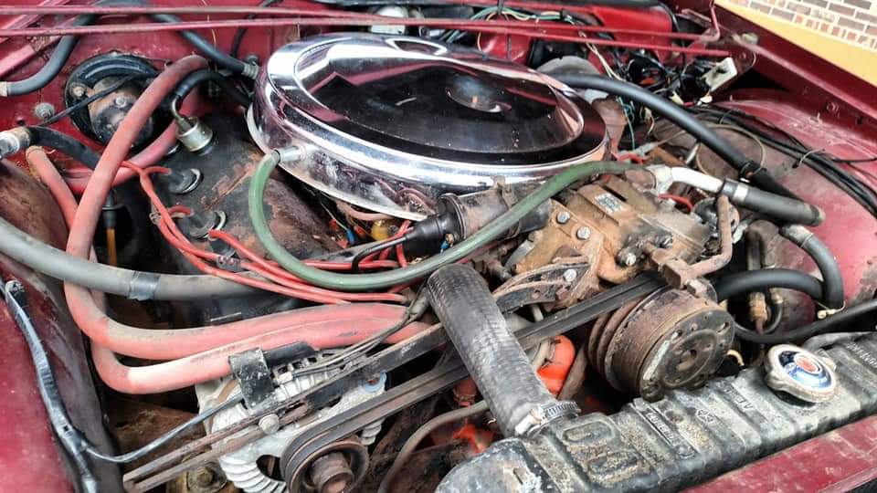

Also, does this car have factory A/C? If it does, and you want to keep it, you would have to use the new style Sanden compressor, as the factory RV2 will not clear the carbs on the hemi.

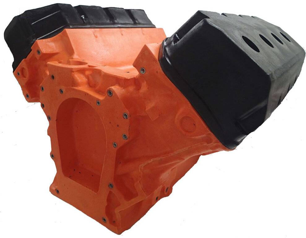

Seems like the Mopar Perf "restoration" 426 HEMI blocks have both sets of mounts cast into them, as I recall, so that 426 HEMIs could go into places they were not originally installed into? Plus thicker deck surfaces. With some structural upgrades, the newer MP blocks would usually make more power (with the same specs) than the OEM blocks would, it was reported back when they first came out. Additionally, the MP 1x4bbl intake (with recommended carb) will make just as much, if not more, power than the orig 2x4bbl intake will.
So, possibly build a MP-block 426HEMI, hydraulic cam, 1x4bbl EFI, modern ignition that looks like the orig version, and tell everybody "It's a NASCAR HEMI" as it has the single 4bbl on it.

Blocks are practically unobtanium, especially iron ones. $5000 seems to be the ballpark they start in, IF you can find one.
A 4.25" or bigger stroker crank will be the cheapest part of any GenII Hemi build.

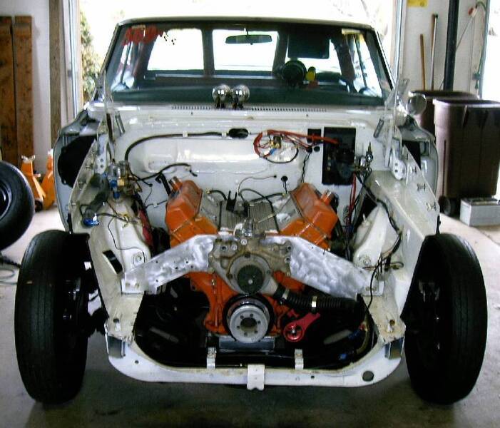

An empty engine bay perhaps one of these to start the ball. And yes more than one way to skin a cat, so to speak.
From the A body site, and no its not a hemi. so it may not apply to a c body in the same fashion. Perhaps a modification from this idea would be needed.
