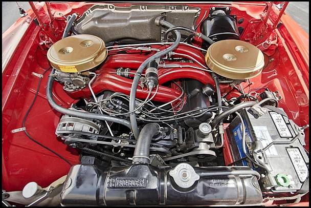

Sorry John... I have grown to hate seeing those ram manifolds in crap they didn't belong in... as much as I love them in a 300F :rolleyes:

The manifolds were available in other cars, not just the letter cars and were reproduced too. A couple different versions too. There's hacked up manifolds all over the place the letter car guys won't touch. Just saying.
I understand... I just got sick of seeing them... in a correct era car, I would think of them as a waste of money as an addition, but like them as factory. They are not a cheap date to put together right. I'm 100% positive there are a hundred better alternatives for performance on a cruising car, which covers the expected use for most of us. If that red engine bay is the one I think it is, I was bummed to see the car trailered after so many liberties were taken.

I think that really my point is there are a lot of other alternatives that have some visual appeal under the hood.
I can't say I haven't contemplated a set of those manifolds for my '70 300 every time a set comes up for sale. I think and dream a little, then I lay down and rest until common sense comes and takes those thoughts away.

I wanted to use a set on something since the 80's, but between the prices climbing and then starting to see them on cars that would only wind up less driveable/much more hassle to maintain and utterly incorrect... my temperature cooled a lot. That is still my all time favorite induction system, but I won't be putting one on anything I own. I love the story of the 300F landspeed cars and Tom Mchale's write up of the cars in Mechanics Illustrated.
