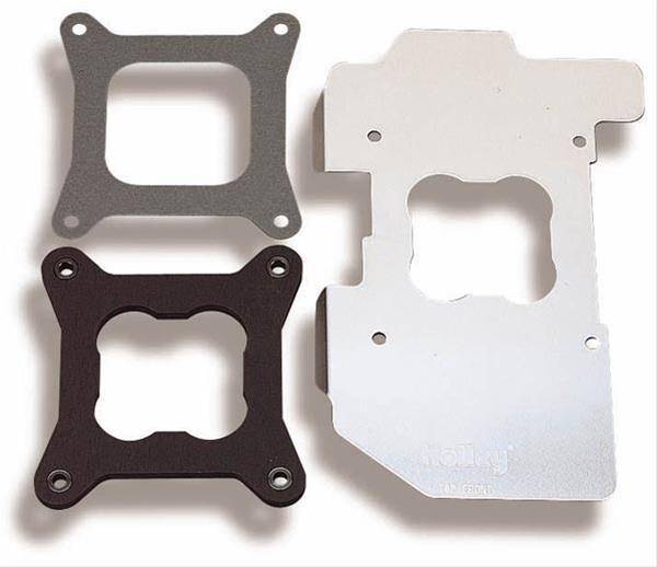

Get a heat shield or a spacer.I California we are not as worried about the cold as we are the hot. With todays gas the heat crossover will boil the gas and can cause the car to run bad, particularly on warmer days. Again I'm not a mechanic and I put this in my best layman way.

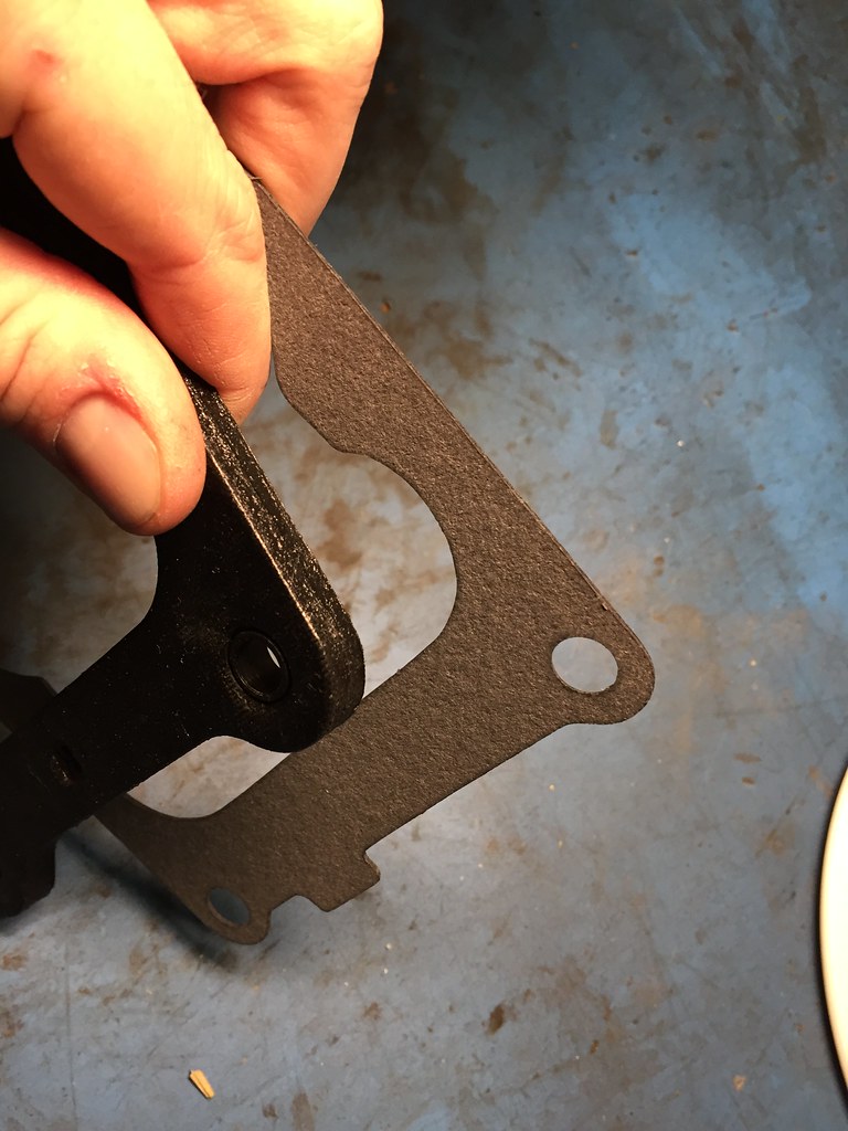

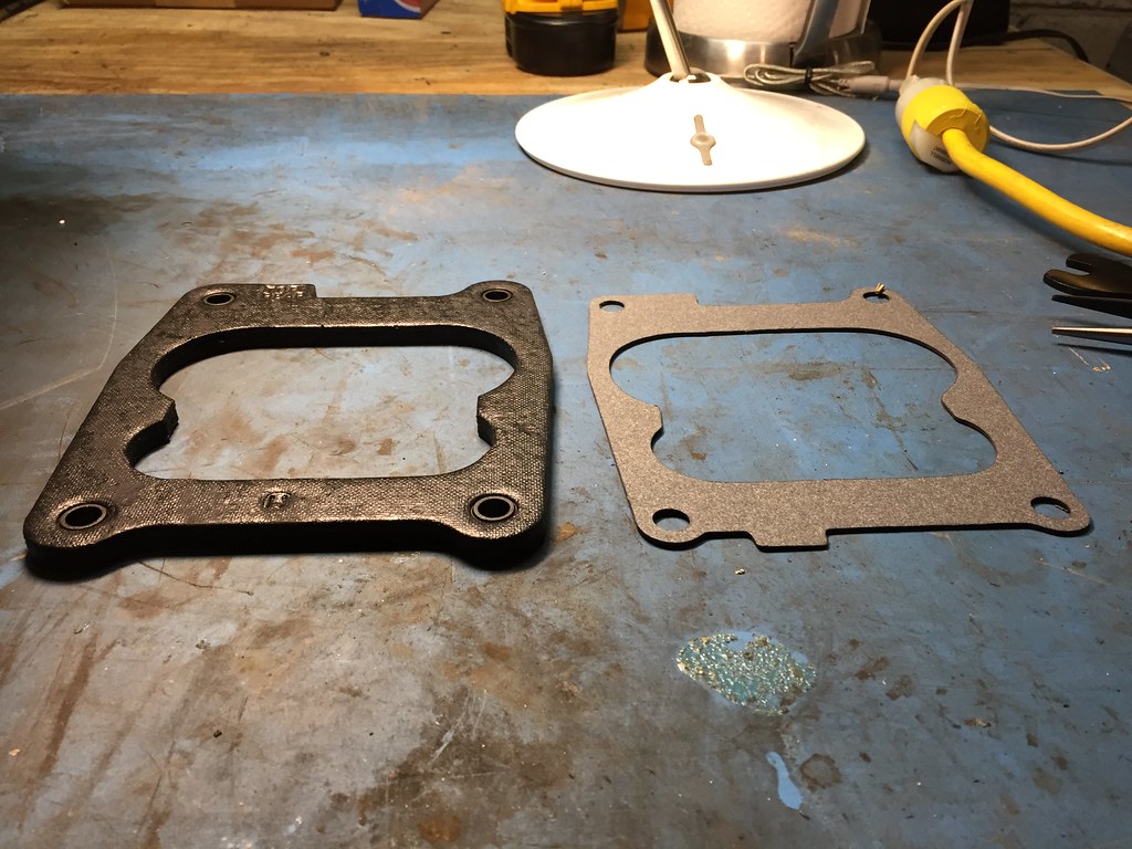

The choke is adjustable and you may also have to adjust the trans kick-down rod.So I noticed my rebuild kit came with a few thin normal-style paper flange gaskets, and a real thick one probably 1/2" thick. Which one should I use? Guess it'd depend on the actuation of the thermostatic choke rod. 1/2" difference would throw off the operation of the choke...

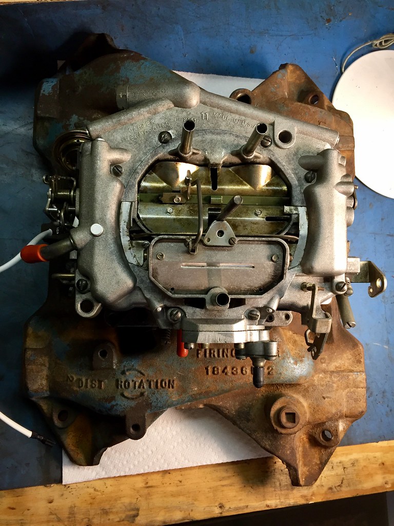

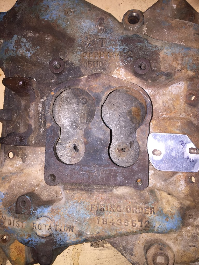

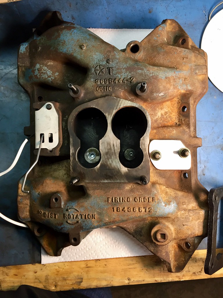

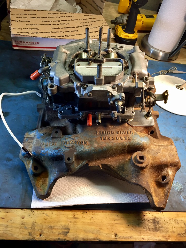

67 Fury with a 400. Currently 2bbl Stromberg. Upgrading to a Thermoquad. I got a Thermoquad manifold, and noticed two ports that go from the exhaust crossover and exit directly under the carb. I made a blank-off plate for the EGR. Can I just tap and plug these holes or do they serve some purpose?
Thanks in advance,
-MK
