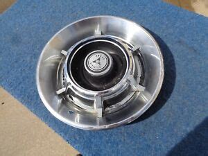

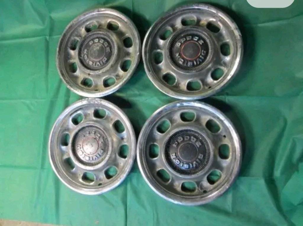

These are 15's and I do like the style.. on ebay, they want $100 and an additional $60 to ship.. I don't think so, but I like the look.

Your decision to use 15" steel rims will depend on if you have hubcaps for them that you are happy with, or maybe they are the type of rims that don't have hubcaps (like magnums and I think also "road wheels"). If you have the hubcaps that you want, or if that isin't an issue, and you already have the 15" rims and they're clean and the beads are not messed up (or you'll rehab them anyways) then I would say to use the 15" rims and buy new tires for those. Presumably the rims are all the same width, 6 inch at least or 6.5 inch. I'm saying this because you have more options with 15" tires, more size options that will be exactly what this car wants. You can still keep the 14" wheels and maybe you'll put some new or used rubber on them, maybe not, but possibility is there.
I faced the same decision, I have a collection of 15" rims, I might have needed to get one more for a complete set, but I didn't have a good lead on reasonable hubcaps. But I have a lot of 14" hubcaps in good shape, and the 215-75-14 tire size is close enough for me to the 'real original size", so I went the 14" route. And while doing that I stumbled upon some 14" magnum rims in good shape for $50 each so I bought them, and that's what I'm going to use for the new tires.

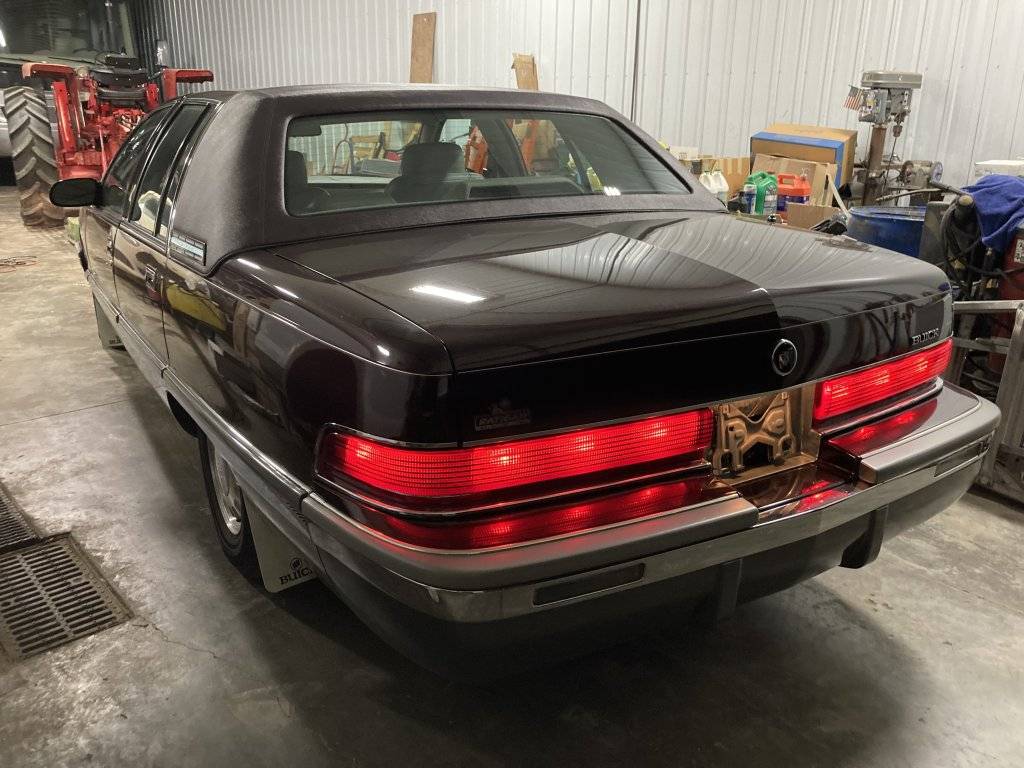

We love our 95 Roadmaster Limited, with almost 60k on the clock. I have one more window roller set to replace and the car will be completely functional and man o man does it ride smoothly!
I do like the Buick Roadmaster wagon. But with 300k on the clock, it's getting a bit long in the tooth.
In other words, it's plum wore out. It's falling apart all over the place.
No rust, uses no oil, gets 16 to 24, 0 to 60 in 8 seconds. Go figure.
