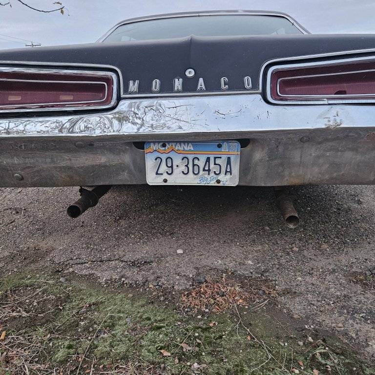

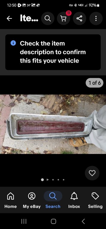

Can someone help me with these taillights? I need a pair and the first one pictured is listed as "passenger" side for a 67 and the second one is listed as the "left" - driver's side, however they don't look like they'd match. The third photo is my car.
I've purchased the left side one already and hoping it's going to work.
-Chris

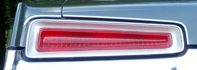

There are 2 styles of tail lights for the Monaco / Polara for '67. The difference being that one has a narrower metal bezel surround and correspondingly larger red plastic lens. The second has a wider bezel with a smaller (by area) plastic lens. This is a photo of the second type:
You would not see this lens on a US Monaco, only on US Polara's. In Canada, this was a common lens found on Monaco's and Polara's. The inner portion of the bezel has a frosted finish to it, and the lens has no chromed ring. The other lens (what technically is a "Monaco" lens) I believe has a chromed ring that is part of the plastic lens.
I've never actually been up close in person to a car with a real Monaco lens so I'm not exactly sure if the ring is chromed plastic or a metal chromed strip bonded to the plastic. In Canada, I *believe* the rule was that they put the real Monaco lens on Monaco convertibles and possibly on Monaco-500's.
It's my perception that the Polara lenses were thicker or at least molded with a shape or contour that made them less prone to puncture / damage.
I was reading it ad a Monaco.. that's where I went wrong eh? I'm glad the one I purchased was the correct one.

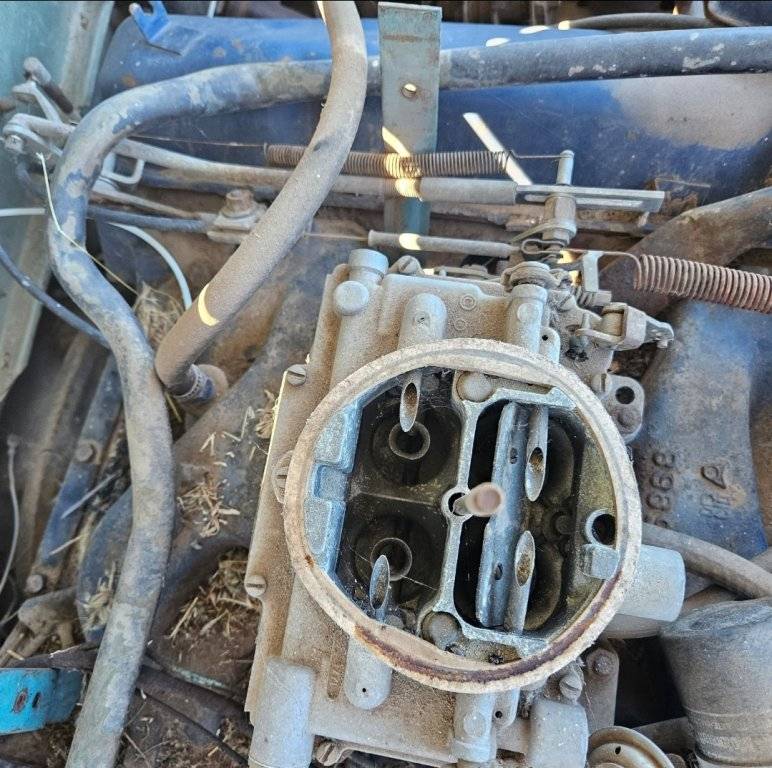

One thing baffles me. I have a '68 Polara 500 vert with an "H" code 383 mag (buckets, console). I thought to myself that this was an excellent buy when the "H" on the VIN. Then I saw a pic of the engine-definately not a Magnum (and probably a 2bbl). Did Chrysler change engine digits on VIN's between '67 and '68, or has someone swapped the original Magnum for the current engine?
What's the pic look like? Should have the 383-4 under the hood

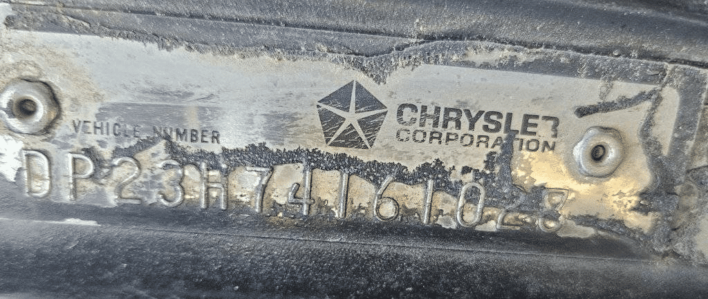

I'm trying to figure out why you're using my vin as your example?
W
What's your Vin #?
I haven't verified my engine number yet, I'm waiting on tires to show up so I can move it. I'll give an update though.. as well as some "clean up" shots as well.
