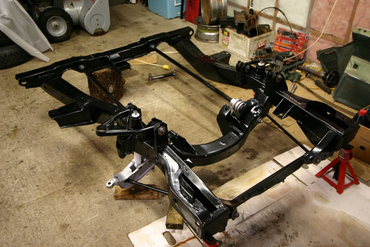

Some visualization may help.
Like what was said, anywhere from the front crossmember and forward.
As you can see, the front stub frame (no K-member) is as rugged as a battleship.
Whao whoa whoa.... Where'd those tubular UCA's come from?
