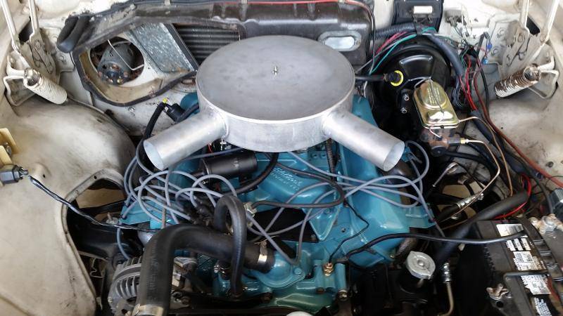

Opinions please. My factory air cleaner does not fit with aftermarket carb and spacer and I am not a fan of the die cast mopar one. So I made one myself, dual snorkel look dumb or not? I will be painting it black.

looks awesome
careful, you might have to make more for others :)
are you going to hook up some cold air feeds to it? if not a flare on the openings will greatly improve the breathing on those pipes, what size tube are they?
600cfm edelbrock, I also left a 1/4 inch air gap around the entire bottom of the cleaner.
i know my single nose snorkel (stock one) chokes the hell out of the motor, and its just an OEM 2 barrel. i had to dial the carb way back, and tune it with the snorkel on.
cut a trap door in the base of that thing you made or something. but i think the craft of what you made is killer. id put bigger snouts on it - like 3" i guess, if those are 2.5" let it breathe

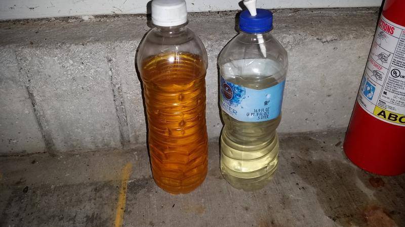

Long story short, stabil sucks and does not work. Had to suck out fuel tank and blow out feed line. Rebuilt carb and finally finished it last night. Got the motor fired off last night for about 30 seconds before I shut her down. Sounds good. Tranny pan is leaking so I fixed that tonight and let cure till tomorrow where I will do the initial break in. Hopefullly I will remember to get some video of the process and post. Wish me luck. Picture of old gas and new. I poured the old gas into the fire pit and lit it with a lighter, it lit like napalm jelly.

Jake, how old was that fuel?
Added stabil and filled it up last fall and ran around town with it for about 40 minutes before putting her away. I double checked the amount of stabil and put the stabil in before I filled it to make sure it mixed good.
