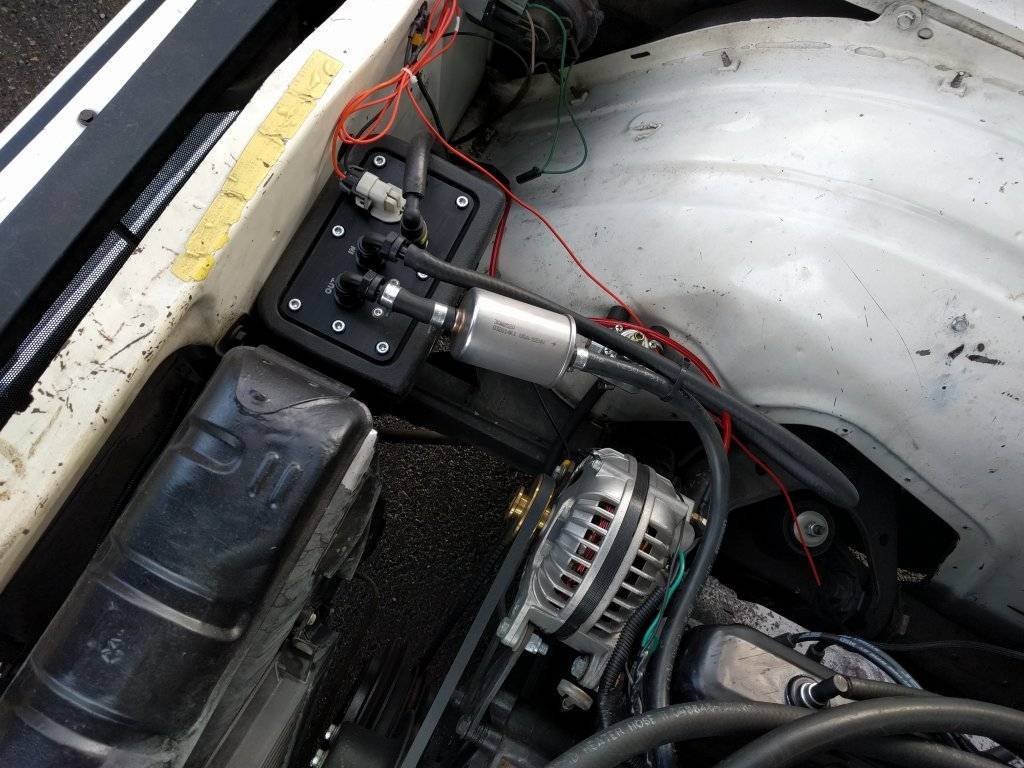

Got any pics of the install especially the command center pump unit in the car?
I used the Edelbrock pump... Let me go take a pic....

Thanks for posting pics Knebel. Nice job. The command center seems to be a different shape than the round one in the factory pics. Which I think (yours) is far better for a good install.
thank you.
Yes, its an Edelbrock fuel sump for EFI. I thought that looked a bit more stealth than the FITech unit. Plus the FITech command center was on backorder for a year or so. I will be figuring out some different way for the fuel lines and the fuel filter but for now it works pretty good.
That was one of my biggest concerns with the FITech command center. It looked bulky and cumbersome to install and I had no idea how big it was to boot. Looks much better than I expected the way you went about it!!

dsc_0163-jpg.114722
I know this looks clean and pleasing to the eye... but when you rework it please think about high pressure fuel spraying all over the place and try to minimize the risk of fire. I mean nothing I say as disrespect. Right now a frayed belt could open that hose pretty quickly, and the fuel spray directly towards the alternator and exhaust manifold. In a front collision, you would have a pretty high chance of fire as well.
Some ideas, find a nice place under the car. Try to separate the module from the exhaust, perhaps by placing it on the other side of a rail. Look into some kind of skid shield to protect it from road debris and maybe act as a heat shield as well.
When EFI was still new to many manufacturers there was lots of concern about fires in crashes. Ford used a manually resetable inertia switch to kill the pump in an accident. They have been in use from the early 80's to recent models... so the junkyard has them. The newer ones are an input to a computer and are not suitable to wire directly into the pump circuit, the older ones are bigger wires and could be used to disable the pump quickly in an accident, but your system will still act as an accumulator and have fuel to spray for several seconds after shut off. I can dig through wiring schematics to find older ones that would handle more current, but you could more easily just look at the wire size if you wanted to grab one and a pigtail from the junkyard. You may choose to wire it into the control circuit of whatever relay is running the pump to assure you don't overload it.
Your current plumbing is too much rubber, but I think you know that. Try to run a steel line where the original ran as much as possible... I know it will be a hassle, but the location behind the alternator bracket kept it away from the exhaust manifold and protected it from anything that happens at the front of the engine.
You make a good point. I haven't even thought about it that a belt could tear the hose! Thanks for that! Too much rubber, yes, I know, I have a imaginary "to do" list and on it is, getting rid of that pressure regulator and using metal fuel line to the reservoir. But I also have on my list an aluminium radiator and 3 point belts for the backseat (just finished a 3 point belt install in the front) Then eventually some steel braided line to the EFI. The pump is controlled by the EFI computer and I believe there is some sort of shutoff but I am uncertain how that works. I know the pumpflow is controlled by what's demanded. I am definitely concerned about that. Would it make more sense to run a braided fuel hose from the pump to the EFI..Let's say... along the top of the fender? And maybe shielding it somehow ?

dsc_0163-jpg.114722

I see what you mean Cantflip. Very valid safety points you mention here.
I will be most interested what you come up with Knebel.
How about... I don't crash my car? Nah, just kidding. Those are some good points, I feel like I thought about putting it on the firewall but there was no room... Hmmm

I'm sorry Bob... I'm not really that hard to get along with, but I just can't in good conscience keep my mouth shut about something I see that could hurt someone. Once I have pointed out a safety issue and maybe helped with a solution, I go back to enjoying the car. Not everyone spent a career looking at this stuff from the same perspective... not even in my industry, it may be the only true value I have to offer the masses.
Yes, please don't... we all would feel that loss (not as much as you). Thanks for understanding I wasn't meaning to nit-pick your car. I have a relevant question, does it matter how you orient the module or how close you are to the injection unit? I wouldn't think so, but I haven't done too much research on these systems.
If you could find a spot closer to the tank, you should be able to minimize the risks, which is all the factory really did in their systems. Finding a junkyard shield or fabricating one shouldn't be hard, I would even donate a chunk of 11 gauge sheet steel if you couldn't find something you liked locally. I like the auto shutoff feature, but if you keep it at the core support, I would at minimum consider the inertia switch idea. The reason is your system will have enough pressure/volume to spray fuel for up to a minute-ish if a small hole is made... adding however many seconds to that IF the engine stalls, and possibly no shut off if the engine stays running. I would mount the switch right by the module so it only trips when there is a shock close enough to damage the fuel system.
I think the bulkhead would be a poor location due to the proximity of the exhaust, aside from not having space if you keep the blower motor.
I don't know the dragstrip rules, but someone here told me you can only have 6" or 12" of rubber fuel line showing or you wont pass tech.. that's what I kept in mind when plumbing fuel lines.
+1 for stay away from heat and spark sources, and try to stay inside the frame rails with the fuel line run.
also - somewhere in this forum I have a post about wiring in an oil pressure kill switch to shut the FP off... you lose oil pressure and it kills the fuel flow. you can also get a rollover switch out of a tarus or something, they are mounted in the trunk and wire up inline..
