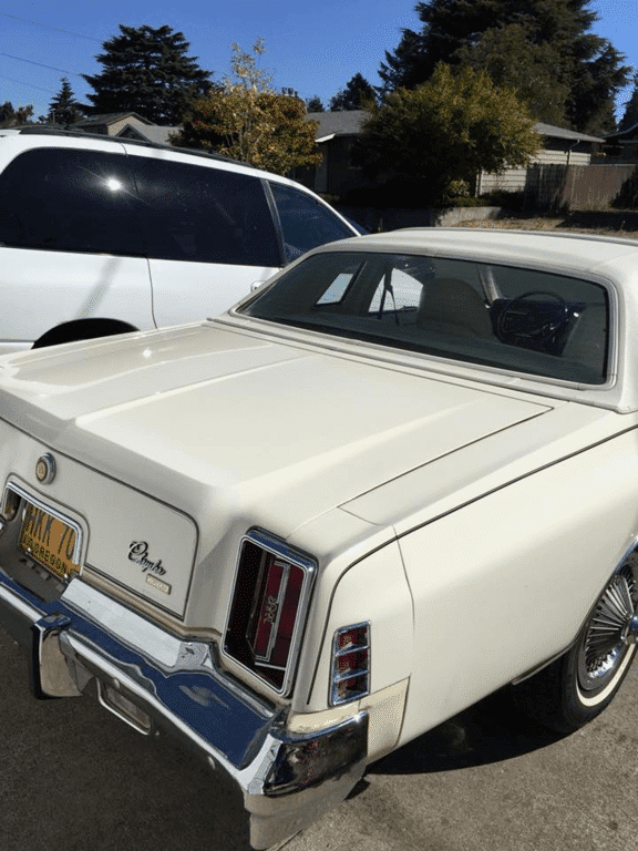

  5. Photos are from the previous owner.
Thanks for the pictures and info. A nice looking car!
