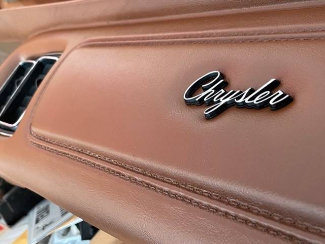

Work has been progressing, but as most of you know, you pick at one thing and eventually you have dug yourself into a deep hole! I removed the dash pad because there was a faded area. I had the color matched and dyed it back to its original color. While that was out, I figured I might as well take care of the leaking heater core (a difficult but not impossible job with ATCII). Then the 8 track didn't work, and the gauge needles had faded, and, and, and...
So... the heater core is replaced, the evaporator was tested, the box is back together and installed. All of the vacuum lines were checked and are back where they belong. The A/C system has a new expansion valve and O-rings. I replaced the 8-Track's drive belt, painted the gauge needles, cleaned everything, and used a chrome pen to restore the vents, instrument faceplate, etc. A door lock actuator was bad, so that was replaced with an NOS piece. The right side remote mirror was pitted, so I found an NOS manual mirror and swapped the mirror and cables into the housing. All of the power window switches are new. A few things need attention before I can put the interior back together but, once that's done, everything will work and I'll move on to the exterior.

I found them at Hobby Lobby and my local hobby shop.
I’ve used chrome, white and black to touch up small details on dash often.

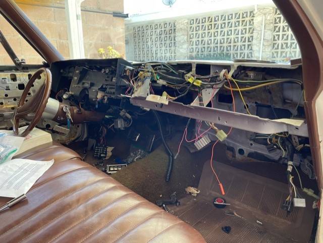

I've been busy. Everything works, except for a short in the tailgate lock wiring. The driver side windows don't work, but it's probably due to the dried up grease. I'll get started on the last of the electrical gremlins and I'm looking forward to finishing it.

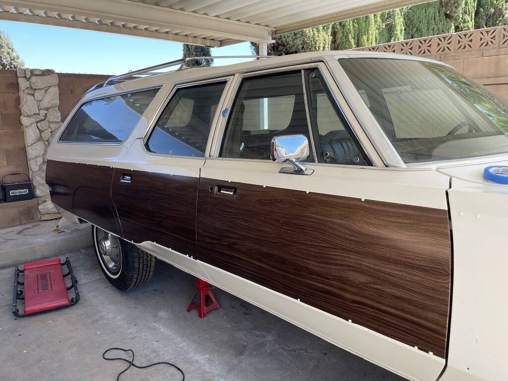

It has been a busy summer. I repaired the dents and dings, repainted the sides, and have spent a few days installing the NOS Di-Noc wood. I have a long way to go, but I’m seeing some light at the end of the tunnel.
Yes. Spinnaker white. Most of the paint is still original. I just took care of the panels that had damage and were behind the wood. Thanks!
Where did you find enough NOS correct woodgrain? I tried to find some for my 1969 T&C and came up with only one roll and it wasn't cheap!
Beautiful work!!
It sounds like you are in the Los Angeles area, so I am hoping to see your wagon in the not too distant future down here!
