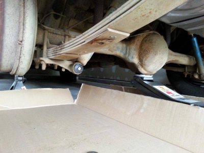

Started changing out leaf springs and rear shocks early this morning. Got a lot of good intel from 70Nwport's thread about doing the same thing. Thanks very much guys.

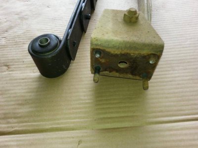

However, I already screwed something up: I sheared off one of the lower shock mounts. I PB blasted everything over the course of a week but it didn't resist at all, just twisted off as soon as I pulled on it. Looks like it is integral to the shock plate. Is there any way to just replace that bolt/stud, or do you have to get a whole new plate? What would FCBO gurus recommend?
For today at least, I am thinking I will have to go forward and try to get everything switched out and bolted back together as best I can so I can close the garage, and then try to replace or repair that shock plate some other weekend.

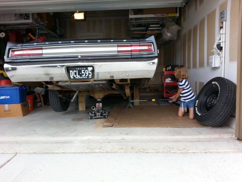

EDIT: rest assured there is not just a floor jack there, especially not with kids around. Also wood blocks and jackstands.
I HATE it when that happens! Drop the Shock Plate and using a Skinny Wheel Grinder flush off stud. Center punch for new bolt hole. Drill hole insert bolt from back of plate. Weld in place.
I would have replaced the whole plate BUT if that's the correct bolt..... just swap the bolt.

Ok folks, I have the springs and new shocks in the car but only assembled, not tightened up for real use. I ended breaking off studs on both front hangers and shock plates. I can limp it somewhere carefully if I need to but it’s not safety drivable any kind of distance or speed.

On the front hangers: polara71 mentioned he hadn’t seen that. You know, it’s weird. I PB Blasted everything the week before, and they don’t really look that rusty, and the metal still looks ok, but they didn’t fight too hard. I was using a sh!tty little cheap ratchet with a handle maybe 10” long and they just came apart.

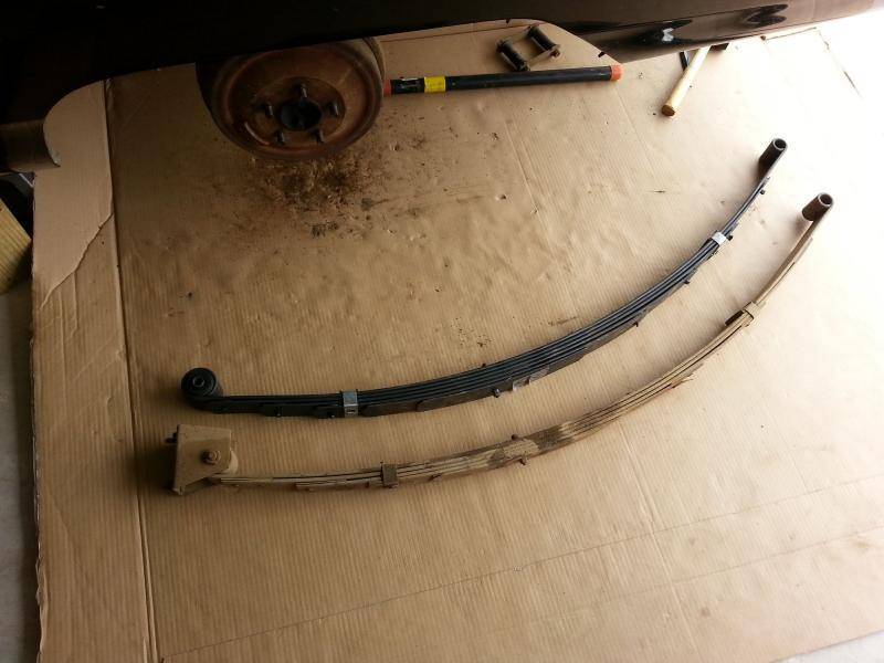

I was a little surprised at the condition of the springs. I've seen other folks show their old ones side by side with new and you can see the flatness of the old. But these look identical when you line them up. Clearly they are a little weak -- the car sits an inch or so higher now -- but the old ones are still better than I expected. I am thinking maybe I should have had them re-arched. Oh well, 20/20 highsight.
