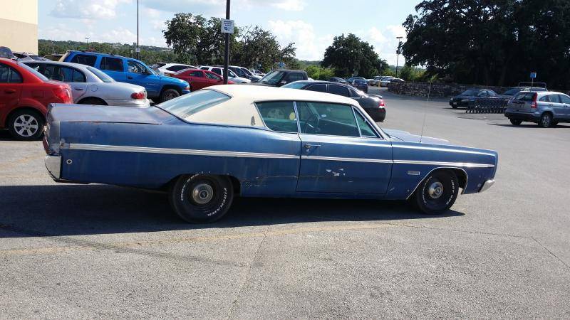

I got them from General Spring in KC on the advice of Jason/68plymouth383. I wish I'd gotten a little more arch because my car came out closer to level than Jason's blue car above.
