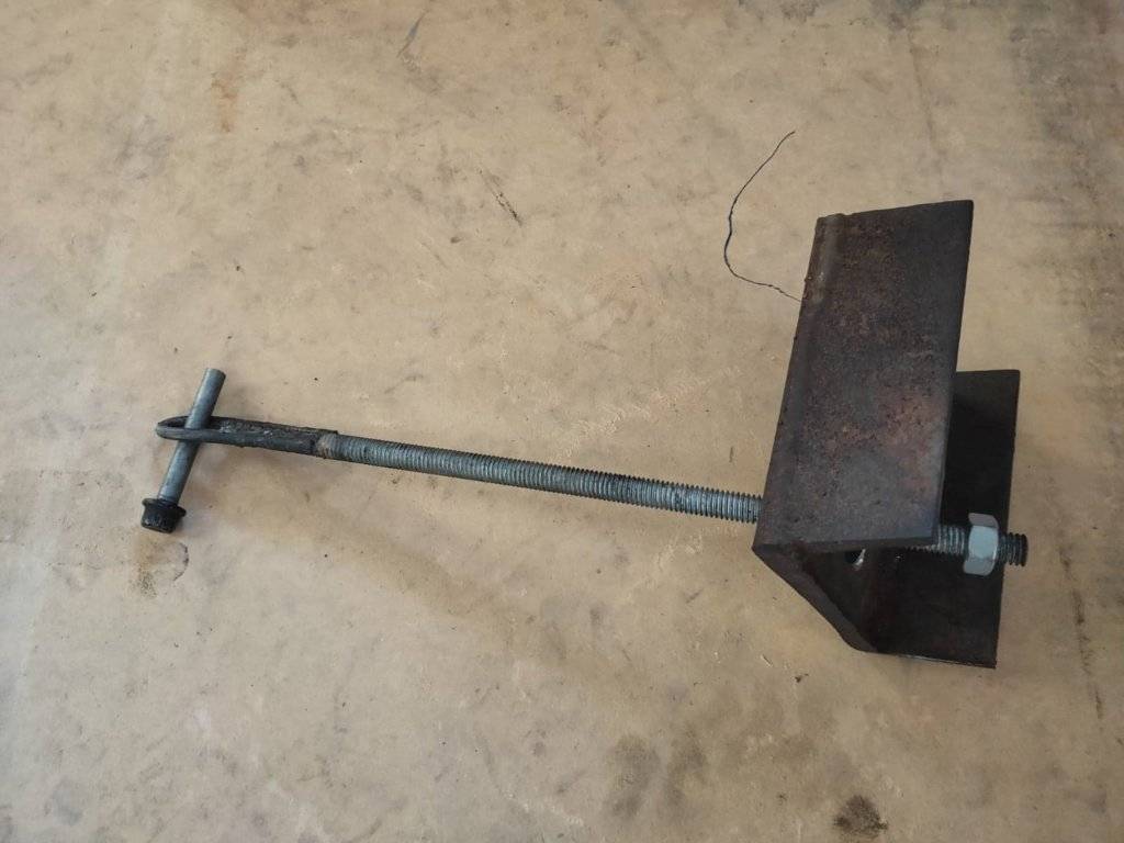

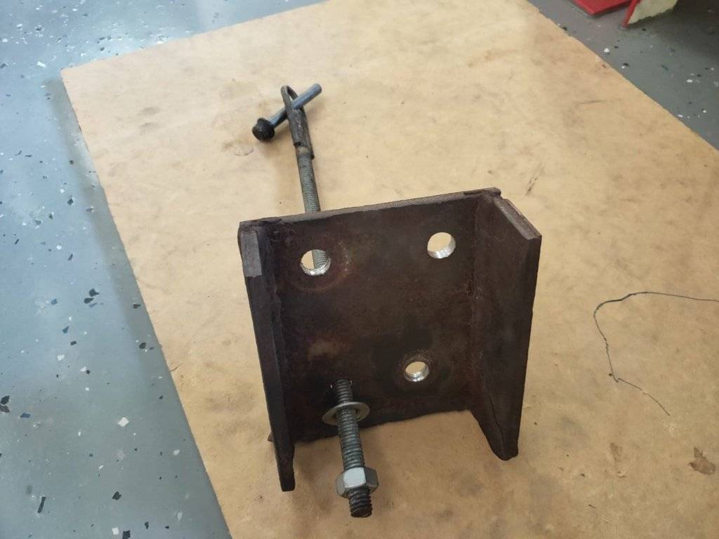

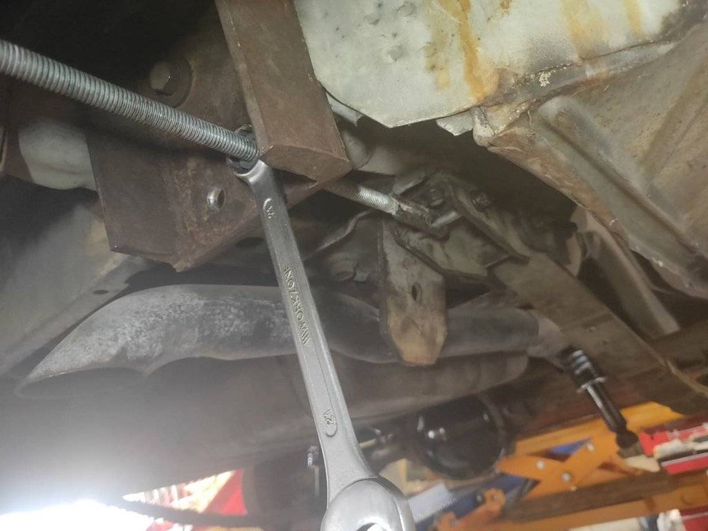

Leaf spring spreader tool
Did the springs on my ‘75 Monaco without any stretcher or special tools... Came apart without loosing any limbs lol.
I used a ratchet strap during re-assembly. I attached the rear of the springs first and pulled the front up to be bolted in place.

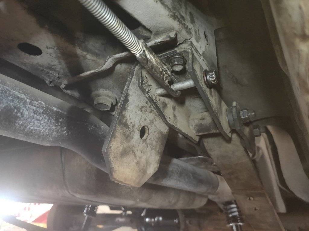

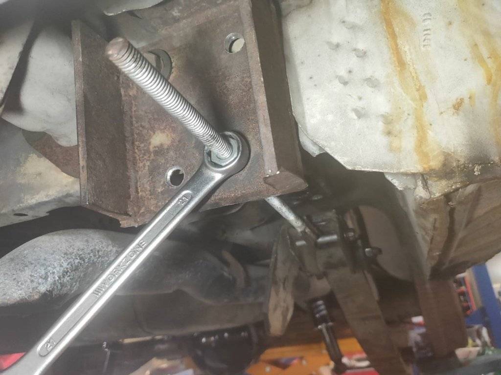

so, it looks like you are pulling the spring to lengthen it so the upper bolts line up? did you need it for removal and installation?
looks like a well made tool.

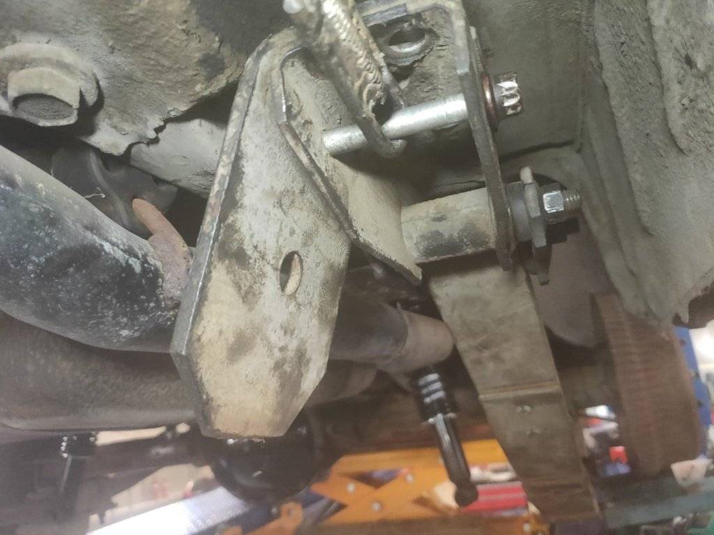

Looks like you're working on a 4 post lift and have a jack or you're supporting the rear axle under the drum with something. I wouldn't recommend doing that. It can cause all kinds of problems.
I don't think he has the rearend supported in anyway, hence the need for the tool. I can see the reason/benefit of the tool now with pictures. There must be a lot of arch in those formal springs due to weight. The front springs on my 85 Pete are a stack and a crazy arch you will never see unless it comes off the ground, but made it difficult to get the shackle side bars to the pin, bottle Jack and a C clamp got me lined up. It's just different approaches.

not something that i would do, but on it's merits: it's an easy tool to build with scraps from under the chop saw bench and it works perfect for the application. i can't argue with that. thanks for posting.
