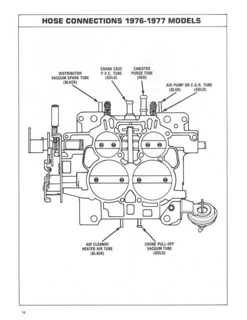

The carb can still be used even if it does not have the port in the diagram, ck for full vacuum at idle or vacuum only when the throttle opens(ported). I thought the lean burn computer had a vacuum pod on the side of it? I am not sure about 77 but I know later models had it
