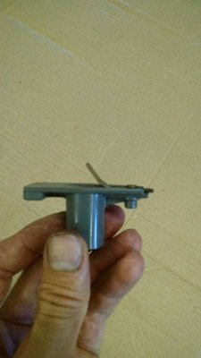

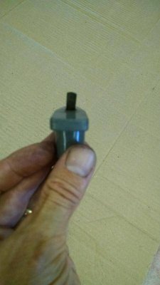

I forgot to clamp the distributor cap down a few weeks ago and it jacked the tab up on the rotor where the rotor meets the top of the distributor. IMG_20150815_125659460.jpg

Great advice guys! Maybe your distributor cap needs to be inspected more closely after the dance it did.

The ignition problem could be a lot of things.... If you are still using that rotor you need to replace it obviously. Check point gap etc. If it continues, think about bypassing the wiring to the ignition switch with a jumper from the battery to the ballast resistor to test it.
