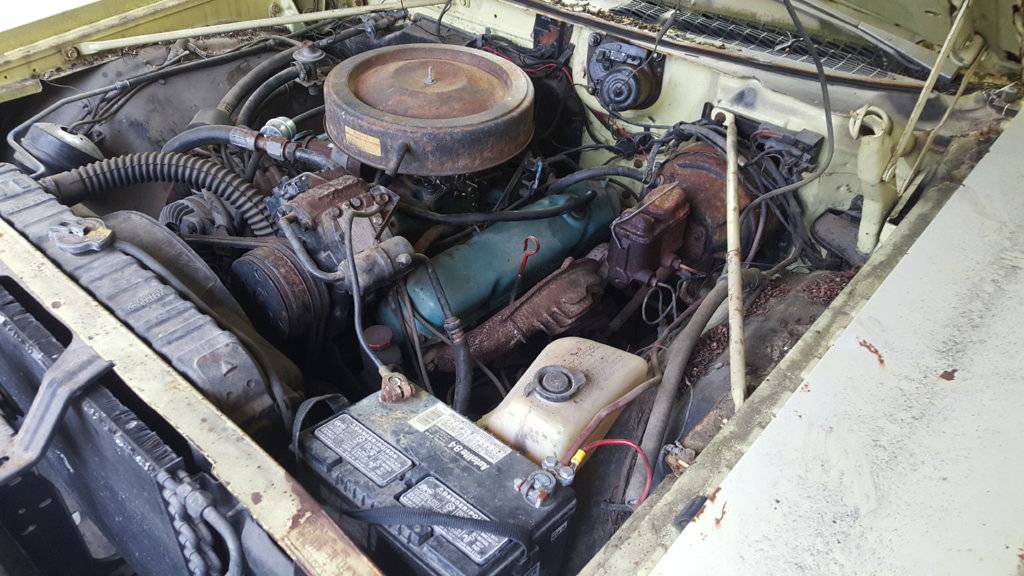

And good luck finding that stove, as mentioned, it's 70-71 only, and C-body only. I have never seen one a loose one for sale, and most manifolds have them gone. For this reason I prefer 68-69 manifolds, which are cleaner/smoother.
And that pic of Critter's/Wolfen's shows an easy way to ID a 70-71 HP manifold when in the car, when the pictures aren't clear, or at a non-ideal angle - if the hot air pipe is between #1 and #3 exh ports, it's an HP. The non-hp log manifold has it poking up right at #1.

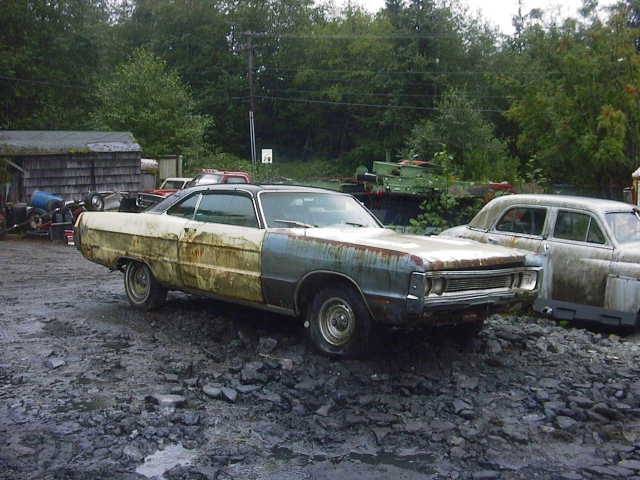

yes the car is fine.. but needs a huge restoration..the exh manifolds are the same as any 440HP C body [just remove the shield]... it will be restored one day..
