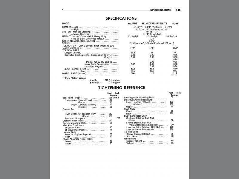

What is the correct height? The FSM specifications are like this, is that denotion 1 foot and 3/8 inches? it says inches, but 1-3/8 inches sounds low... on the other page it shows 2 places to measure, A and B and of course in the specs it does not refer to those.
