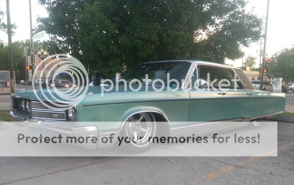

i dropped my 68 new yorker 3 inches by changing to a low profile tire
