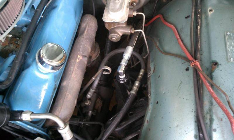

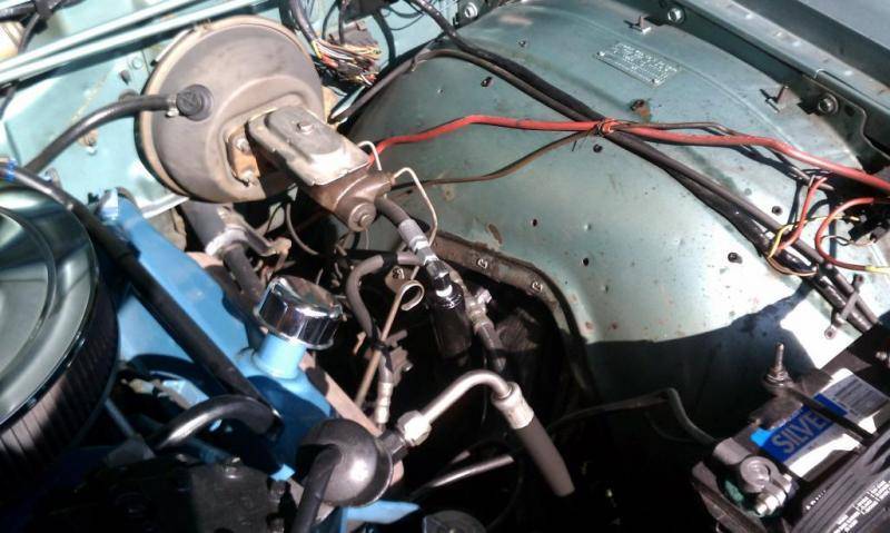

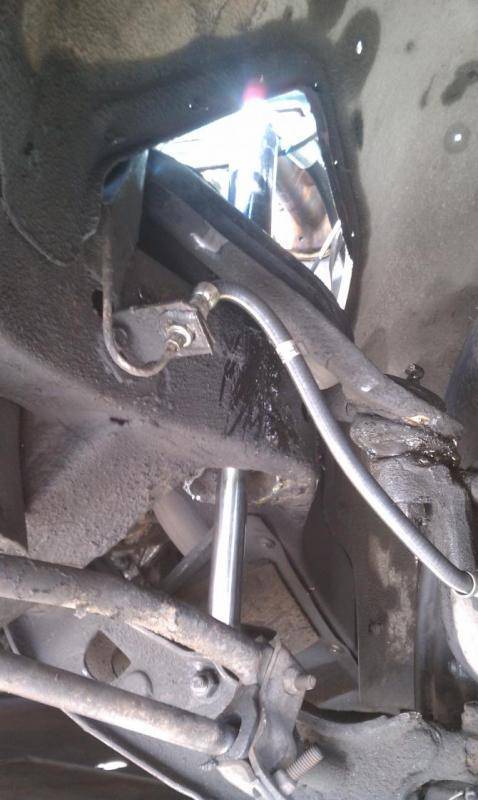

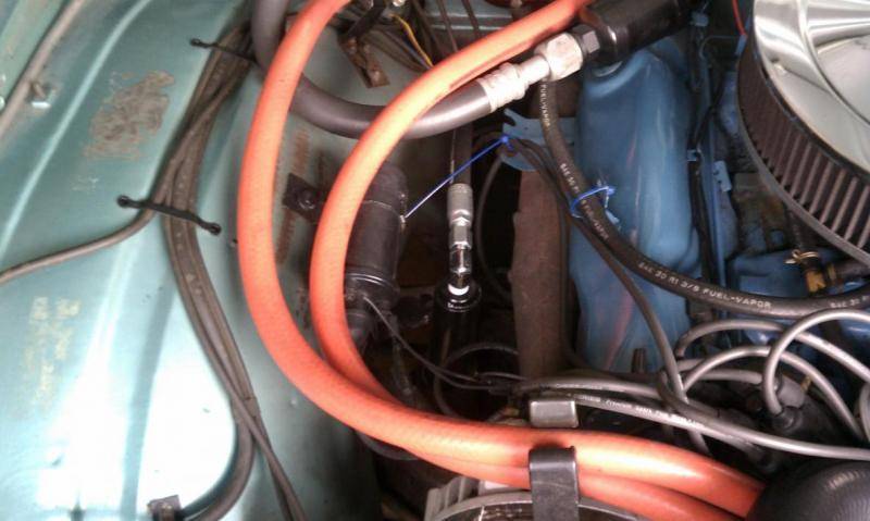

In my world "bumpstops" are removed within minutes of owning the car...hehe....but here's the front end and some others.
So you had to cut a bigger hole in the upper shock mount. Any other cutting on the front end? Did you end up pulling out the torsion bar adjuster or just back them out a lot?

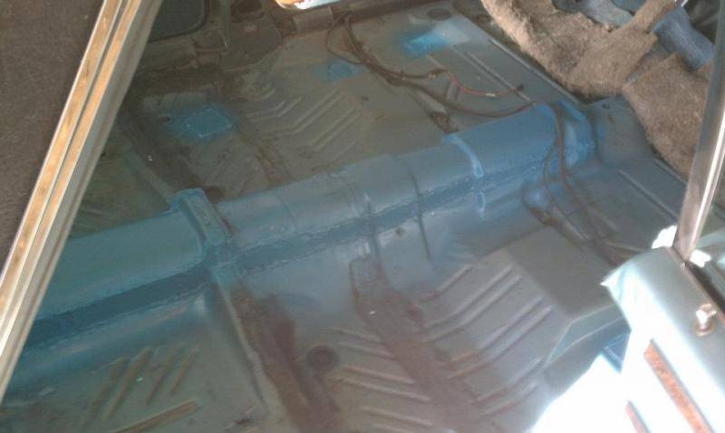

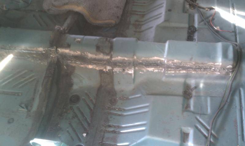

When I read the post on the other forum, I noticed you started with posts about the driveshaft tunnel. I can totally appreciate that. My car isn't lowered (aside from sagging springs), and I have bright metal above the rear u-joint where it's rubbed.

Well got looking at this a lot today and think I may go the route of air shocks. Don't have to worry about batteries that way and just have to use a small tank and compressor. Cutting and welding the tunnel won't be bad and just have to make sure the diff clears. Most of the fabbing will be in the trunk for the rear air shocks.

Air shocks will bolt right in the stock locations in the rear. My car sat pretty low with the air out and 3" lowering blocks. If you're going to raise the driveshaft tunnel, the upper shock mounts will need to be relocated. Then you might have to do some sectioning out of the rear hump thats over the axle & frame. Keep in mind that if you pull rear leafs to get lower, it's a ***** to raise the car on airsocks. My compressor at home with 100psi wouldnt lift it. And airshocks wont work in the front.
Baja......Yes, the top of the shock mount where the shock stem poked through was removed for the hydraulic cylinder. All of the bumpstop bracketry was removed along with the adjuster bolts. The torsion bars are still in place, but serve no purpose and the top A arm was notched to make room for the cylinder when the car is laid out.
