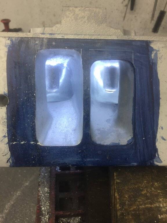

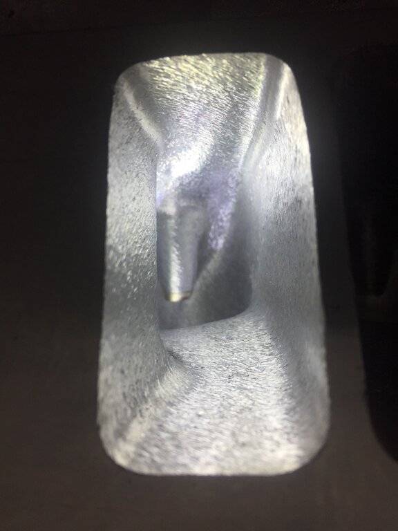

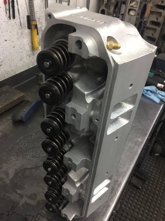

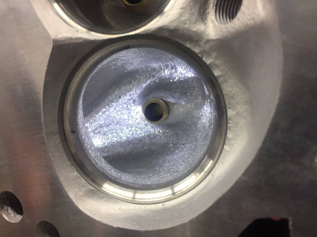

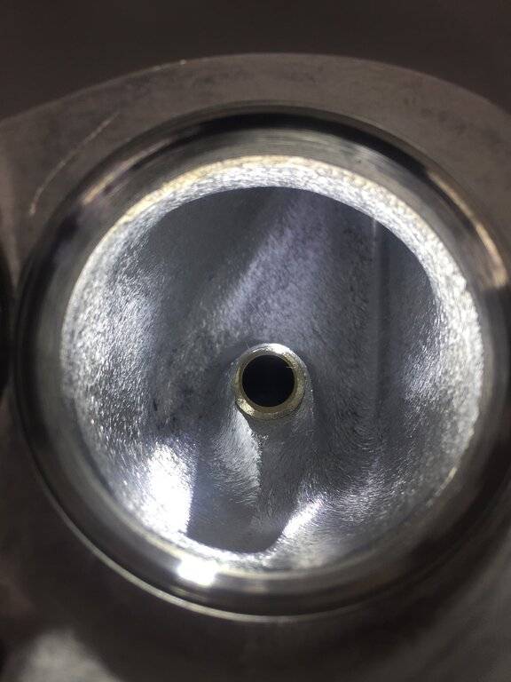

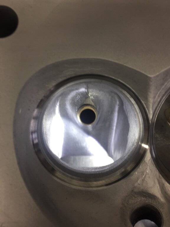

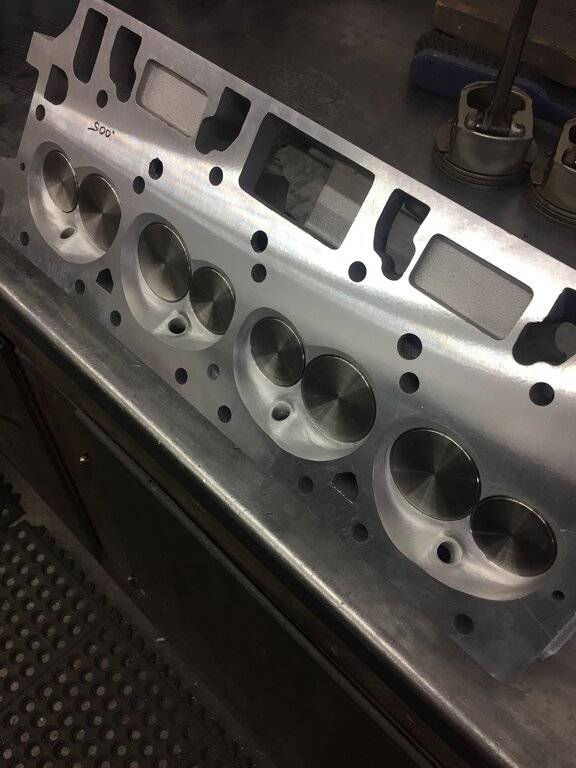

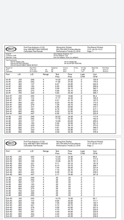

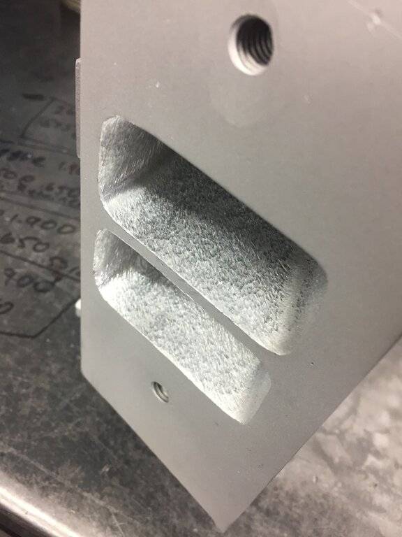

I had my standard port Indy SR heads ported to Max wedge size. Intake ports are quite a bit bigger. The guy did an awesome job. Will be going on a 543. I have a Super Victor and a 1250 dominator for it. Kim
Cool! I ran SR max wedge port heads on my 528. Made pretty good power. I liked them. I have since stepped up to B1MC heads.
