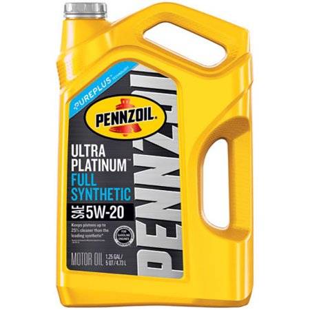

Isn't this the oil that Mopar uses in our vehicles for engine oil changes?

I think my owners manual says 5W20 for my 2018 5.7L.
The issue with the 5-30w oils was that under severe service conditions, such as pulling a trailer or high speed operation, the bearings were not being protected enough by the thin oil (not enough cushion). If you are not doing any severe applications, you probably can use the 5-30w, if the warranty specifies that oil.
Dave
