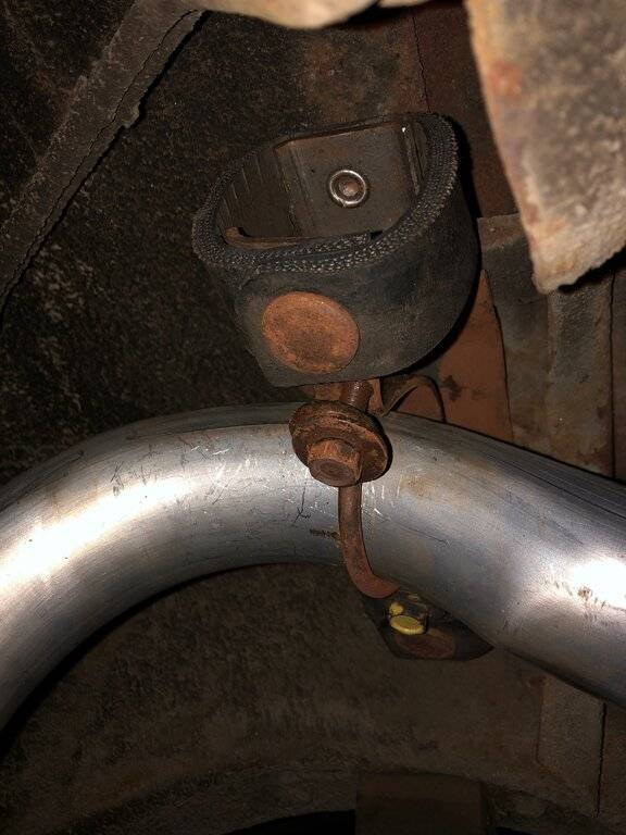

When driving Medina last month, I noticed an increasingly noisy rattle coming from the rear. Turns out that the noise started from a broken rearmost exhaust hanger. I brought the car to a local mechanic whom I know, as there was no chance for me to drive to Rockford and back before the Midwest show this Saturday (work comes first).
When the car was up on a lift, we found that the following issues had developed:
Luckily, @marty mopar had the correct part (P/N 3404844 ) -- so I bought one hanger for Medina and a spare just in case, as one of my other cars might need it (Marty had three hangers available, so there is one left at Arizona Parts if someone needs it). Here is Medina's exhaust this Friday afternoon, with the NOS hanger installed. Notice that it now runs parallel to the rail -- no more rattles! Notice also that as a result the exhaust was brought a bit rearward, with the scalloped tailpipe running perfectly in the continuation of the rear valence.

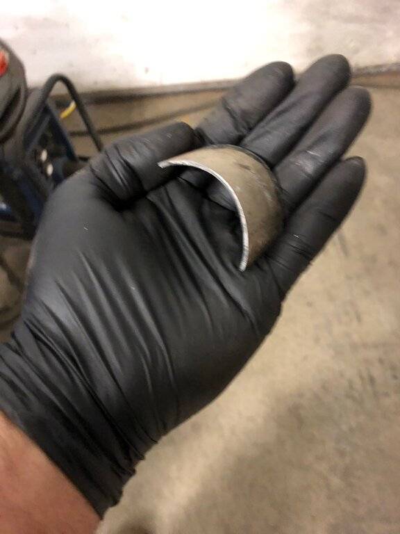

While fixing the rear hanger issue, it became apparent that another hanger was too loose and that its brackets could not be tightened enough, causing a second (smaller but still noticeable) rattle. So a piece of metal of appropriate thickness and curvature was cut to fit and was inserted between the hanger bracket and the pipe.

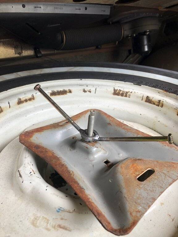

Voilà, no more rattle. Right? Well, not so fast. The butterfly nut holding the rear tire had gone missing. No idea why or when, but the tire occasionally rattled as a result. I had used a simple nut when I first noticed the issue in May, but it did not stay tight and there was still a tight rattle. Not having an original nut on hand, the mechanic manufactured a really cool one that I like so much I've decided it will stay with the car!

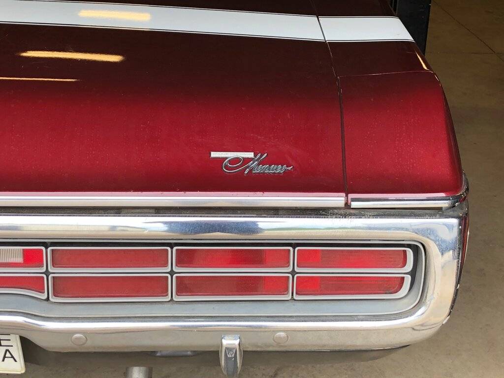

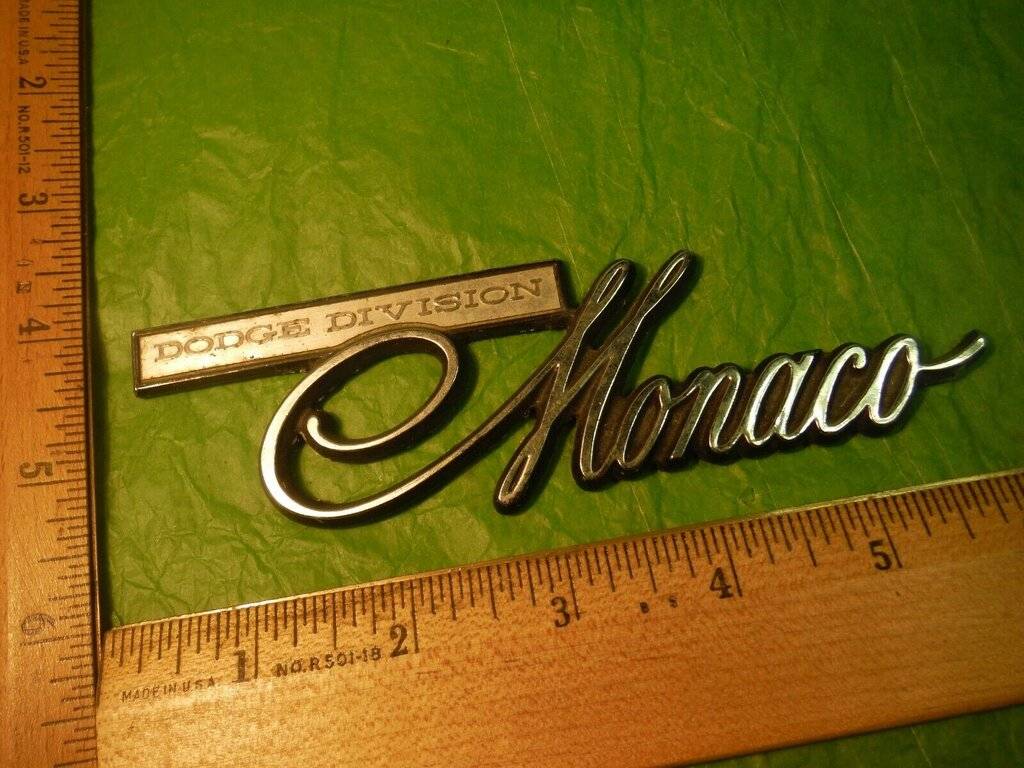

One more thing. When I bought Medina, she was missing the trunk "Dodge Division" badge (P/N 3570337 ). I found a used one in good condition on eBay, negotiated a good deal, and had it installed today after moving the remnants of the old double-sided tape.
We used old factory photos and a scaling software to figure the correct placement (3.5in from the trunk's right and bottom edges). Here it is on the car (using double-sided tape):

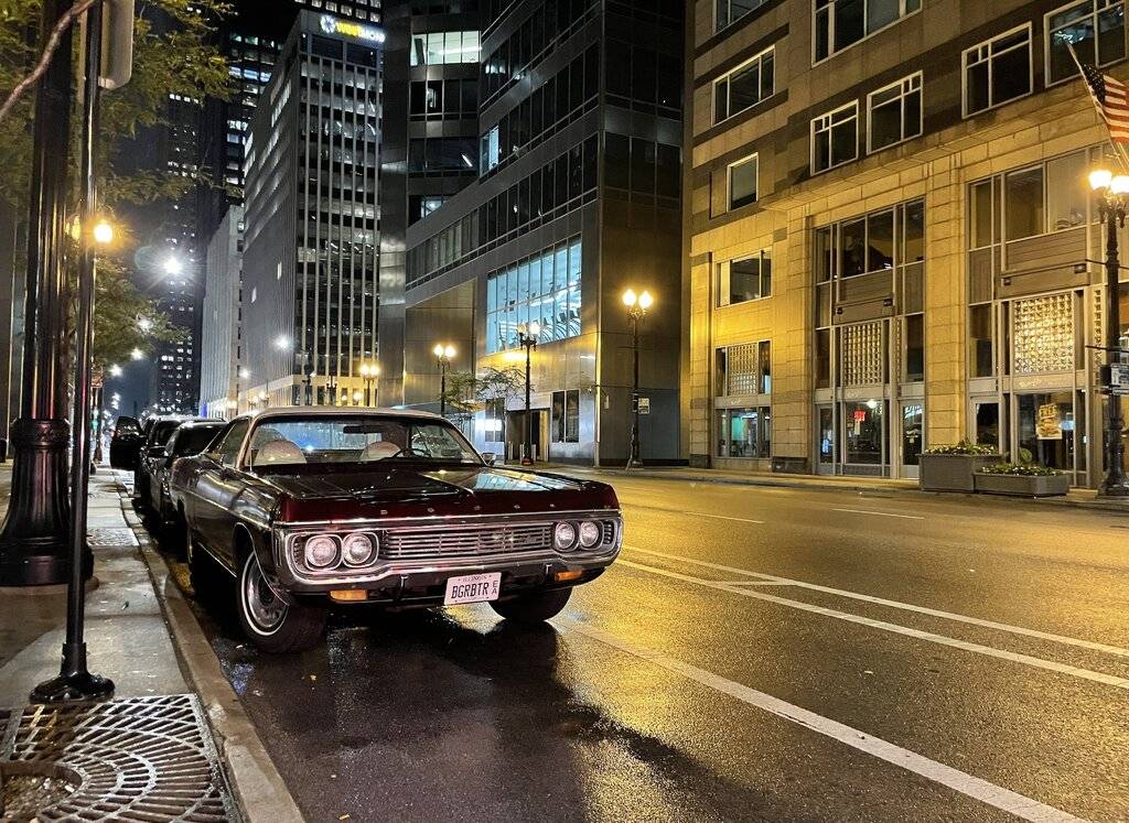

Your wish is my command. Medina has clocked over 640 miles in the past four days, getting me to car shows / meetings in four Midwestern cities. Here she is, parked on (and improving the appearance of) a Chicago business district street yesterday evening.
Yikes! Parked on a city street overnight! Looking good!
Fear not, Medina was super safe overnight (as I always keep her). The above photo was at dinner time. She was parked in a well lit area, directly under two video cameras, right in front of the restaurant entrance, and the two people at the front desk were in direct view of the Monaco. For extra precautions, I chatted with them to make sure that they were all aware of her. Given the ok weather, I thought this solution was actually better than risking a ding in one of the parking lots while I ate. The driver of the Mercedes parked right behind must have thought the same thing. Today marks Medina's return home (well, till I drive her to Carlisle next week).

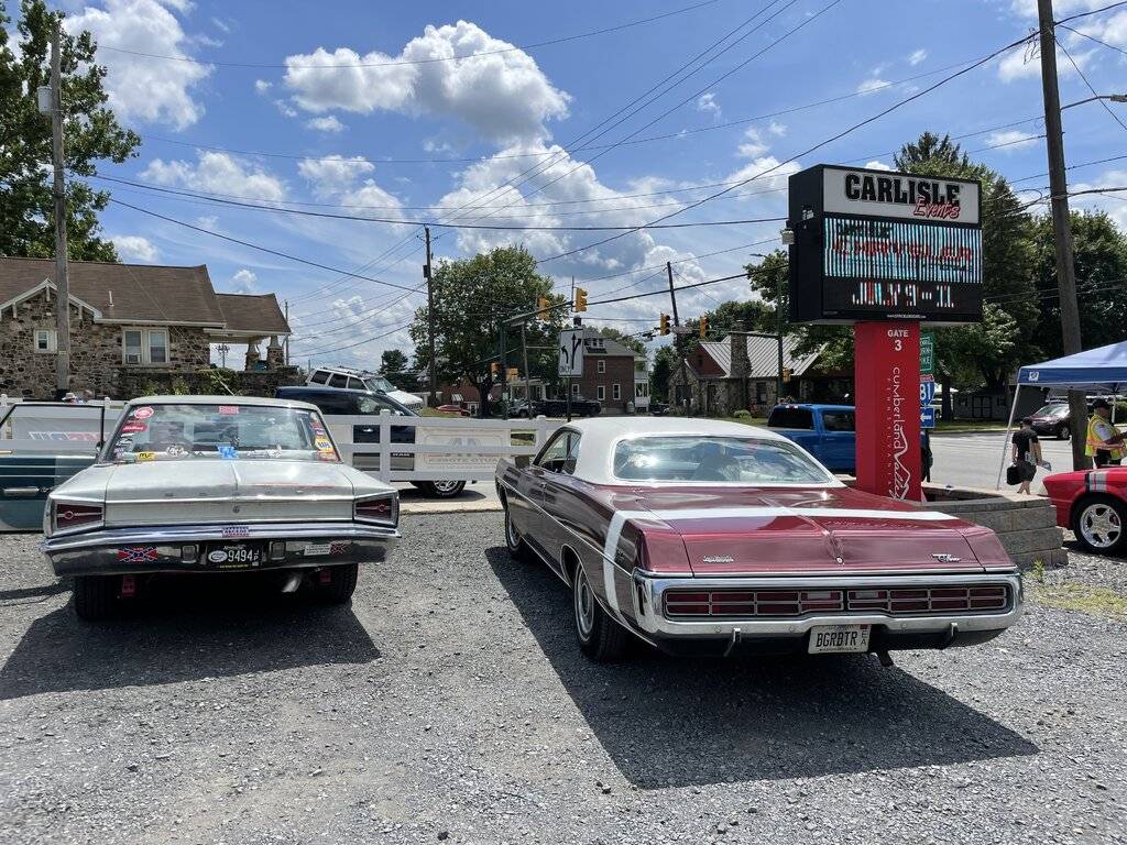

Here is a photo that I took right before I left Carlisle yesterday (ahead of schedule due to business to be taken care of, unfortunately). The white 1965 Polara 4dr to her left, which was parked in front of the admissions building, hails from Kentucky. @Ripinator might be able to provide some more background on that car.
