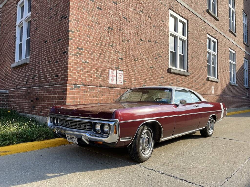

Enough talking, time for eye candy. Here is a photo that I took today.
It's looking good, with all the work you put in to get it where it is at drive it as often as you can

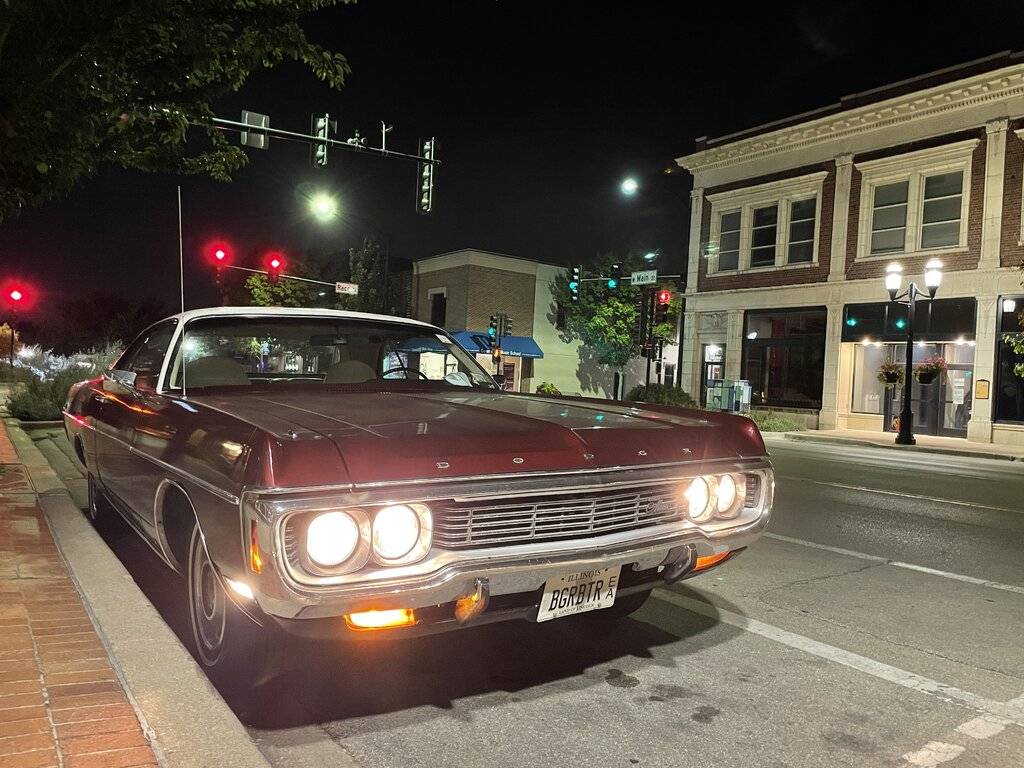

First is my Monaco on the night before the 2021 CATL Drive. There are plenty more pics of the car in the CATL thread.
