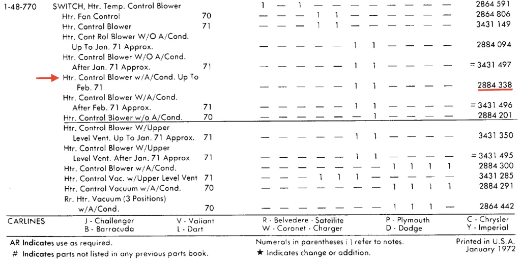

I have therefore gone hunting for the right switch. Medina's SBD was Nov. 16, 1970, so the correct switch is P/N 2884 338. It is the same part number as on the Fury from 1969 onward (@CanCritter noted that there are "a cpl variations of them 3502679 and 3431496 that supersede older switch's"). In fact, the 1970-1971 parts manual shows that the cutoff date for the change was Feb. 1971:

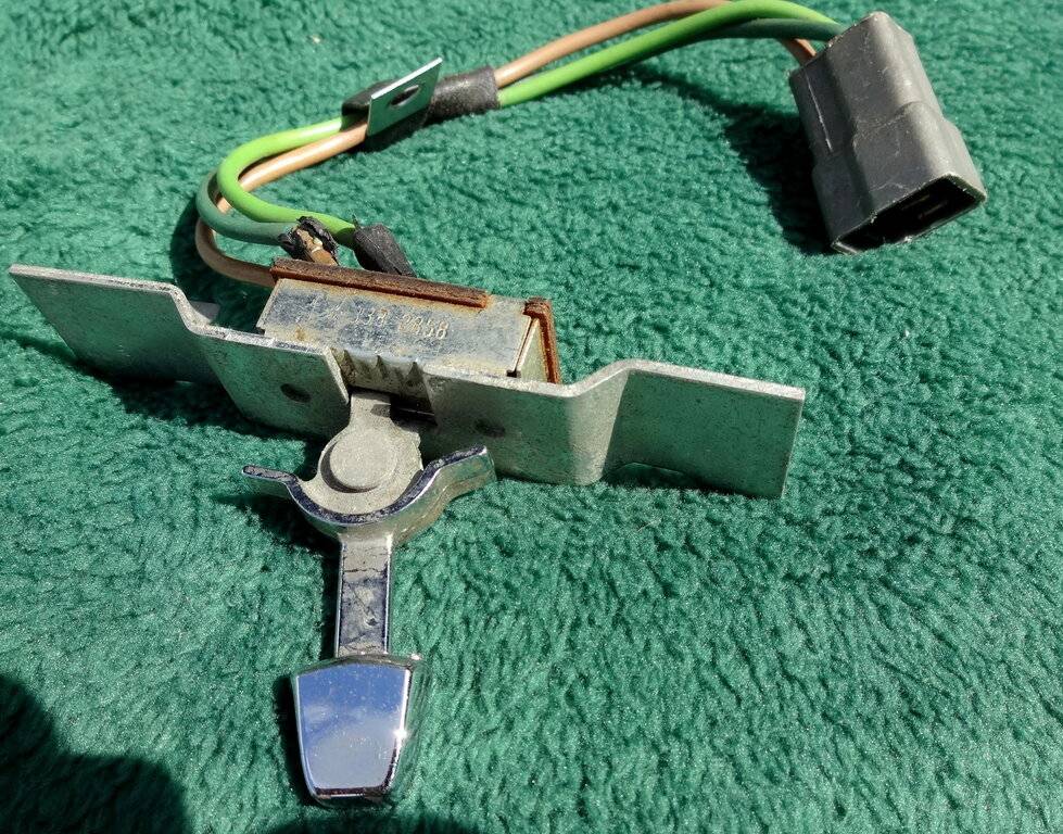

I have not seen P/N 3431 496 but I know that P/N 3502 679 does not look like Medina's switch (even though it supersedes P/N 2884 338). That is because 2884338 has a (kinda) triangular end (the part one's finger touches), as seen in this switch from a 1969 Fury:

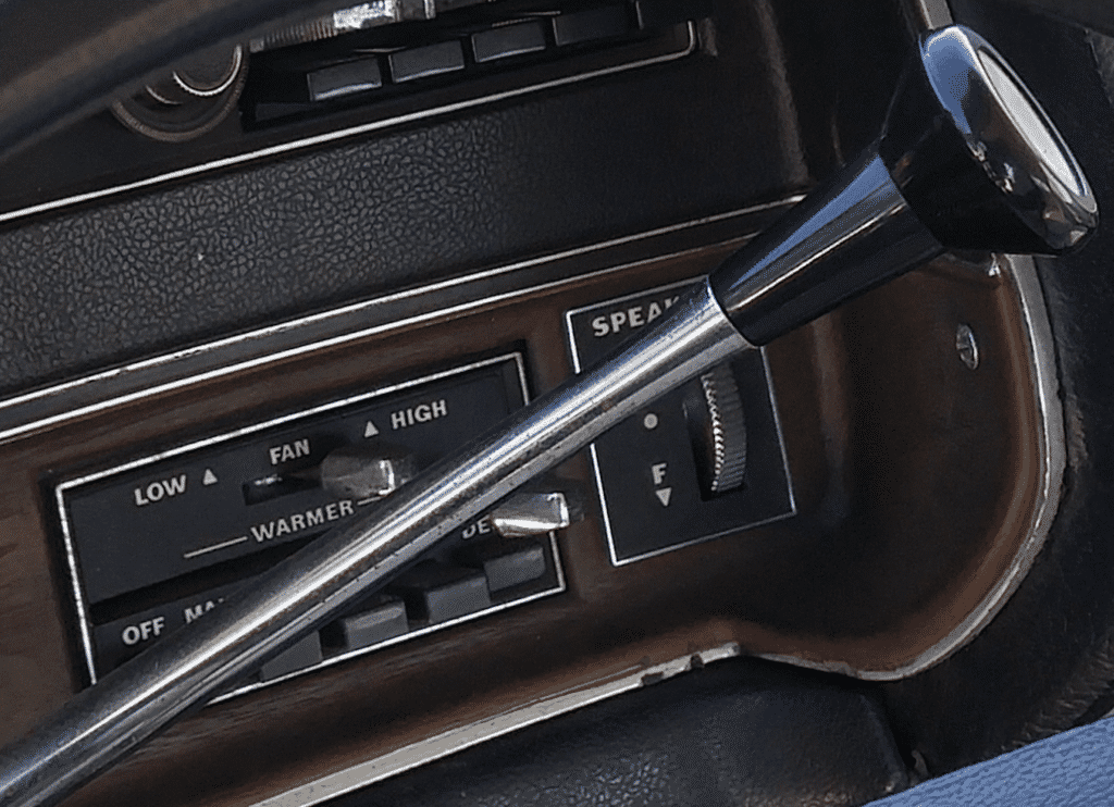

Here is Medina's original control panel and switch, for records:

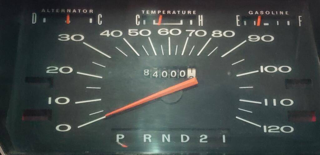

The weather has turned, spring is here, but unfortunately I am away for work and can’t enjoy driving Medina yet. @71Polara383 and I are big believers in exercising our cars, so he took her out to get some fresh 93 gas and stretch her legs. She passed 84k miles along the way
