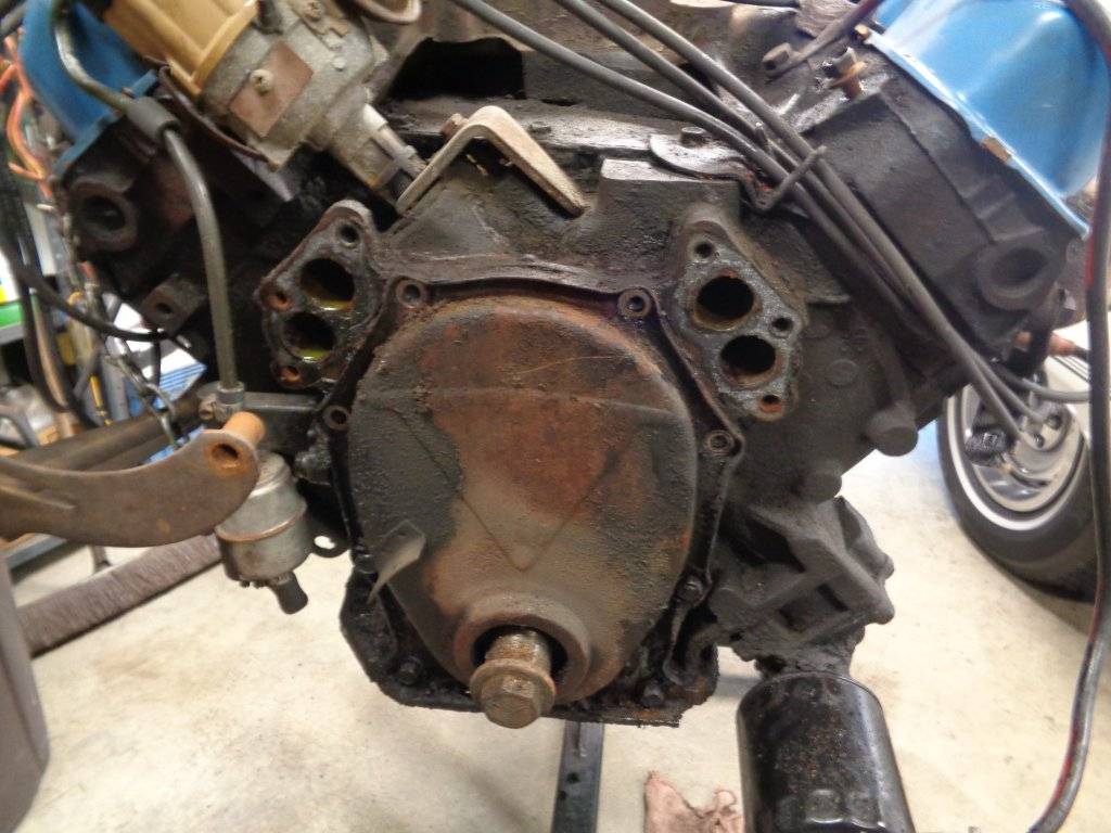

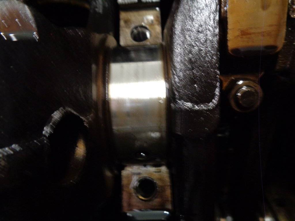

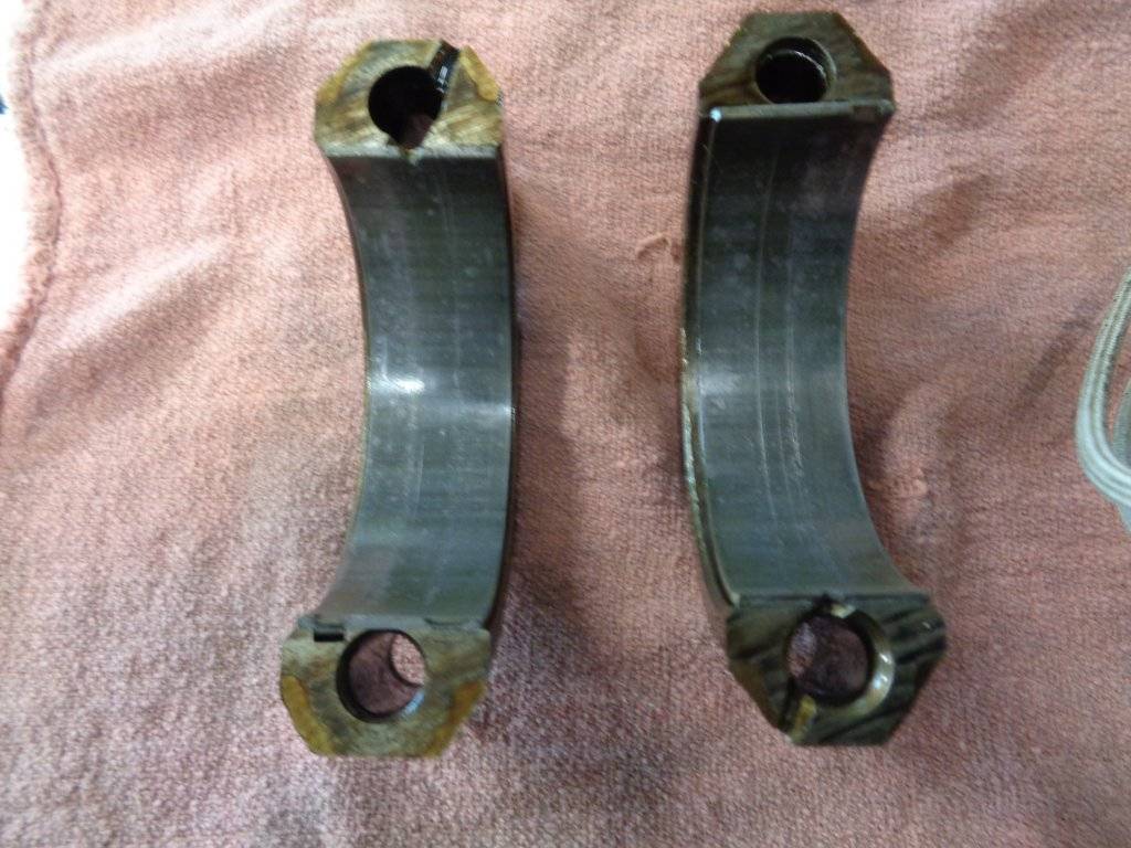

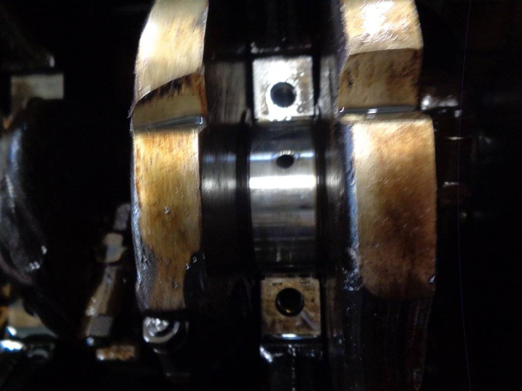

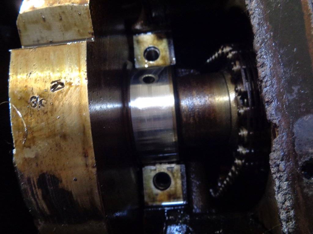

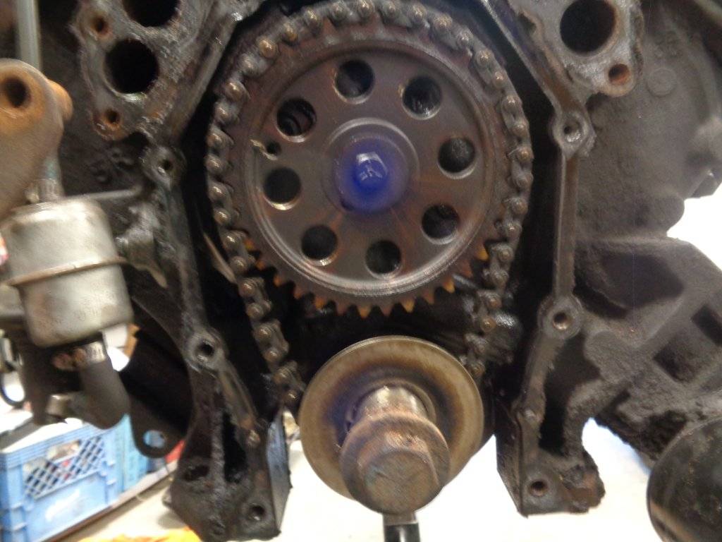

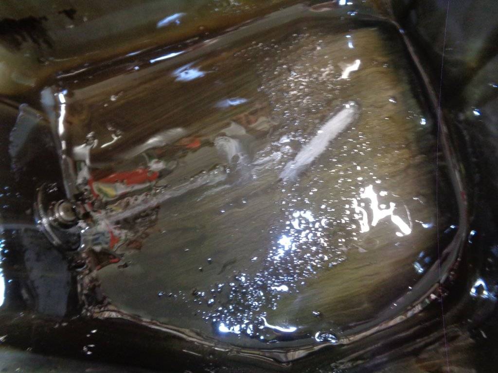

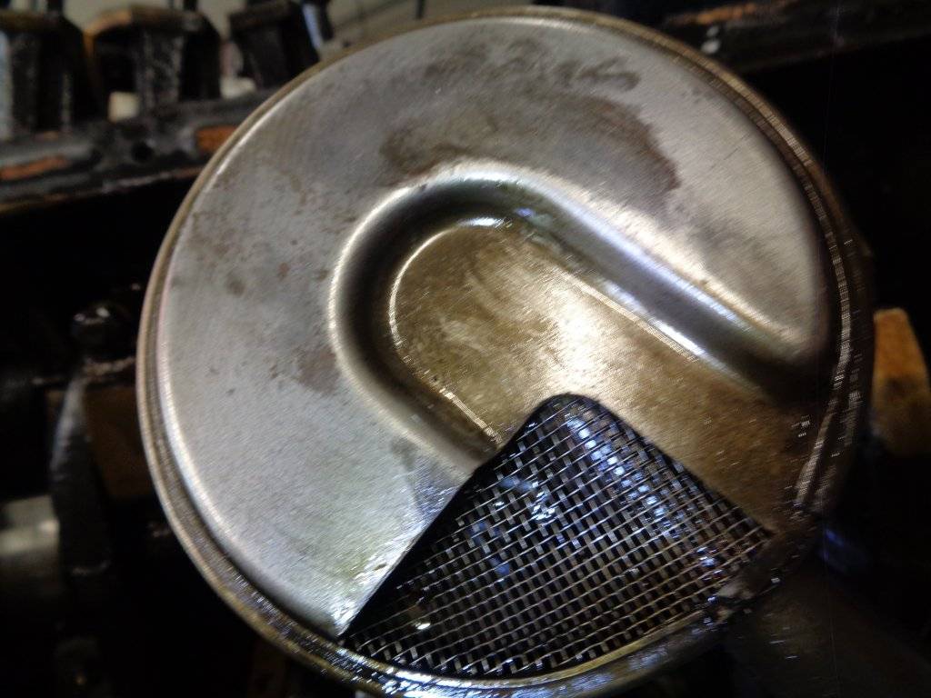

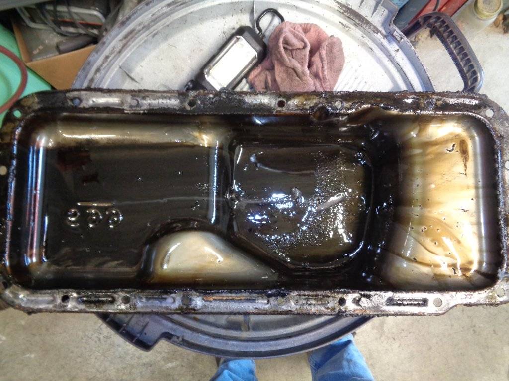

As previously posted in post #350 I had replaced two block freeze plugs. Michel and I had discussed in June before @sixpkrt 7th Annual C Body Show the necessity to replace the remaining freeze plugs at a later date. Other repairs would include a wheel alignment and correct the growing power steering leak. The power steering pump reservoir seal was the main culprit, the pump shaft seal was also changed as they were OEM original to the car and rock hard upon inspection. I had noticed an occasional oil light flicker on left hand turns. An oil pressure test was performed, and the results were not good. On cold start the press. was 45 psi at idle. fully warmed up after 20 minutes of highway driving revealed a idle pressure of 10-15 psi. Since I would have the engine out for freeze plug replacement, now would be a good time to pull the oil pan and check for a partially plugged oil pickup screen, debris in the oil pan. removal of the oil pan gave me quite a surprise, a heavy buildup of bearing material was found.

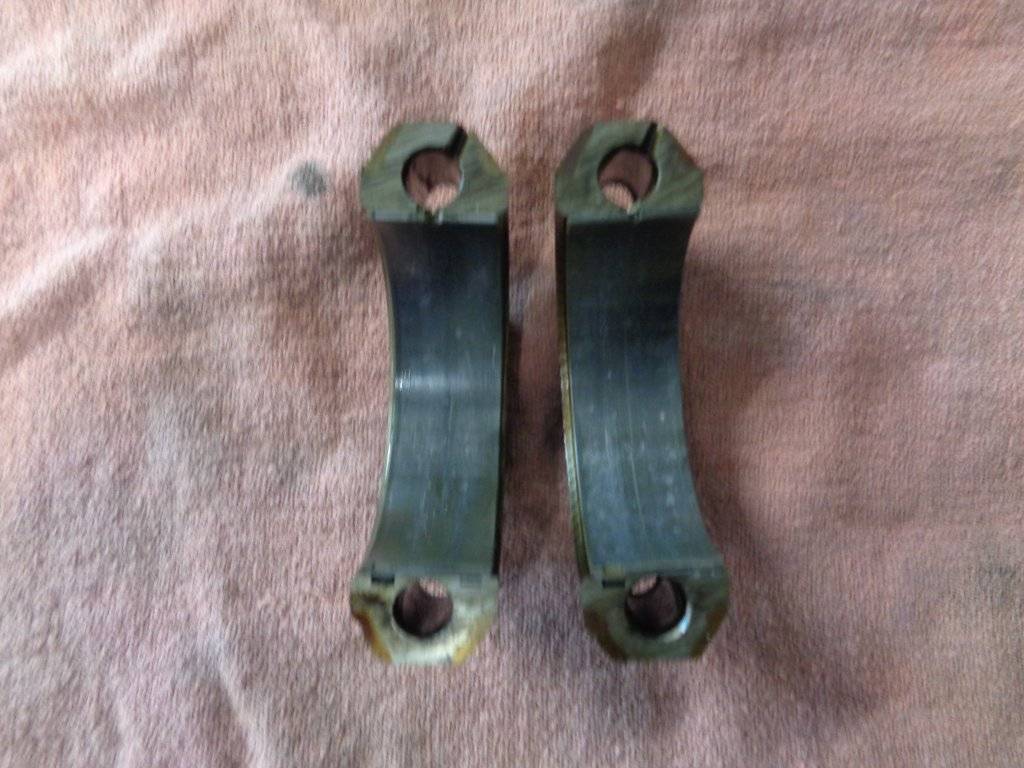

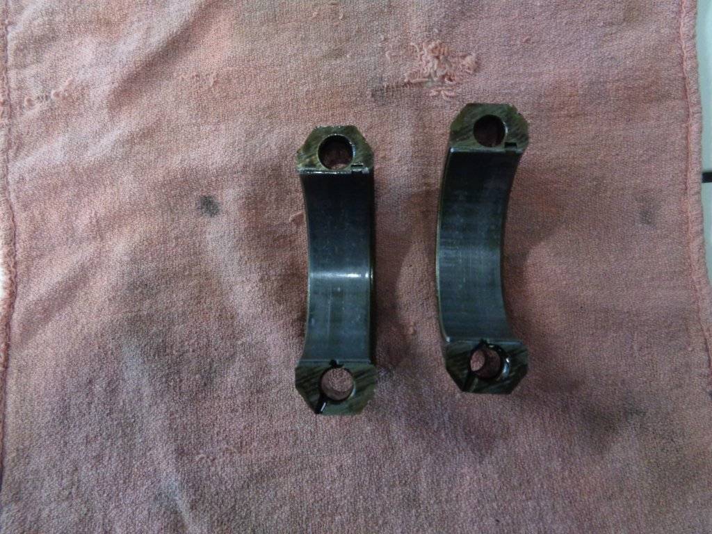

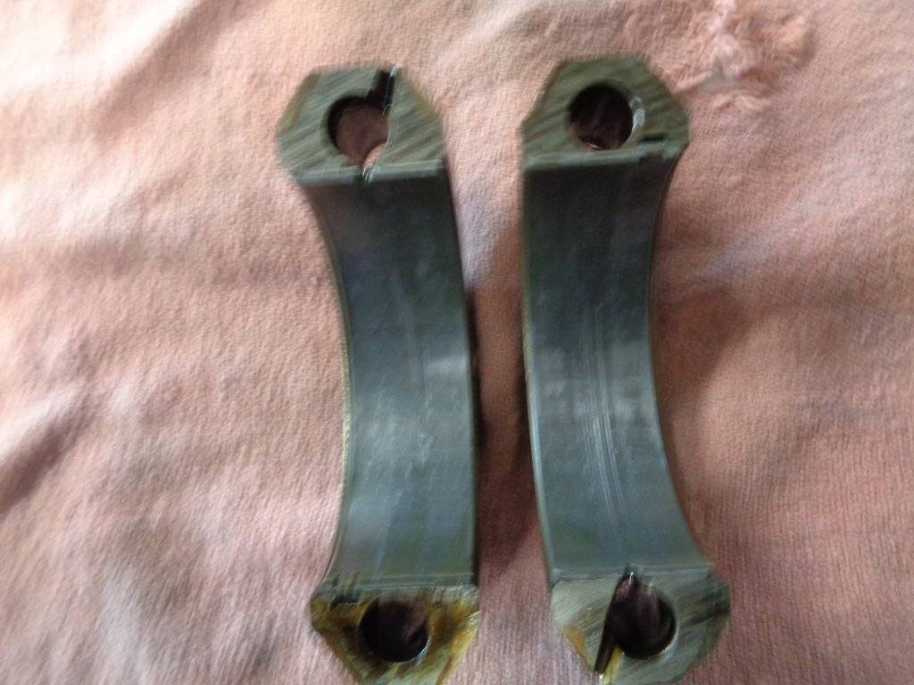

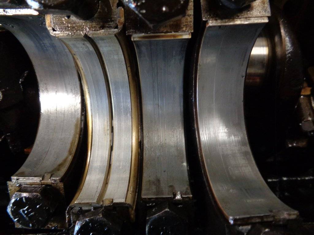

With that find I removed the main bearing caps to check bearing wear. To my surprise the main bearings although scratched and contaminated were in better shape than expected. The main bearing journals were in much better condition than expected. Crankshaft removal and measuring set for tomorrow.

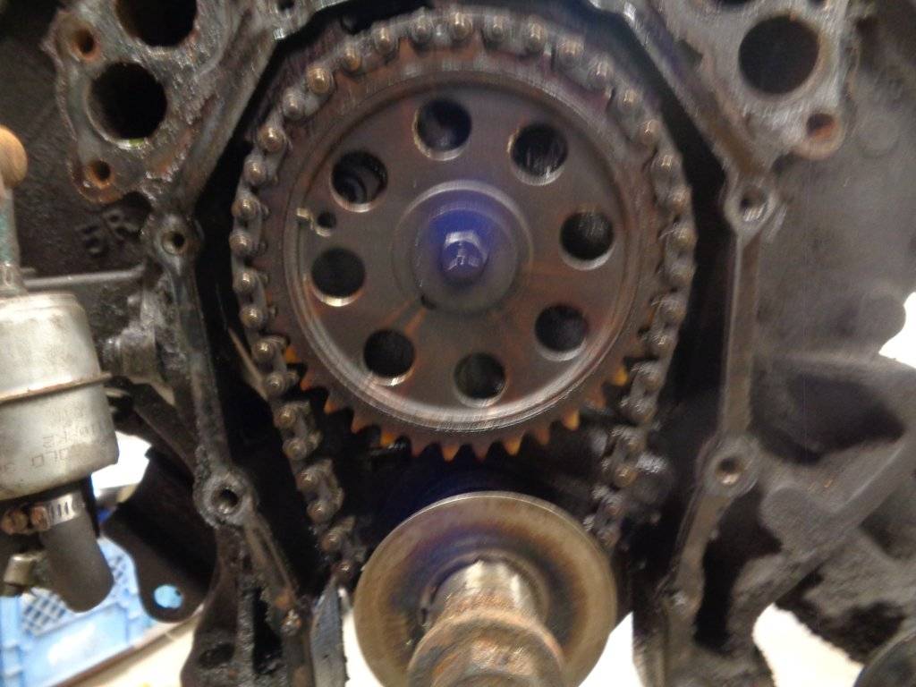

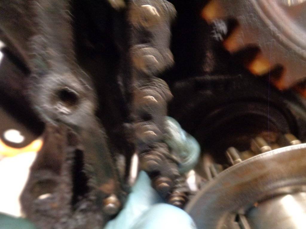

Pull all connecting rod caps and the rod bearings were very worn. several fell out of the rod caps. Since I could see the timing chains condition, I removed the water pump housing and the timing cover. The chain and gears were definitely OEM. Check the chain wear. Stay tuned more tomorrow.
