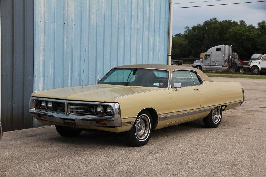

Meet Buttercup, a 1972 New Yorker Brougham 2-door Hardtop
Buttercup went to her first C-body show today: the 4th Midwest C-Body Show organized by @sixpkrt. Before heading out this morning, I posted a photo of her at Wyatt's shop together with her older cousins Medina and Elvira. Attached below is a photo that I took at the end of the afternoon, after putting one hundred or so miles on her clock going to and back from the Show (she's now just shy of 100,200 miles).

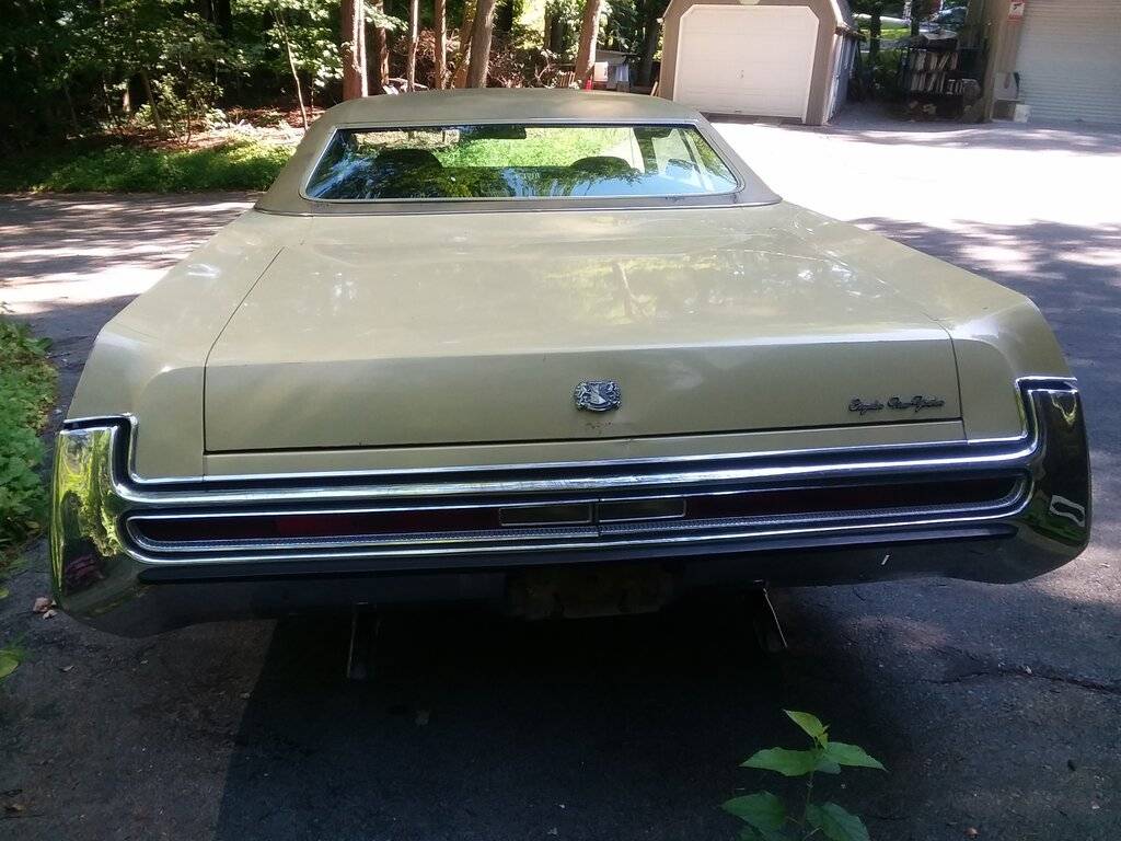

I found this beautiful GY4 Honeydew NYB with a gold top and black buckets on CL in Westtown, NY in mid-June and I managed to buy her before any sandbaggers got to it. Thanks to several members, in particular @coco , @Marv , @AussieFellaWithaCbody , @71Polara383 , and @saforwardlook for their help in this process!
This car was a 60th birthday gift to the seller by his son. The father, who just turned 90, stopped driving the car last year. He and/or his son used to drive the car every week, on "cruises" in NY/NJ/PA. That explains the 109k miles on the odometer, which is fine by me. There are some dings in the body panels because of what happened to the owner's ability to drive her in close spaces as he aged -- I guess that explains the bent front valence. Nothing major though.

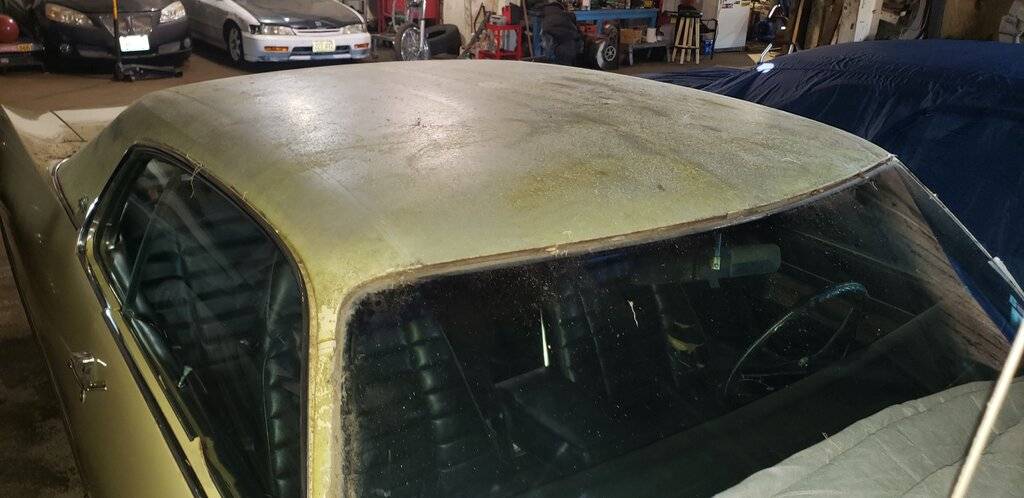

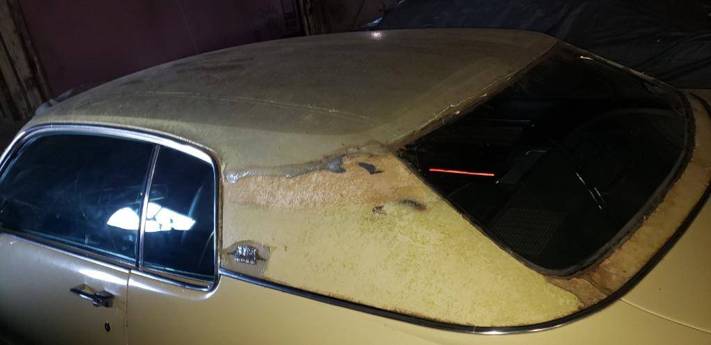

The car was stored in a carport after the son helped the father sell his place last year, and you can see the result on the roof -- the son told me that the tears in the vinyl were not there before, and that's when they decided to sell the car so that it would not deteriorate further. Mechanically, the seller's son said that there is an exhaust leak. The incorrect exhaust and road wheel caps were there when he bought the car for his dads in 1991, so I have no plans to change them in the short term.

Attached below are photos that the son's wife took this morning -- ain't she beautiful?
Beautiful! My father-in-law had a ‘73 New Yorker coupe the same color only with a white top - loved that car! Just didn’t have the cash at the time he parted with it.

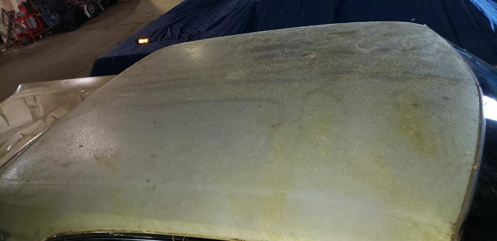

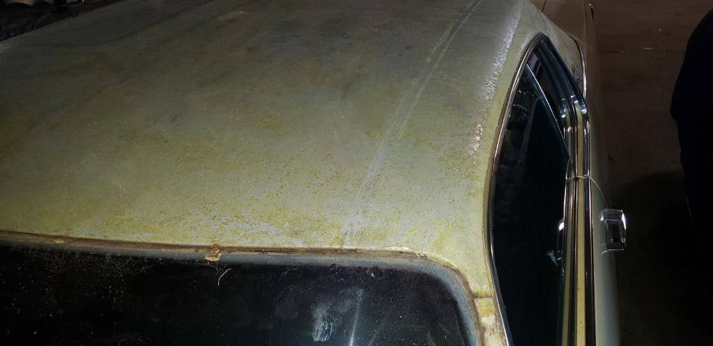

One of the projects that we have planned, is to replace the Vinyl top as it was worn and definitely needed to be replaced.
Today I removed the trim from around the windows, used a razor to cut close to the drip rail to see what we are working with underneath. It looks excellent, no major rust or corrosion. It even gave us a look at how they let the assembly line worker know what color top to install...

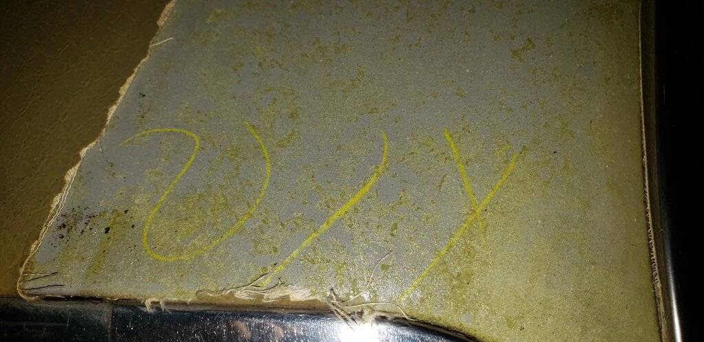

Now that everyone has seen Buttercup's V1Y tattoo, here's the issue with which I am grappling. My plan, going in, was to:
1. remove the vinyl top (since it was toast);
2. fix whatever rust Wyatt found underneath it;
3. paint the roof (possibly in white, likely in GY4);
4. and then -- after taking some photos of the painted top for posterity -- install the new vinyl top (for which, BTW, I still need to source a correct reproduction).
--> Here is the question: given that the roof metal under Buttercup's old top is pretty much spotless (except at the LHS bottom corner, due to leaves that rotted under the bright rear-window moldings), is step 3 (repainting the whole top, as opposed to just the rust area and the rear window surround) overkill or a good insurance? When in doubt, I'd go for the latter.
Comments welcome!

Fix the rust and paint the entire top.
I'm two years into a new vinyl top project that has yet to start, so great timing (waiting on SMS). So if you plan on sourcing a new top from them, you might be going around bald for a few years.....
@71Polara383 - how are the glass and drip rail trim removed?
So @ayilar you're thinking of going away from the butterscotch color?
Nope. The GY4/V1Y combination works very well. White would be nice too, but the original V1Y looks great to me and works well with the black interior.
The idea here is to protect the underside, just in case the car stays outside at some point. Unlikely, but I don't want to have to worry. By painting it GY4 underneath, my idea is to also take a photo of what the car would have looked like without a vinyl top.
leave it. Its not a outdoor car anymore.
Even if it sat outside...look how bad the whole roof rusted in the 48 years its been like this...oh wait it held up perfectly with the exception of the one corner that trapped dirt/moisture.
The drip rail trim is riveted. I am not looking forward to removing it.
The glass trim is pretty simple, just have to be careful and you can't pry it up thats when you will start hurting the trim.
I'm not one to leave any surface unpainted or unprotected, I'd paint it. If you are having the whole car done, then leave the V-top for the very last. I would, however, ask the trim shop if there is any drawback to having the roof painted with the type of adhesives they use, that might help you make a decision.
Thats IF it sat outside at all which is unlikely
Starting in 1990, when the previous owner acquired the car (precisely, when his stepson bought it for him as a 60th bday gift), the car was kept inside. In the last year, however, it was kept outside under a carport -- and it is very obvious, from the slight surface rust at the edge of the fender signal repeaters and from the deterioration of the vinyl top itself, that it does not take too much to get some deterioration on those cars. That is why I am seriously considering a repaint of the top -- the rest of the car has a nice patina, but the top needs fixed and my thinking is I might as well do it "forever" (not just for the next 20 years), i.e., paint + vinyl on top of the paint.
Starting in 1990, when the previous owner acquired the car (precisely, when his stepson bought it for him as a 60th bday gift), the car was kept inside. In the last year, however, it was kept outside under a carport -- and it is very obvious, from the slight surface rust on at the edge of the fender signal repeaters and from the deterioration of the vinyl top itself, that it does not take too much to get some deterioration. That is why I am seriously considering a repaint of the top -- the rest of the car has a nice patina, but the top needs fixed and my thinking is I might as well do it "forever" (not just for the next 20 years).
Then if thats what you wanna do there is no question is there...
On a complete restoration I always painted the entire roof even on a vinyl top car. If you're painting the whole car I'd paint the roof too. Another quart of paint and a little extra prep time is no big deal. If you're not painting the whole car I'd fix the small spots and epoxy primer it and call it good.
My thoughts exactly. If it was getting a full repaint...absolutely.
